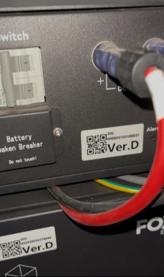

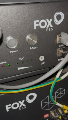

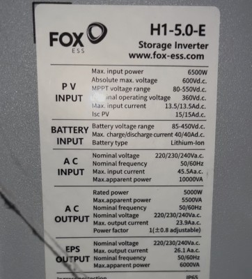

I’ve been under the assumption that my set up was 6kw, apparently the solar panels are but by the look of these pics I have a H1 5.0 E which I gather isn’t a G2 version
And my batteries look like they’re v1 too

No it's not a G2 you can tell from the max battery volts (450V) - the G2 is 480V
The batteries I can see are V1 which show as Ver C or DC - if you are going to sell them, put them on eBay and post over on the facebook group https://www.facebook.com/groups/foxessownersgroup with a link to them I don't think you'll have much trouble moving them on.

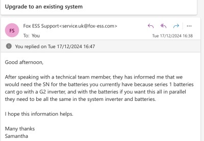

Just had reply from FoxESS, they’re saying hv2600 v1 version D won’t work with G2?Dave Foster wrote: Tue Dec 17, 2024 1:15 pm Yes that would work, the batteries just have to be similar in total capacity

Oh boy you can’t make it up, the HV V1’s absolutely do work with the G2 inverter - there are hundreds of systems out there with V1’s and mixed V1/V2 packs.
On running in parallel that sounds like a lazy answer - if both inverters have similarly spec’d battery stacks it will work, it will work even if they are slightly different i’ve seen that working on a system in South Africa (also see attached from Will) - It’s possible Fox have changed guidance because of issues in the field - obviously you don’t want to breach warranty but I would definitely get that confirmed in writing.
