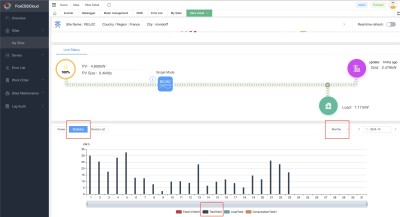

In the site's Statistics page, charts for Days, Months and Years have only the data from the Total Yield metrics, but nothing else (Feed-in, load, consumption).
Is that expected, or there's something wrongly set up by the company who sold the hardware and service to me?

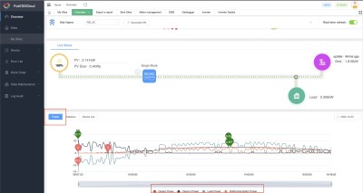

All the data are available on the Power page, for any given day, today or in the past:
That means the historic data is available. Why is it not shown on all pages?

Missing statistics monthly and annual chart
- Posts: 1501
The statistics you have mentioned don't get populated for inverters that are not hybrids with energy storage - i'm not entirely sure why, but that comes direct from Fox themselves.
