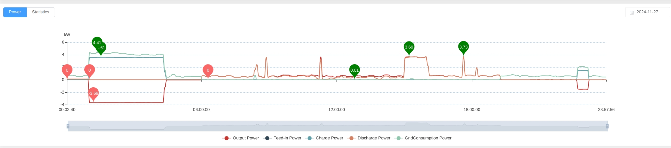

Example yesterday:
Charging started: 00:57am @ 3.6kW
Charging stopped: 04:27am.
Grid consumption stopped: 06:01am
Total energy stored within the battery: 3.5h * 3.6kW = 12.6kW
Battery consumption started at around 6am then...
Now the idle consumption throughout a day is 700W (it's mostly 500-600 but spikes to 800 so let's say average 700W)
Counting spikes (and really rounding it up) throughout a day:
08:17-08:32 - 2.4kW - kettle
08:47-08:57 - 3.6kW - kettle
11:12-11:22 - 3.6kW - kettle
14:57-16:07 - 3.6kW - hot water cylinder (1h at full power)
17:32-17:42 - 3.6kW - kettle
18:07-18:17 - 2kW - no idea
19:17 - battery discharged to 15% - grid consumption started...
So let's summarise:
Between 04:30 and 19:17 I have used ALL of the energy stored...
17920Wh theoretical capacity at SOH 100%
SOH is 95% at the moment - so max capacity is 17920 * 0.95 = 17024Wh
Min discharge level is set to 15% - so 17024 * 0.15 = 2553Wh
So usable energy capacity is 17024 - 2553 = 14.471kWh (theoretical)
Now let's sum up the usage between end of charging and depletion to 15%:
19:17 - 06:00 = 13 hours and 17 minutes - let's round - 13h at 0.7kWh = 9.1kW
then the spikes:
10 minutes at 2.4kW = 0.4kW
10 minutes at 3.6kW times 4 = 2.4kW
10 minutes at 2.0kW = 0.3kW
that's total of 3.1kW
Total consumption of 12.2kW MAX (and it is heavily rounded up).
So, I'm missing a couple of kWh here and that doesn't take into account the production from solar 1.3kWh for this day that usually just tops up battery anyway.
Data export from essfoxcloud for this day:
PV yield(kWh) 1.29999999999927
Charge energy(kWh) 10.7000000000003
Export energy(kWh) 0
Import energy(kWh) 19.1999999999998
Load consumption(kWh) 17.8999999999996
AC output energy(kWh) 12
Discharge energy(kWh) 12.9000000000001

Interestingly your Fox cloud stats say that your discharged 12.9kWh in the day which is close to your calculation of 12.2kWh you calculated - so that would appear to be correct.
Fox says your charge energy for the day was 10.7kWh and your batteries were charging for 3.5 hours at 3.6kW so without taking losses into account that's 12.6kWH - but your charge power is automatically reduced by the BMS when it passes 94% to approx 1kW (this would be the last 30 minutes of the charge cycle) - so 2.5 * 3.6kW (+1kW) = 10 kWh which is there or there about what Fox cloud says so that also stacks up.
In effect this appears to be a capacity issue as you appear to be getting 12.9kWh between 100% and 15% whereas you would expect on brand new batteries ~15.2kWh as they are with a 95% SOH ~ 14.5kWh.
