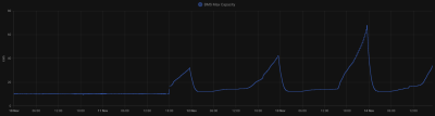

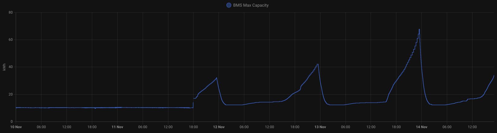

On 11th November, the firmware for my H1-5.0 inverter and BMS/batteries was updated. Since then, the battery capacity estimation from the BMS has been all over the place.
I have 5x HV2600 V2 batteries and prior to the upgrade, my estimated max capacity was ~10.25 kWh. As seen from this graph, after the update the max capacity is completely wrong, with estimations as high as 67.67 kWh.

Will wrote: Thu Nov 14, 2024 6:03 pm What integration are you using? the modbus addresses have completely changed in newer firmwares
I'm using the latest version of https://github.com/nathanmarlor/foxess_modbus.
To calculate max capacity I'm just doing:
Code: Select all
sensor.bms_kwh_remaining / sensor.battery_soc * 100
Will
Posts: 404
I'm not sure thats correct any more. On newer firmware sensor.bmw_kwh_remaining shows the capacity and not the remaining.
See https://github.com/nathanmarlor/foxess_ ... issues/651 for more info.
2 x KH Series Inverters
andrewmoore
Posts: 9
Joined: Tue Oct 17, 2023 2:01 pm
Will wrote: Thu Nov 14, 2024 6:17 pm I'm not sure thats correct any more. On newer firmware sensor.bmw_kwh_remaining shows the capacity and not the remaining.
Oh, interesting! That's the issue with making such a big jump in firmware, easier to lose track of big changes.
That explains a lot. Thanks for the info.
