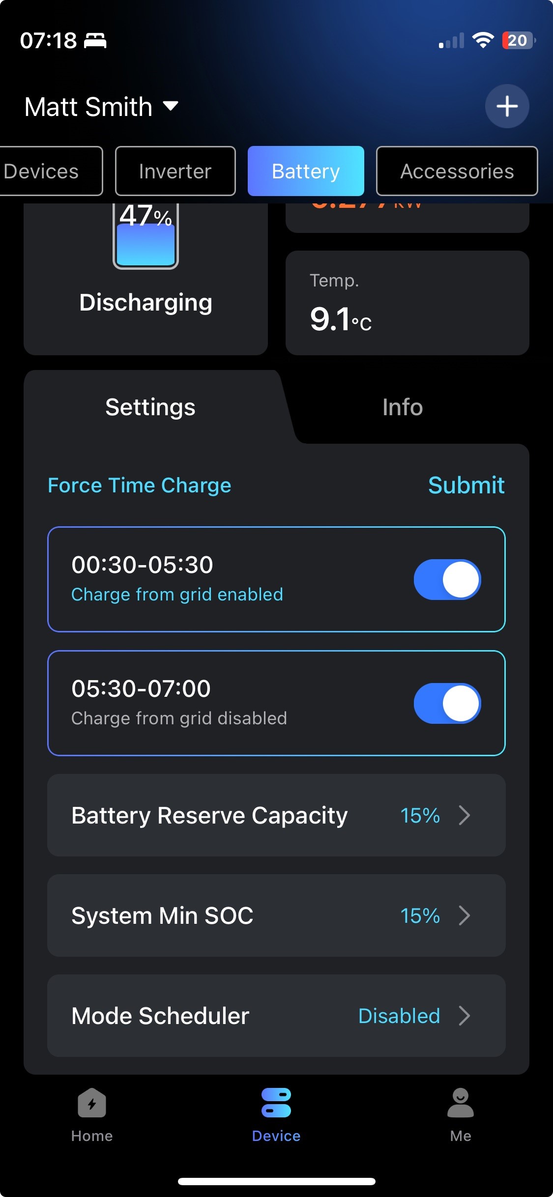

Thanks for your reply. I have tried to set a time period and leave the charge from grid switch disabled, and this seemed to work but there was still a slight discharge - it was not a complete battery backout that I was hoping for.

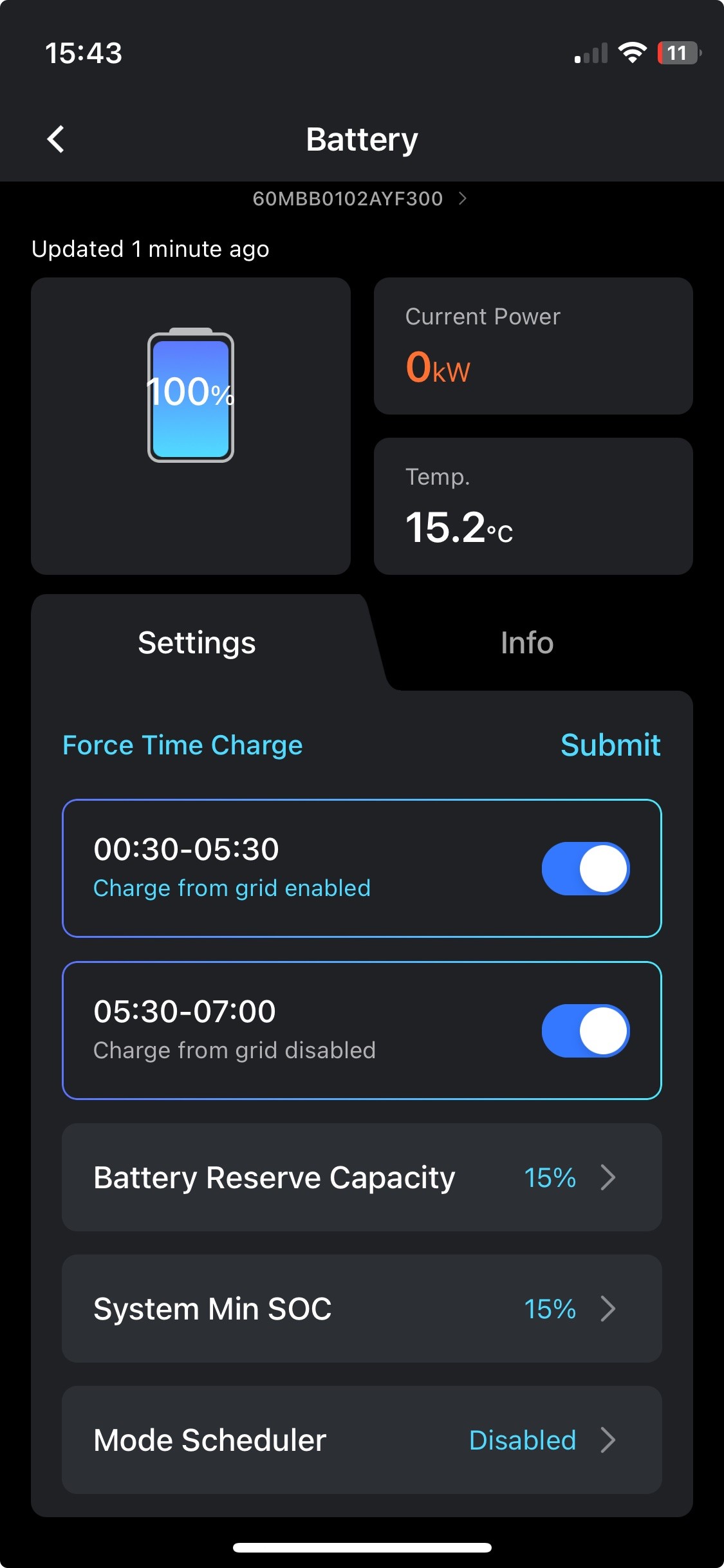

I am attaching a screen shot, in which I use both the time periods. do you think that my settings should between
00:30 and 05:30 allow the battery to charge from grid, and then between 05:30 and 07:00 run 100% of my house load from the grid.
Posts: 1297
Yes even when the battery isn’t being used to power the load, a small amount of power will be used to keep the inverter from going into standby (it doesn’t take this from grid) - usually between 30 and 70 watts but a fairly low drain.
I’m assuming you are on an eco tariff from 00:30 to 07:00? - if you want to charge your batteries to 100% and not use them to power the house, the best option is to set a single charge period to cover that entire period with charge from grid enabled.
When the battery hits 100% it will stop charging, but it also won’t discharge either and your house load will be powered from grid - leaving you at 7am with a full battery.
