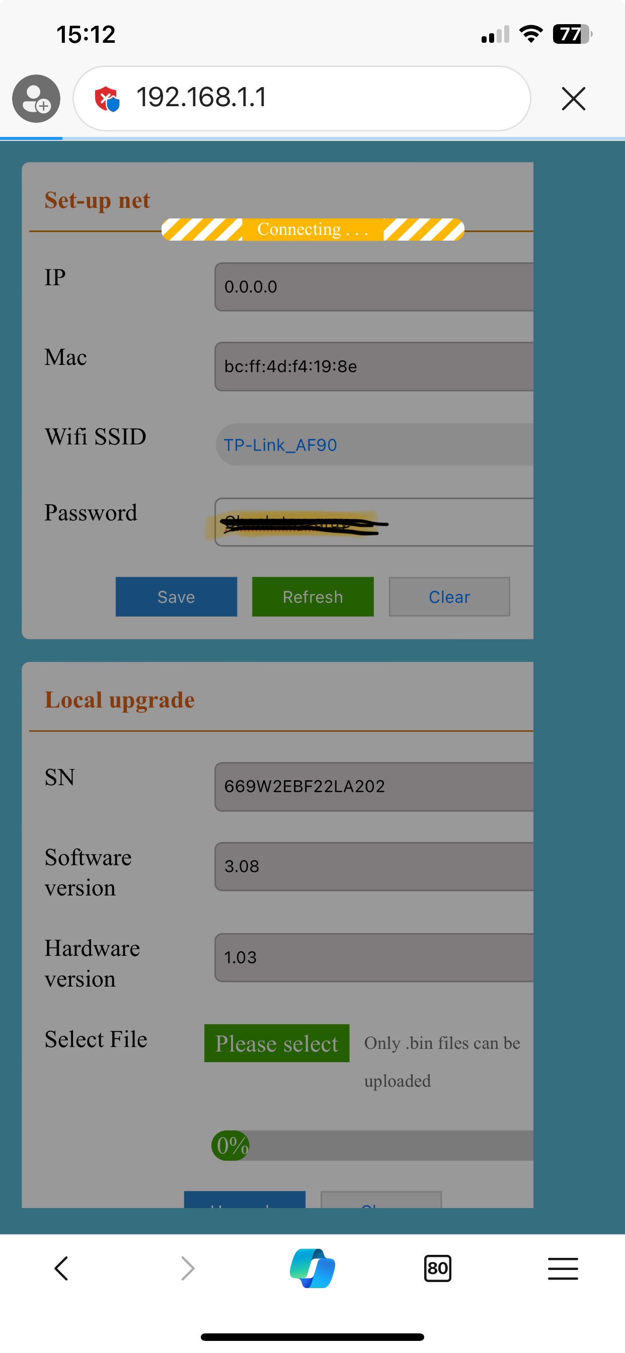

Posts: 5
Joined: Wed Dec 13, 2023 8:41 pm
I'm still having these problems after the maintenance at the weekend.
The foxess wifi dongle is flashing red very rapidly, so after searching here I've tried to shut and reboot the inverter - hoping to reset the dongle. But its not worked. I've tried twice now.
I can just about log into the wifi dongle, but I can't save a password - it keeps coming back blank so I'm not sure if its storing it or just hidden?
The IP and Mac address's in the manual are very different to those show in the set up manuals - and I can't see it connected to the home wifi.
Any help much appreciated.

Posts: 5
But my system won’t let me save the house wifi password. It just times out, every time. Tried two full system resets.Dave Foster wrote: ↑Sat Dec 16, 2023 3:01 pmThe blue light on the inverter is actually there to say the inverter is connected to it's battery (I know it's a terrible icon and doesn't make sense but that's what it is).Solar_19 wrote: ↑Sat Dec 16, 2023 2:17 pm I am having the same problem as so many other people. The system is healthy with the Green Light and Blue WiFi indication on the inverter on steady.

Have you tried using a different device to set it, when I use my mobile it alaways disconnects from the dongle and re-connects to the normal house wifi because it knows it has an internet connection, I never have understood why - but using my tablet it seems to stay connected and allows it to save the password.Bridgemang wrote: ↑Mon Dec 18, 2023 6:50 pm But my system won’t let me save the house wifi password. It just times out, every time. Tried two full system resets.
Posts: 5
Thanks.Dave Foster wrote: ↑Mon Dec 18, 2023 7:18 pmHave you tried using a different device to set it, when I use my mobile it alaways disconnects from the dongle and re-connects to the normal house wifi because it knows it has an internet connection, I never have understood why - but using my tablet it seems to stay connected and allows it to save the password.Bridgemang wrote: ↑Mon Dec 18, 2023 6:50 pm But my system won’t let me save the house wifi password. It just times out, every time. Tried two full system resets.
But it seems to make no difference. iPhone, iPad, Samsung, Mac book, Lenovo laptop. I’m trying all different browsers too.
After resetting the dongle (unplug), I can get to 192.168.1.1, but as soon as I try and save the password it completely freezes up. Either replying with Failed, or connecting, but then after that I can’t connect to the dongles http page.
Do the IP and MAC addresses matter?

Posts: 1887
The IP / MAC addresses shouldn’t matter at all, the only thing i’ve heard is that it has trouble connecting to some routers that have twin bands 2.4ghz & 5ghz that share the same SSID name. I’ve never seen that myself but turning off the 5ghz band and allowing the dongle connect only to the 2.4ghz band has apparently worked.Bridgemang wrote: ↑Tue Dec 19, 2023 9:59 am Thanks.

I’ve kept mine simple by installing a wireless extender in the garage with a different ssid and only the 2.4ghz band enabled that way it never gets confused.
It could still be a faulty dongle i’ve only heard of one going faulty before and that one was repeatedly disconnecting/reconnecting from the wifi which ‘could’ be what is happening here if you aren’t able to get get it’s own web page up afterwards.
Have a try with just 2.4ghz band enabled, failing that you really could do with another dongle to prove the connection is ok.
It’s a pain if your installer isn’t responding, they should do this for you - Foxess will likely say it’s for your installer to fix this under warranty.
Depending on how you feel the dongle is around £30 to purchase so if you continue to get no joy with your installer you could either contact Foxess service for their advice, or buy another dongle and take it up with them afterwards.

Ah Dave. This is brilliant. Nearly solved it.
So yes, both 2.4 and 5 GHz WiFi have the same name. If I turn off the 5GHz WiFi, then the foxess dongle works fine. Password updated, and the app goes back on line.
But as soon as I turn on the 5GHz WiFi, it stops working again and the red light goes to flashing quickly again. The system has been installed for 18 months and we’ve not had this problem before.
So I could rename the two WiFi frequencies - that’s tomorrow’s job. But it looks like the dongle has gone faulty as you say.

Great, your getting thereBridgemang wrote: ↑Tue Dec 19, 2023 4:29 pm Ah Dave. This is brilliant. Nearly solved it.
Huge thanks
Grant
I was told if they have seperate ssid’s like ‘myssid_24g’ and ‘myssid_50g’ and you connect the dongle to the 24g network it should settle down and work fine, good luck
