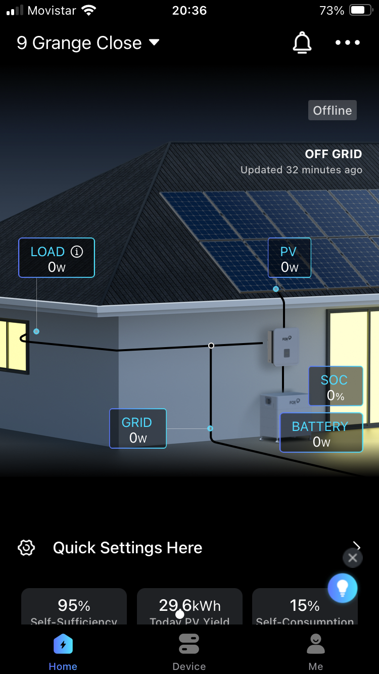

Hello. The timing was not ideal but we went away on a pre-booked holiday 5 days after the installation on September 9th. I’ve been looking at the app while we’re away and I don’t understand what appears to be going on with the system.
The screenshot below shows zero PV output (it being dark) and zero load (house being unoccupied) but electricity being exported! I assume this is coming from the battery?
If I was being paid for it, I suppose it could be a feasible option during a holiday, say, but I’m not set up yet for paid export, and anyway it's not an option I consciously chose or would choose.
Advice would be welcome, preferably in layman’s terms as I am not at all clued up on solar energy yet, although I want to be. 🙂

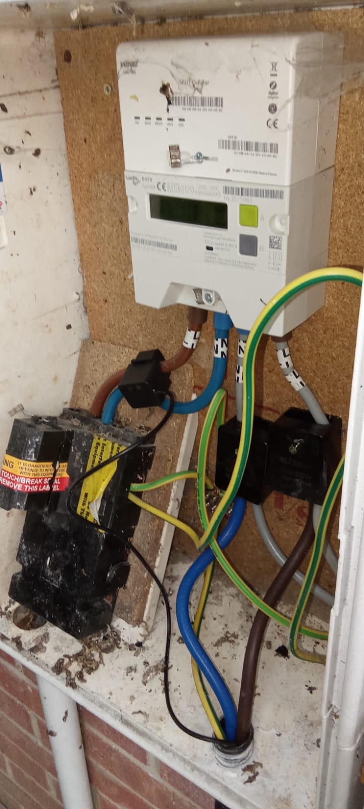

I’ve attached a couple of images that show the CT clamp - which should be fitted on the live output of the smart meter - if you have an EV charger it might be a bit more complex as it usually splits here to power the house consumer and the EV consumer unit.
If your son can locate the CT clamp in the meter cupboard, it needs to be unclipped (just prise open the tab) and it will open - it has an arrow on it so you can see it’s orientation and it needs to be flipped through 180 degrees and clamp it tight again.
The app should then show your load as a positive figure (probably not much as you’re away) if there is no PV and there is charge in the battery it will be used to power the house, if there is PV generation you should see the battery charging.
If there’’s any doubt if he could take a picture of where the CT clamp is and a wider shot so I can see all the cables in the meter cupboard I should be able to advise from there.

Hello again. I’ve attached the pictures sent by my son. The arrow wasn’t very clear so they edited the shot. Apparently there’s an “L” at the head of the arrow and a “K” at the tail end (all embossed).
Further thoughts appreciated.
Re: New owner confusion
I was expecting to see a white CT clamp - i'm wondering if that is for a EV charger as they are almost universally back - do you have an EV charger fitted ?
I can see the live feed from the smart meter is going into a Henley block and splitting which is what usually happens with an EV charger - if you do then the CT clamp may have been fitted in the consumer unit itself in which case i'd wait to you get back and get the installer out.

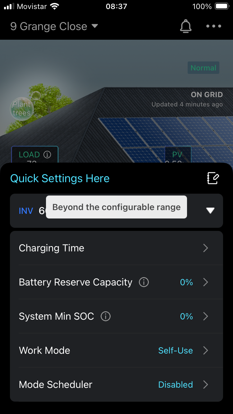

I can’t change the Battery Reserve Capacity, there’s a message, something about it being beyond the configurable range. I did manage it earlier but now its gone back to zero

They are all essentially the same thing just a coiled transformer - the Fox one is unique in that it’s normally white but your installer may have used a different brand so as long as it meets the same ratio and output specification it will work ok.
The clamp is normally fitted to the live cable coming out of the meter, whereas this has been fitted to the incoming live - that’s ok but when fitted there the arrow should be pointing towards the grid, and yours is pointing towards the meter (it’s the wrong way round).
If your son is feeling up to it, ask him to open the clamp and reverse it’s direction, then see what your load/export/battery trace now looks like.

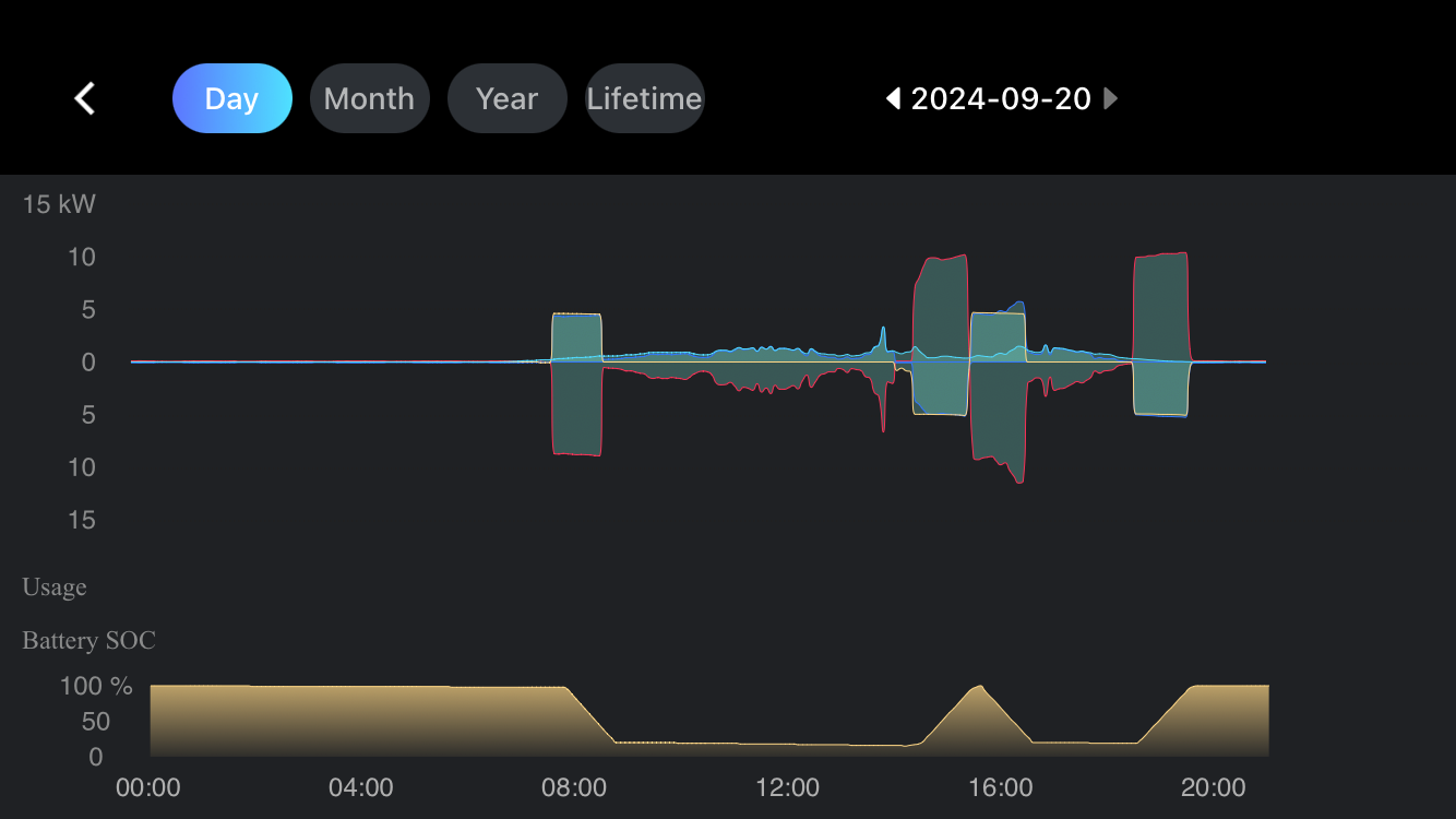

Morning Dave. They turned the CT Clamp round as you advised. I’ll post a pic of today’s graph a bit later. Hopefully you (and Will) will confirm that it looks more normal.

Now that the clamp has been refitted correctly and the inverter finally has correct information to go by, I’d like to know how to adjust the settings so that when there’s no PV output and the battery is charged, the load is met by the battery rather than the grid as at present (see attachment)
That’s looking much better now and reading correctly.
On that screen if you click on Quick Settings Here, then click on System MinSoc and set that to 10% and confirm, then click on Battery System Reserve and set that to 10% and confirm. Also double check that you have no charge times set.
It should then start using the battery to run the house.

Morning Dave! I tried to do as you suggested but I just get the error message you see in the attached screenshot.
I couldn’t see Battery System Reserve, did you mean Battery Reserve Capacity?

Ahh ok, that looks strange, as if your battery has lost comms - which isn’t very common but with the new install and the problems you’ve had perhaps not surprising.

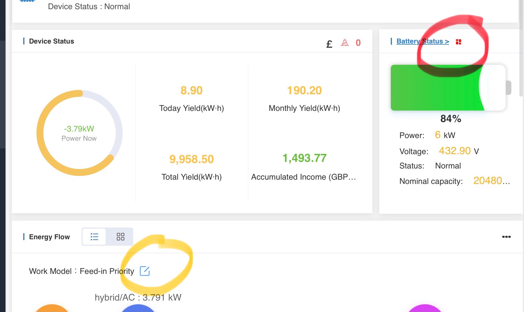

Just to double check it’s not an app problem, could you log into the foxesscloud.com (this may not be easy if you are doing this on your phone whilst on holiday) - on the left hand menu click ‘Device’ and then ‘Inverter’, it will show all the inverters in your account - on the right hand side click the button under ‘operation’ that will show a screen that looks like this -
Click on where the ‘red’ ring is, and that will open your battery settings - it should populate it with your current settings and if it does set the 2 minsoc’s at the bottom of the page to 10% and then press ‘save’
Unfortunately if that doesn’t work the next step is really a full system restart but with your installer coming next week perhaps the best thing to do now is wait for him to address it.
