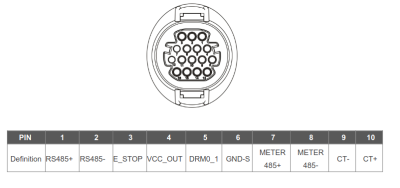

the com port has 16 pins, I've had a multimeter between pin 6 GND-S and 4 VCC_OUT which sadly only gives 3.3v
anywhere I can easily get 5v from the inverter?
thanks

the guy on github appears to be trying to get info from S series usb port, I want to take it from the com port
according to the user guide:
pin 1 RS485+
pin 2 RS485-
so erm I was thinking it was worth a try.....

... sadly those RS485 pins are for an export meter (if fitted), they don't support normal comms.

i've got some extra pins in addition to the 'meter ones'Dave Foster wrote: ↑Fri May 24, 2024 2:13 pm sadly those RS485 pins are for an export meter (if fitted), they don't support normal comms.
do you think it's worth a try? I had a brainwave for power, chop an old USB cable and take 5v and ground from the USB port lol
It's definitely worth a try, once you have connected up you can use modpoll to poll some random registers and see if you get a response from it.
