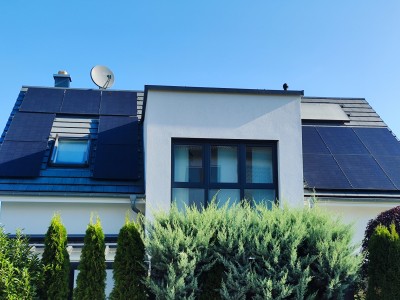

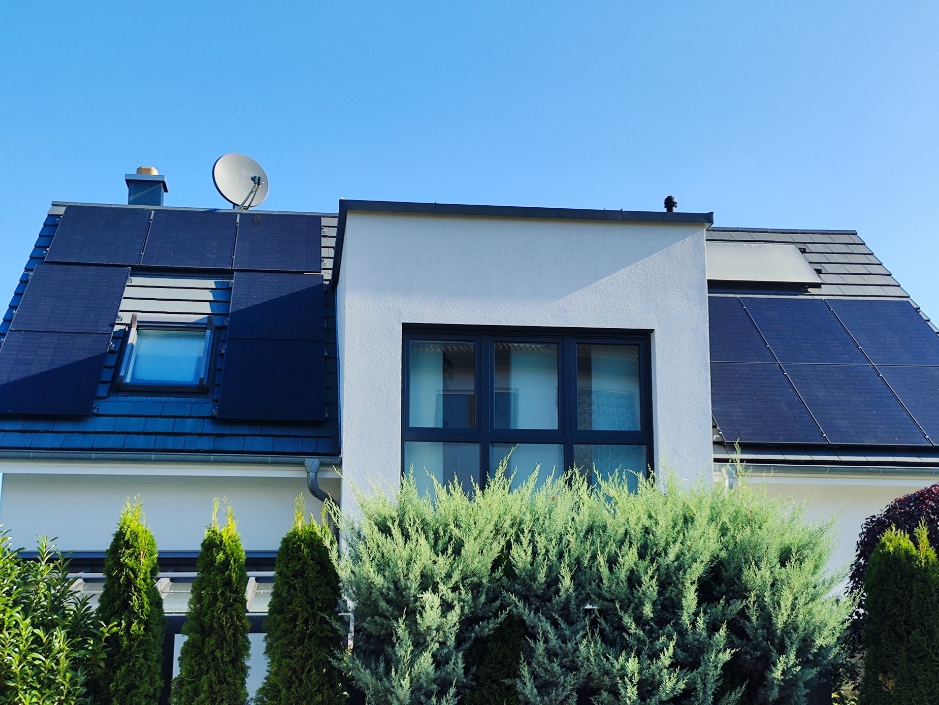

The initial weather situation in the morning is as follows (sunny, no clouds, some panels are partially shaded, one completely):

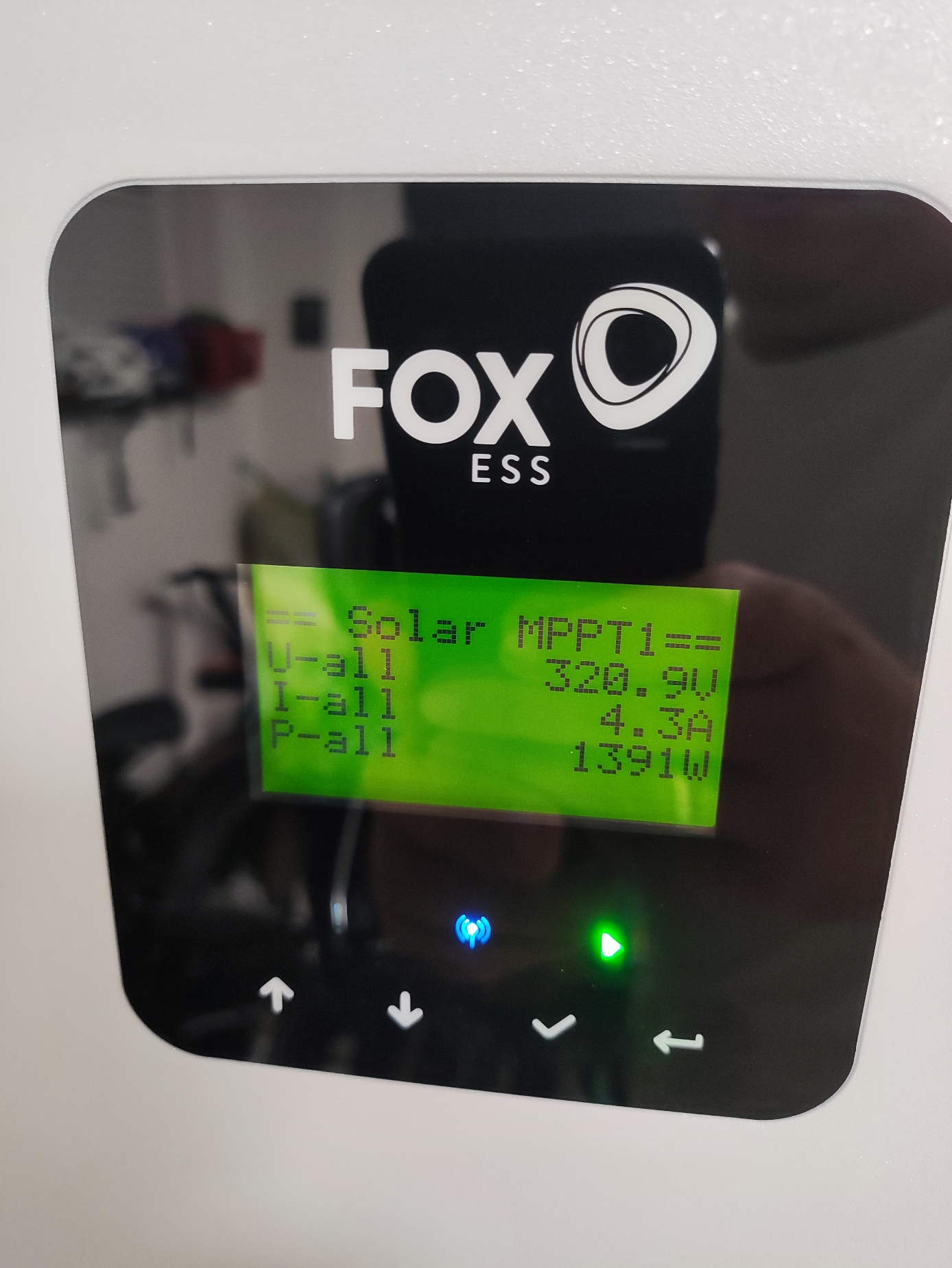

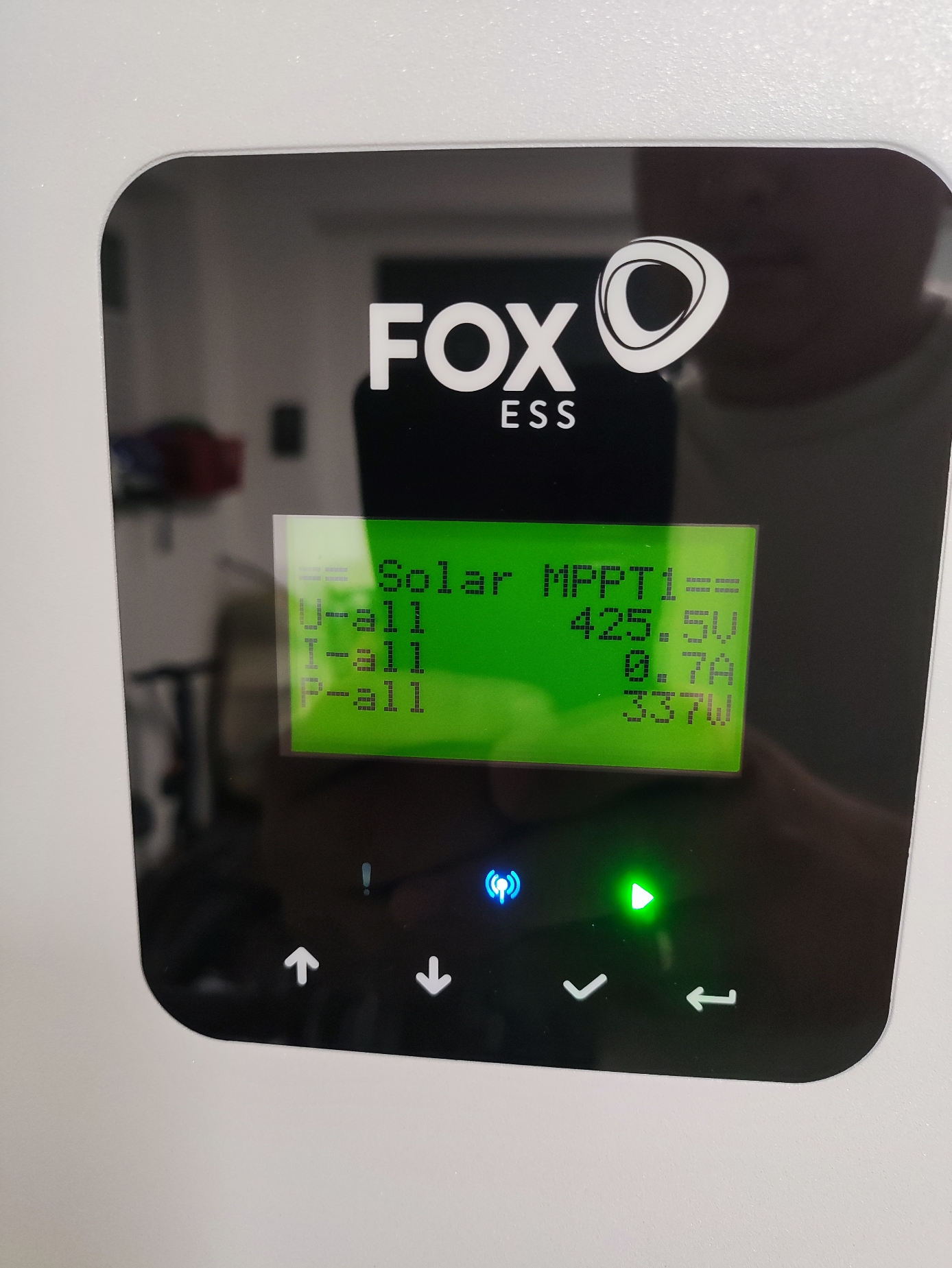

This values are shown in the PV Display before i reset the DC switch:

It looks like your installer has put all of your panels on one MPPT (approx. 33v x 13 panels = ~425v), which is strange in such a setup. It would probably have been a better idea to have each side of the dormer on their own MPPT as it could be the shading or over-panelling causing this. The other issue is that the H3-5.0-E has a max DC input of 4000W (and 14A) per string, which you will be exceeding at times (13x 420w panels would be 5460W for example).

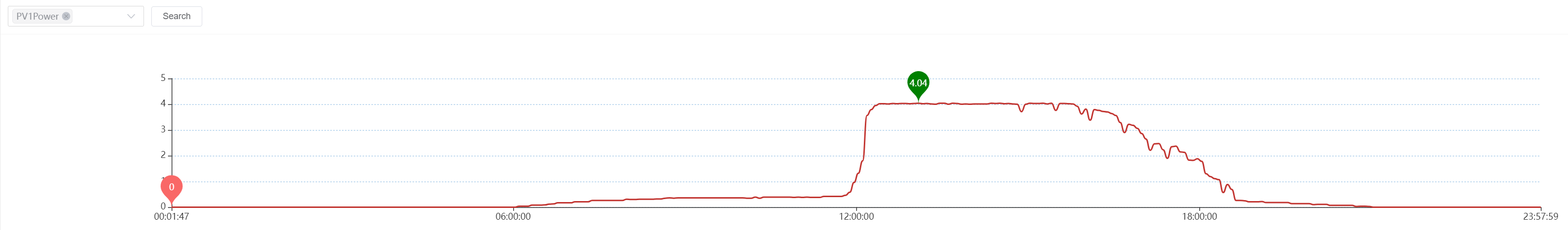

As you can see in the graphics the inverter cuts off to 4000 (the top of the mountain curve is missing)
When i do not reset the Inverter in the morning the graphics (PV Power) looks as follows:
You can see after ~12 o'clock AM the inverter suddenly powers up to 4KW. But, until 12 o'clock in the morning the PV Output is almost stagnant @400 W
