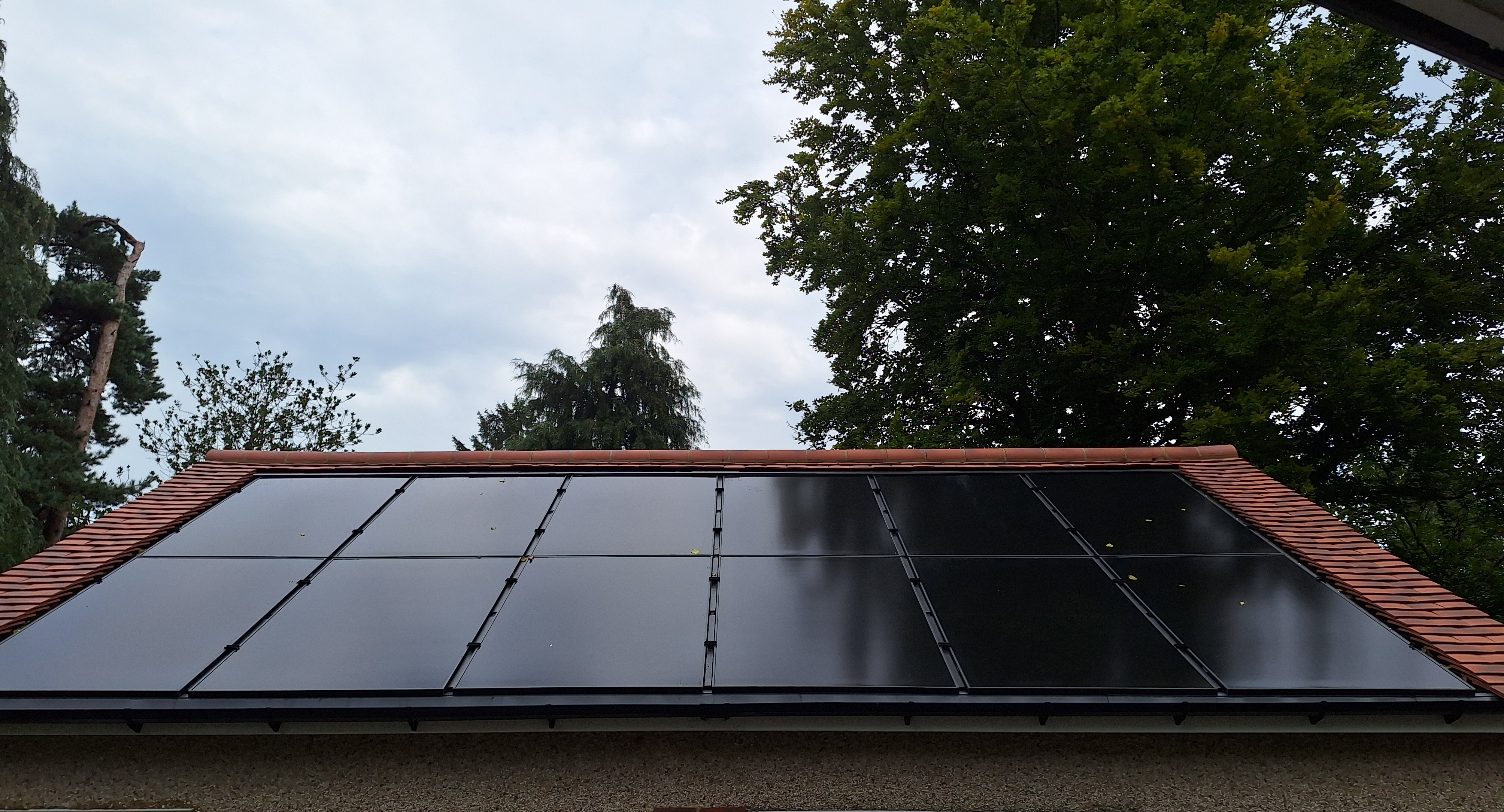

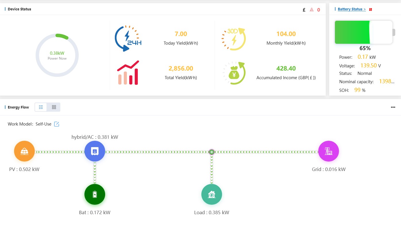

I have only had the system a few months but I am disappointed with the PV output on a cloudy day. Should I expect it to be better?
I have 12 Aiko panels (445 W each) with Tigo optimisers on two strings going to a Foxess Hi-5.0-E.G2 inverter and batteries. These PV panels are on a south facing garage roof at a pitch of 36 degrees. The roof area is not shaded after 9am.
Today is cloudy and the time is 1pm but the output is only 224W (4.6%). Any advice appreciated.

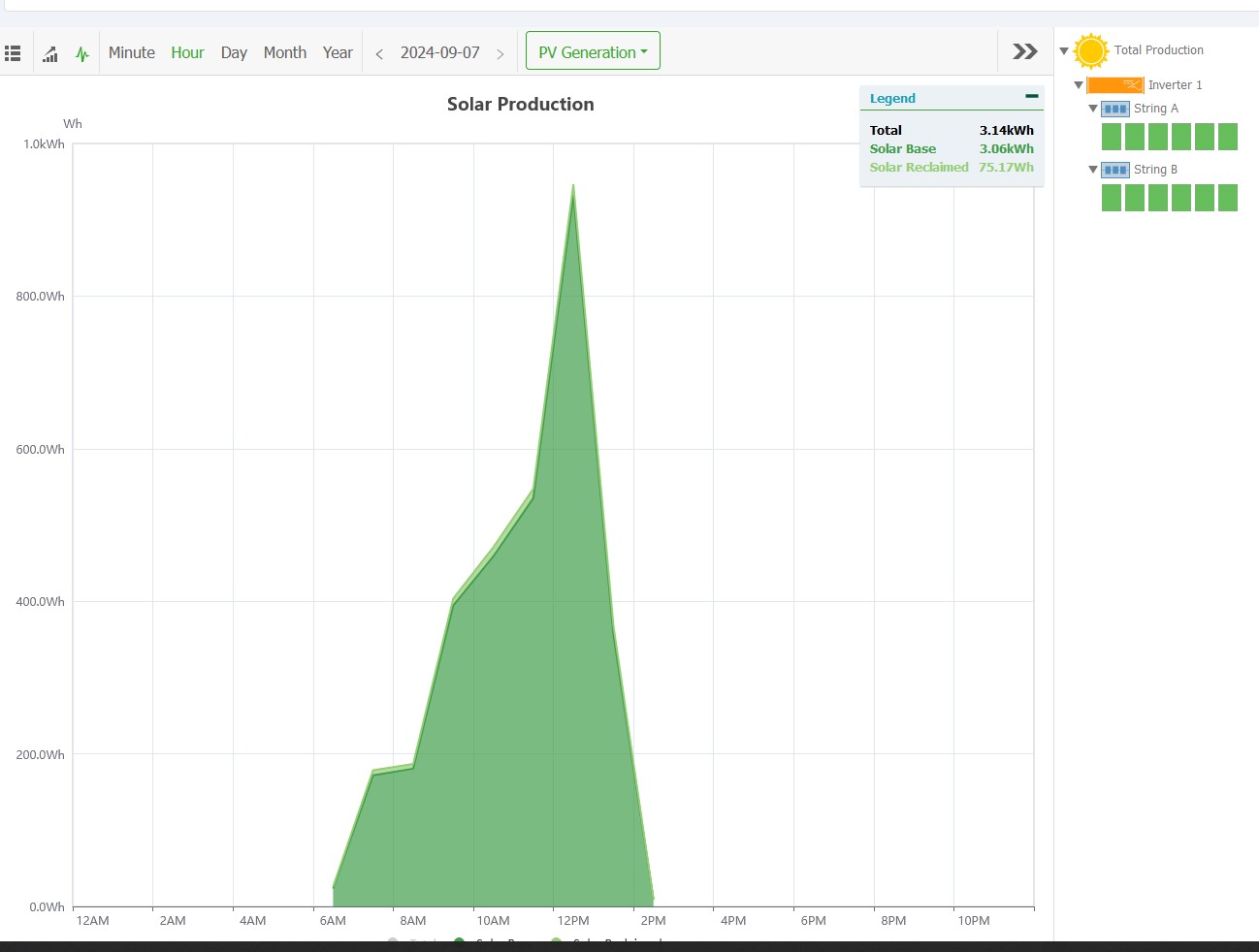

    				    			This is my total PV today, it's been a mix of cloudy, sunny and very cloudy.

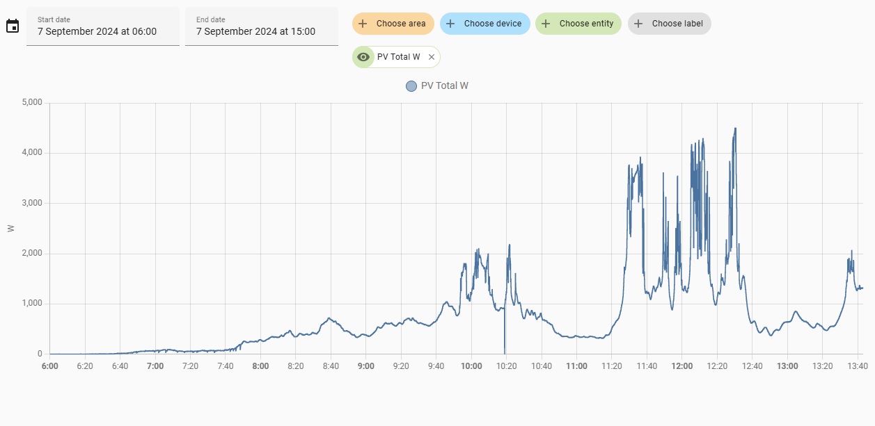

My system has 16 * 400 W panels but face a mix of directions East, South & West and quite a few moments today they were doing ~310 watts
224W is low but a lot depends on the suns elevation and how dense the cloud cover was - My lowest output for an *entire* winters day was 0.43kWh
It's best to look at your trace for the day to see how it is performing across the whole day, can you post that.

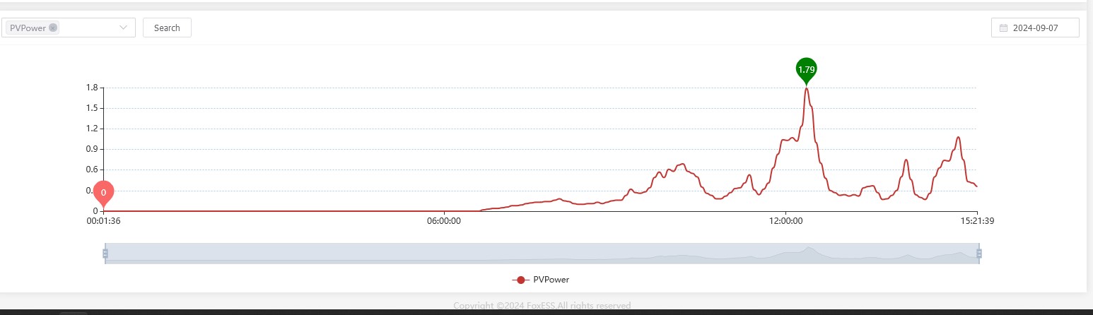

Silly question.....but how do you get that graph?  Is it through the Fox ESS Cloud app?  My app only seems to show a different graph.
    				I was using home assistant, but you can get a similar graph on the Fox cloud website by scrolling to the bottom of the inverter details page you posted and in the drop down menu in the empty graph, choose PV Power and press search
    				    			Thank you Dave, I didn't know that existed it was so greyed out. Here is todays graph. It looks a bit better than I first thought.
    				How does that compare with yesterday ? (i’m assuming it was as sunny where you are located as it was in the North West)Northspoon wrote: ↑Sat Sep 07, 2024 3:28 pm Thank you Dave, I didn't know that existed it was so greyed out. Here is todays graph. It looks a bit better than I first thought.
Update, it’s gone so cloudy now i’m down to 122 watts
I am in the South East where it has been overcast for several days.

We did 7.6kWh today with 9.42kW of panels.
