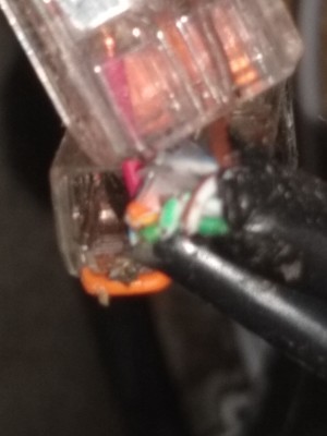

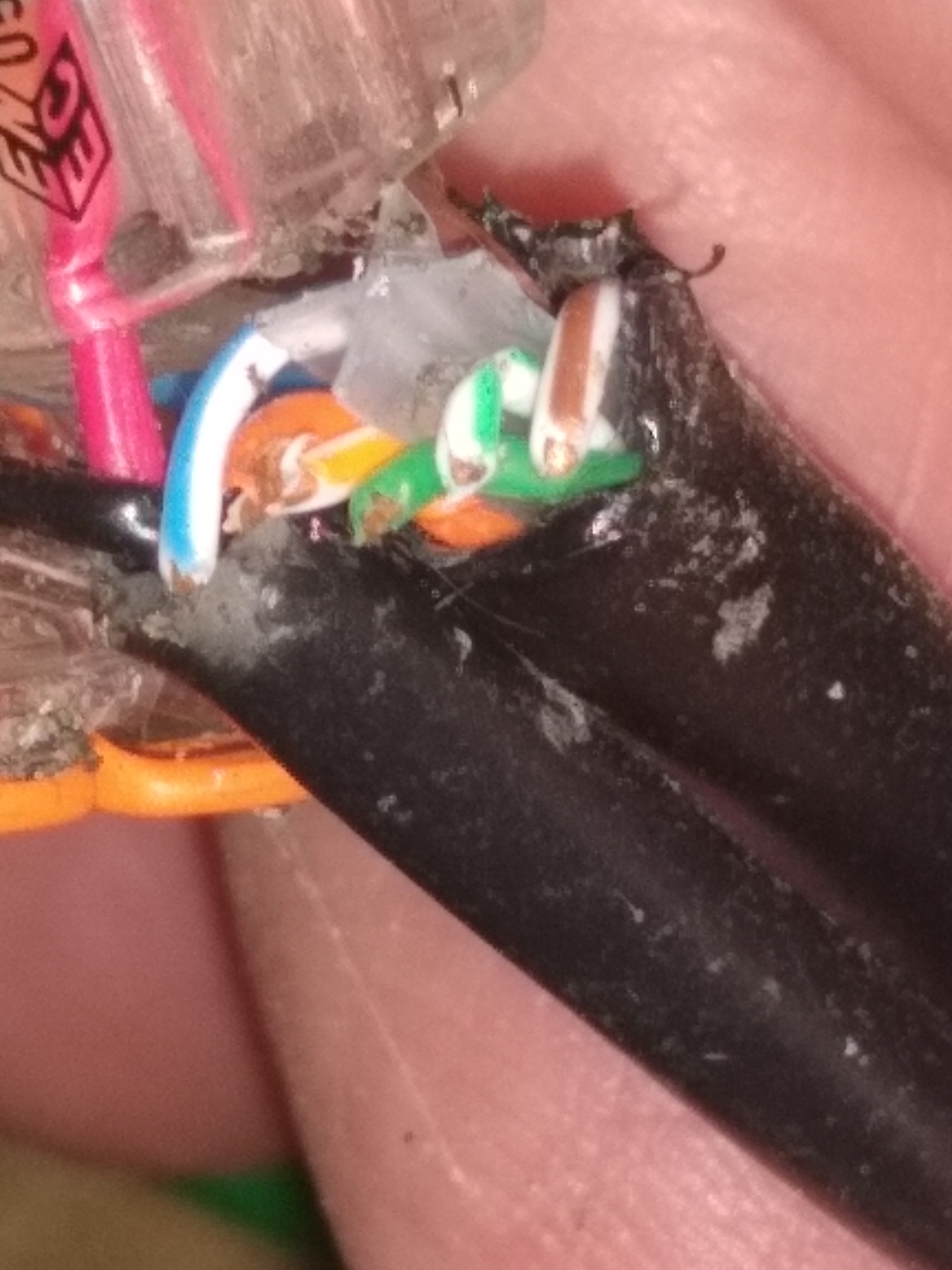

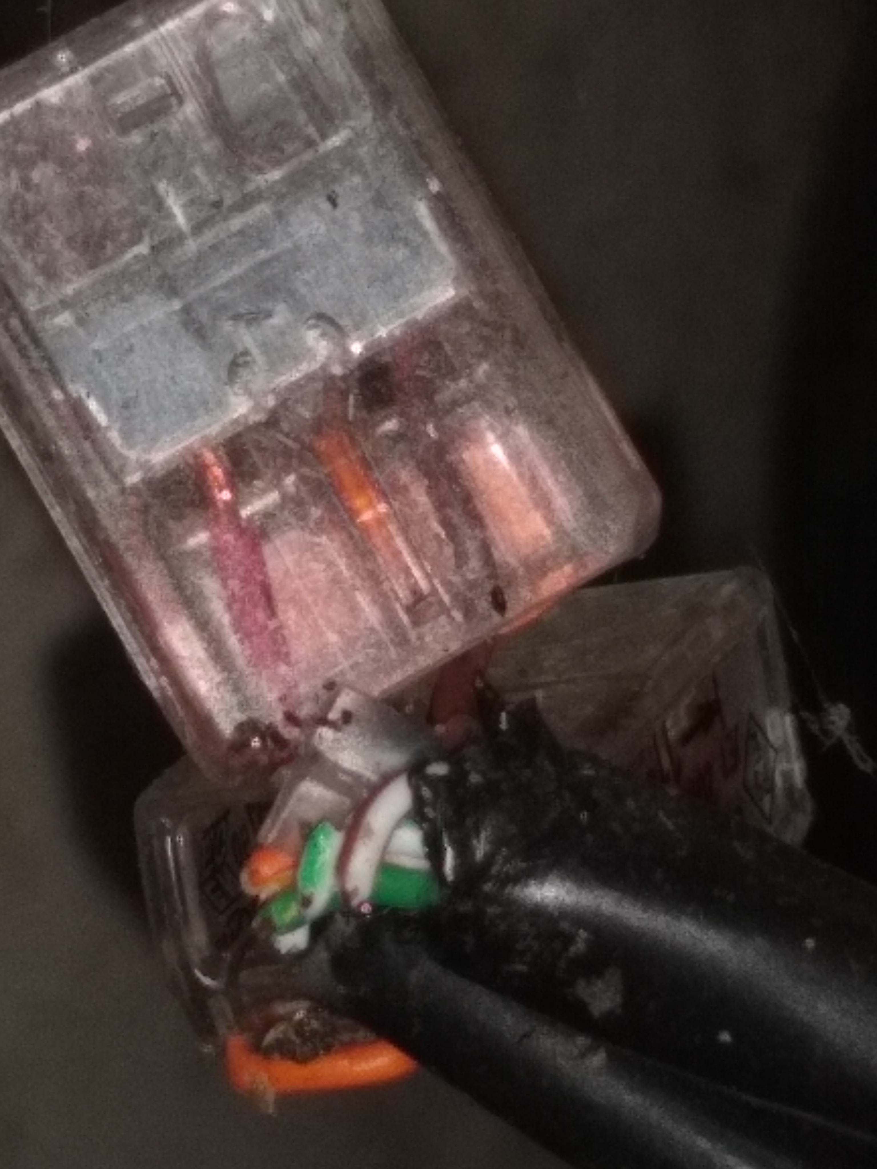

I've just had a look at the CT clamp and found this (see pictures).
Really poor pictures, really hard to get any kind of good picture.
Doesn't help much, I think.
I'm not sure that tells us much, the standard CT clamp is a white clamp with the words 'Split Core CT' and 'CTSA016-100A' written on the top - it has a black sheathed cable that comes out of it but the cores inside are black and white and I can't see that in those photo's - that might mean they have used a different CT clamp or put a RED sheaf around the white cable.
But going back to your original post you thought they had used 2 twisted pairs a blue and white and a brown and white (if it is a cat5 cable the whites would actually be white/blue and white/brown stripes) - we can see that the brown/white and blue/white cables have been left cut which suggests it is the brown and the blue cores that are carrying the CT signal.
Without a better picture and reading back through what you said I would suggest the cores that should be connected in the meter connector are BLUE to Pin 7 and BROWN to PIN 8
Note at the CT end the RED core looks like it might be loose in the connector so worth double checking that hasn't been pulled loose.
