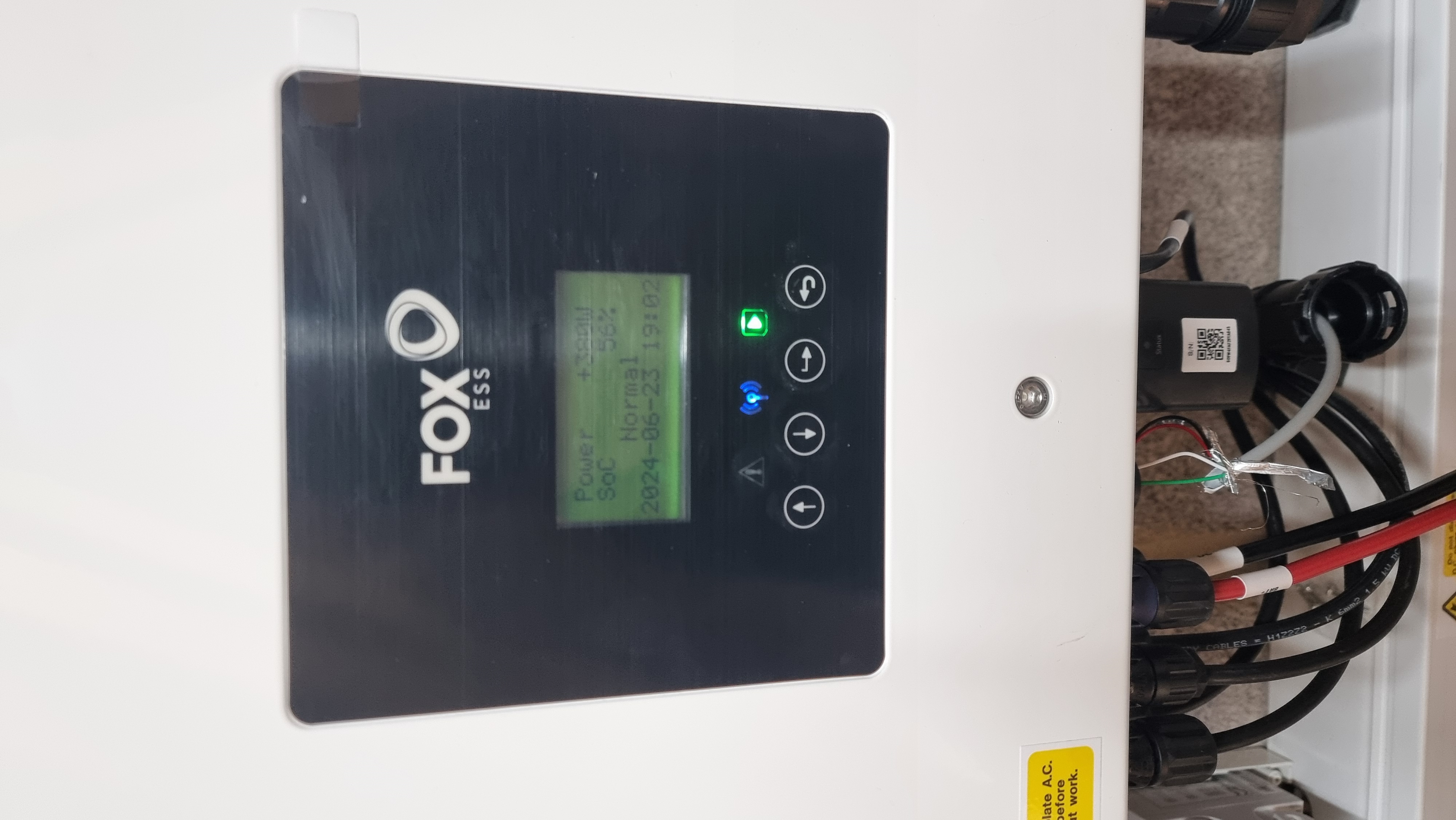

I have attached a pic of the inverter just in case it has been wired in reverse.
Posts: 1208
Ok, lets see what the morning brings as you’ll need some solar again to tell.
But that is an unusual installation, normally the CT clamps black cable would be wired directly back to the inverter and it would go into the meter connector (the big connector between the red battery lead and the datalogger with the red light).
But here you have a grey cable which I assume must be coming from the Chint meter and that suggests the CT clamp has been connected to that instead and the Chint meter is communicating with the inverter - all a bit strange.
If in the morning it is still not showing load correctly, I would call your installer back and get them to check that wiring - it ‘can work’ like that but it is overly complicated and the inverter has to be configured to communicate with the Chint meter and not a CT clamp… so your inverter settings need to be checked over as well.

So the electrician has been back today and he initially had the CT going into the CHINT meter and the CHINT meter going into meter 485A and 485B into the inverter. After reading the manual he has now bypassed the CHINT and fed the CT directly into CT1- and CT1+ and left the CHINT going into 485A and 485B.
Nothing has changed and the inverter is behaving as it was before. He is now stumped and says that he will have to speak to FOX to resolve it.
I took a pic before he put it all back together.
Is the wiring correct? I am wondering if the CT is faulty?
Posts: 1208
That looks to be wired correctly now, the CT clamp should be wired directly to the inverter.
It would seem the wiring from the CT clamp to the inverter is changed to run inside that multi-core cable so you would need to be sure that the connections at either end have been made consistently but the green and white wires are going to the correct pins in that connector now.
So 2 options, either leave it form him to talk to Fox (and they will definitely be able to fix it), or you can check in the inverter settings to see if the CT clamp has been enabled (or not) - if it hasn't obviously it won't work.
You can check it by at the inverter menu, select Settings and it will ask for a password, the default password should be 0{enter},0{enter},0{enter},0{enter} and then you select 'Feature', 'Meter/CT' and 'Set' it should say 'CT' if it doesn't use the up/down arrow keys to change it to say 'CT' - the inverter will restart and if the CT is wired correctly it should now be measuring load correctly (or if the wiring is the wrong way round it will be reversed but at least we will know the setting is set correctly)
