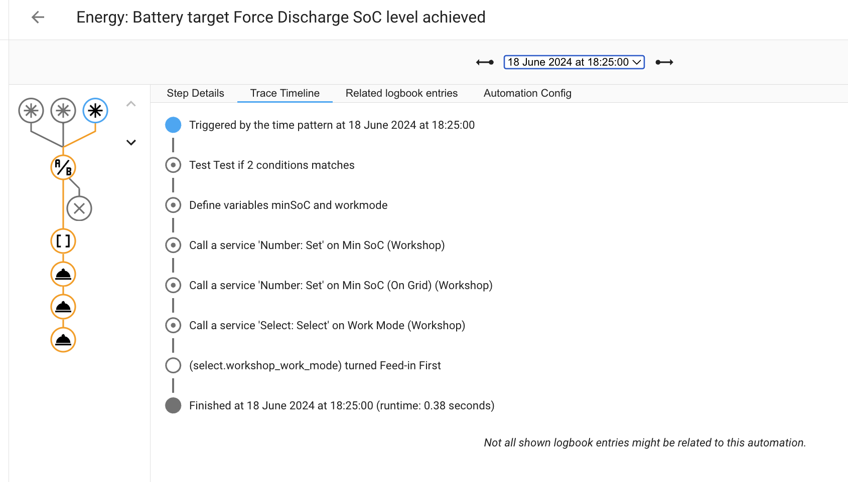

didn't trigger though, Any ideas?

alias: "Energy: Battery target Force Discharge SoC level achieved "
description: >-
Sets the Min SoC to lower 'day time' level and work mode back to Feed-In
Priority
trigger:
- platform: template
value_template: >-
"{{ states('sensor.workshop_battery_soc') | int(0) <=
states('input_number.min_soc_peak') | int(0) }}"
variables:
minSoC: "{{ float(states('input_number.min_soc_day')) }}"
workmode: Feed-In Priority
condition:
- condition: template
value_template: "{{ states('select.workshop_work_mode') == 'Force Discharge' }}"
action:
- service: number.set_value
target:
entity_id: number.workshop_min_soc
data:
value: "{{ minSoC }}"
target:
entity_id: number.workshop_min_soc_on_grid
data:
- service: select.select_option
target:
entity_id: select.workshop_work_mode
data:
option: "{{ workmode }}"
mode: single
