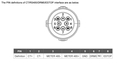

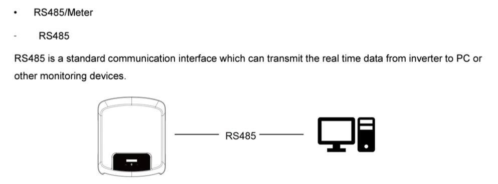

The documentation (page 19) of my inverter mentions connection with a PC over a RS485 connection.

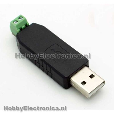

So I bought a USB RS485 adapter and tried to get some readings.
I have not been able to get any data from the inverter to this day. There is no documentation (i'm aware of) that describes the registers (modbus?) that can be read or how to read them.
I'm beginning to doubt it the F4600 model is even capable of rs485 communication. (it has the proper connector for it though)

This probably isn't much help as I don't know whether the F series supports modbus, I do know the T series doesn't, instead it simply transmits data packets on the RS485.
There are a couple of projects out there for the T series https://github.com/LucasTor/FoxESS-T-series is the most popular for the T series and seems to be maintained, also this one https://github.com/assembly12/Foxess-T- ... -Assistant - this issue appears to confirm that the F series isn't compatible https://github.com/assembly12/Foxess-T- ... /issues/14 but they have developed something that might help.
