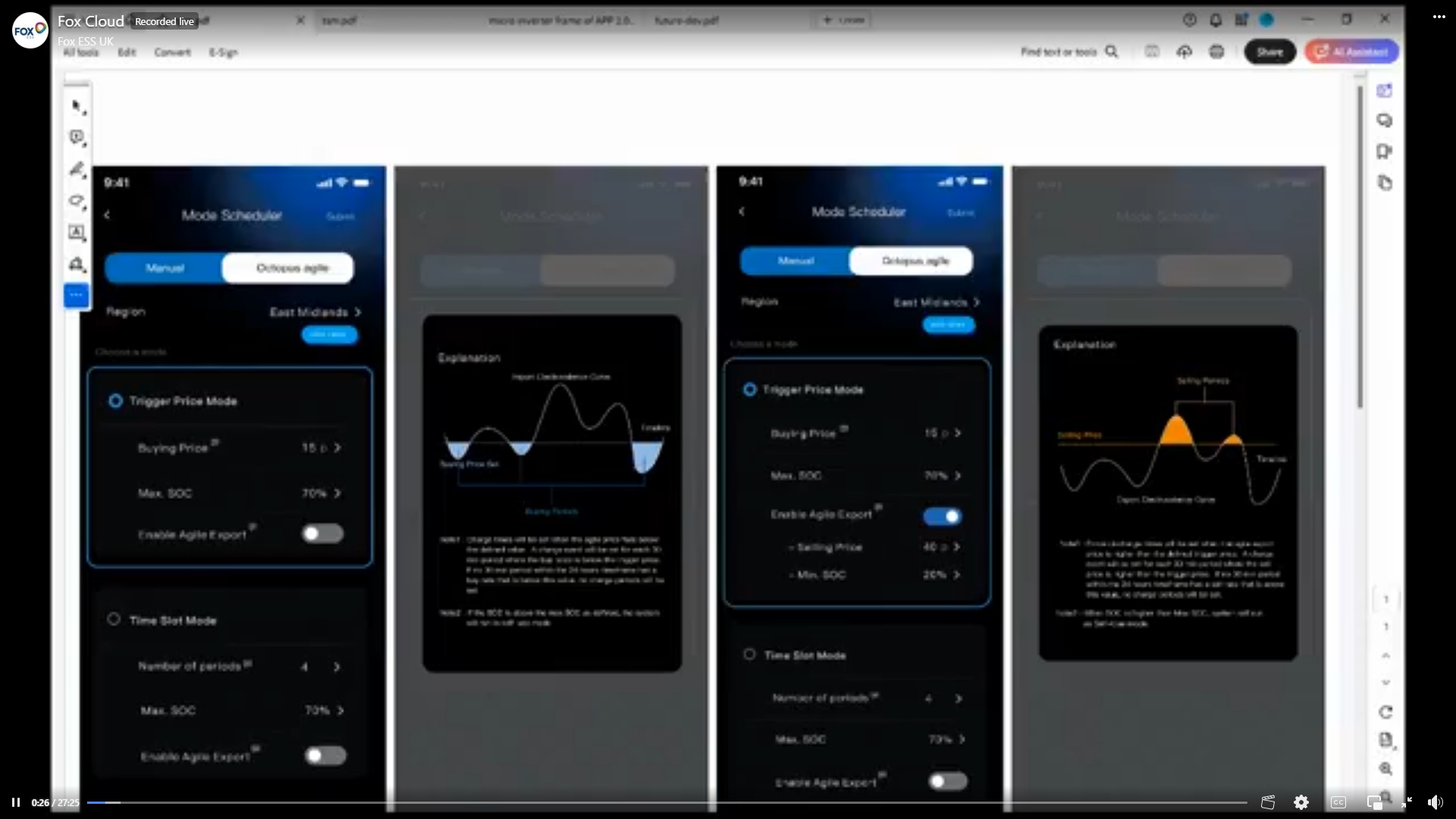

Hopefully in time to support the new Octopus Agile functionality coming in Fox ESS app ver 2.0
https://fb.watch/quPACBookH/
