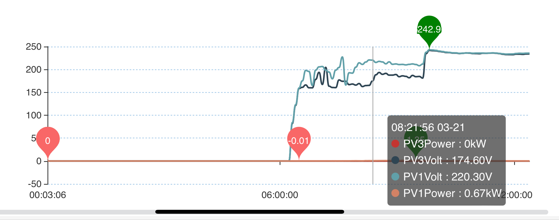

1. Solar panels are plugged into PV1 and PV3. PV1 shows voltage and power. PV3 only shows voltage, no power. When I check on the inverter, PV3 shows power. So for some reason the data isn’t being fed to the Cloud.

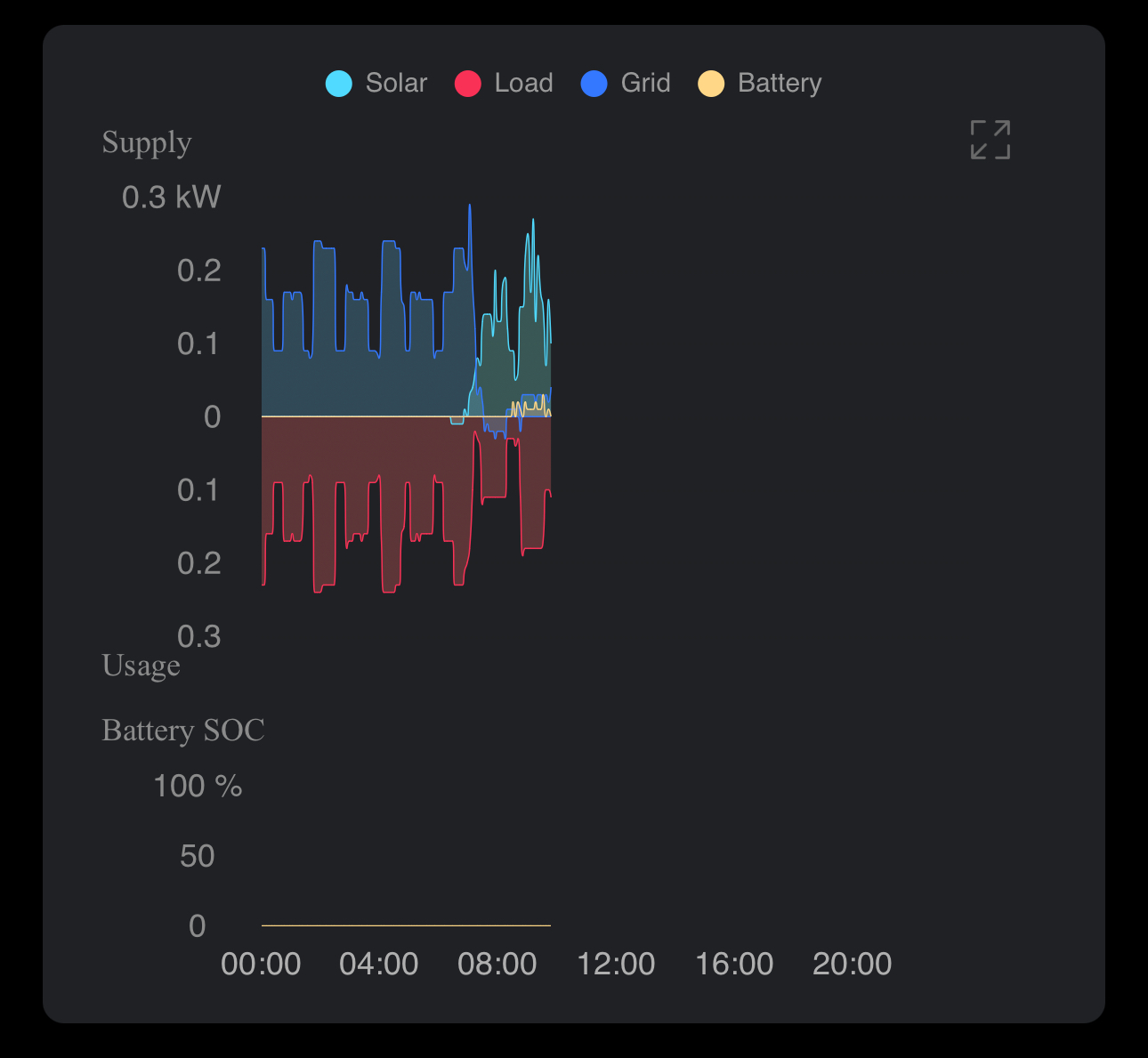

2. Battery SoC shows on the main screen and battery screen. However, when I look at the analysis chart, SOC is just a line at 0% (ie I can’t track battery charge and discharge over time). So although the data is going into the cloud, it isn’t being recorded for some reason.

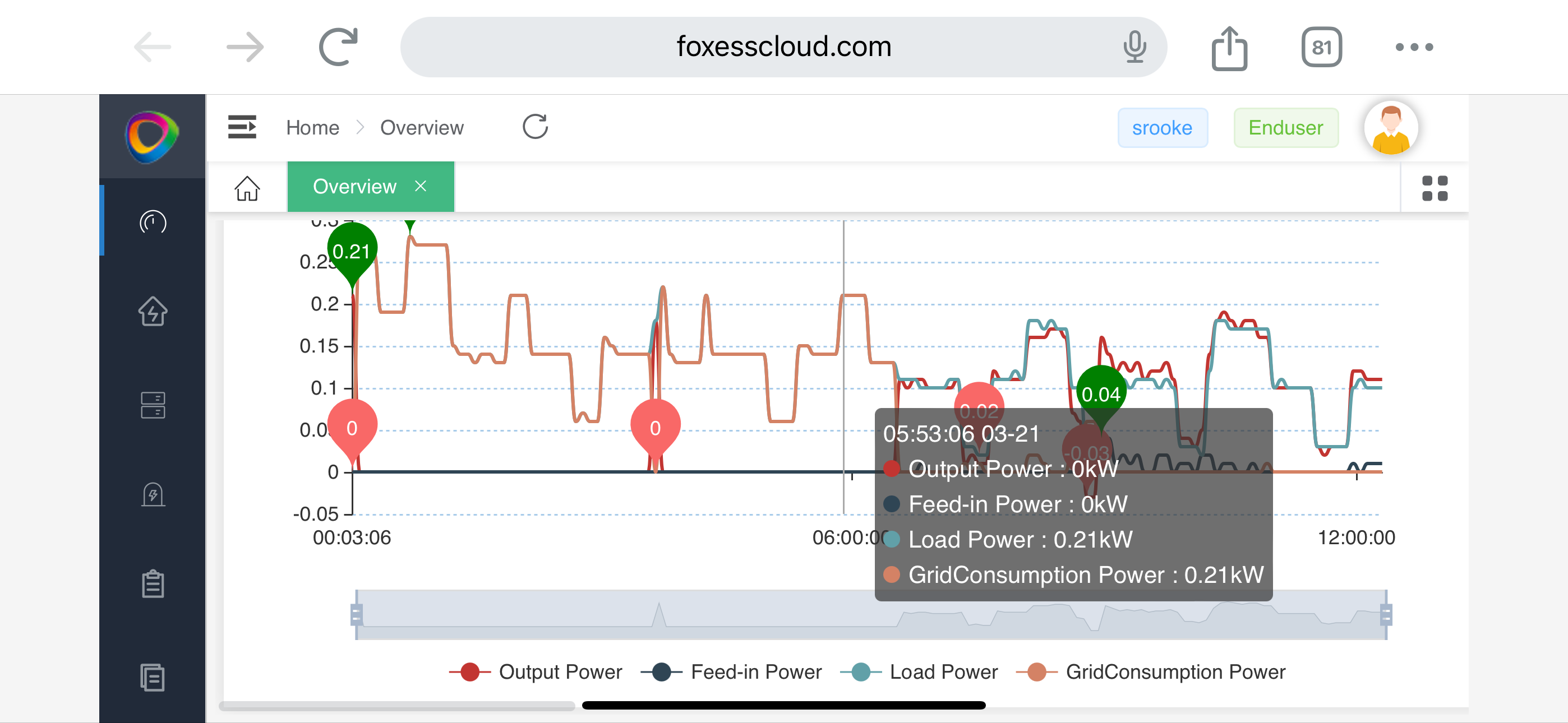

On PV power and SoC, you should be able to check on the Foxesscloud website to see whether they are being recorded in the cloud - alternatively you can cross check with the Energy Stats app (available in ios and Android) to see whether it is a cloud issue or a V2 app issue.
I don’t really use the V2 app but if you look on the Foxesscloud website you can see your power and statistic graphs which should show you your daily usage which would confirm load and grid consumption totals as the usage graph you posed certainly doesn’t tally with your production figure in the V2 app.

Thank you for the quick and thorough response. I am using both v1 and v2 of the app and Energy Stats. All are showing the same thing.
I checked on the website and the SoC chart is showing correctly. However, PV3 Power is still reporting as 0.
So it appears that the SoC is a bug with the app, but the PV3 data coming off of MPPT2 is a legitimate data feed issue.

Ahh of course the H3 Pro has 2 battery inputs - it sounds like the app must be getting confused as to which one to display - that’s a bug.

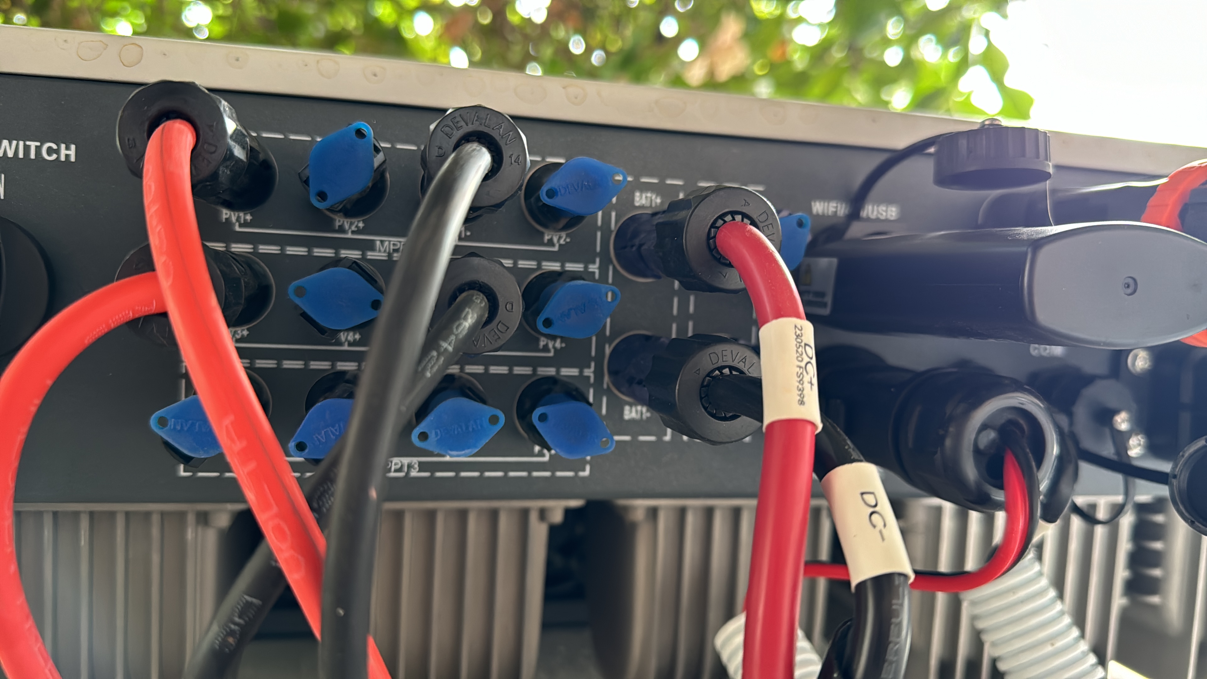

I think the PV3 power issue must be related to the H3 Pro as well, i’ve seen quite a lot of inverters showing PV3 & 4 power so looks like another one to report - just to confirm you don’t have a PV2 string fitted only strings on PV1 & 3
srooke
Posts: 13
Joined: Thu Mar 21, 2024 1:38 am
Correct. Strings are only on PV1 and PV3.
