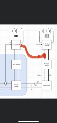

Is there any chance you could post a schematic of how your system is installed - the installer should have left you a basic sketch as part of the G9x process.AlanHarwood wrote: ↑Mon Mar 04, 2024 2:58 pm
My setup has the two inverters in parallel. I had assumed that it was set up that way because of the limit of 5KW AC through the inverters, but on looking through the manual I see that it says 5KW or 5kW+5KW (bypass). Would wiring them in series mean that the output of the first one would be "bypassed" through the second, thus avoiding the 5KW limit?
I'm not sure how your third CT works: is the CT clamp on the second inverter connecting to the output of the first inverter, i.e. both inverters are connected to eachothers output?
If I leave my inverters in parallel, but fit the extra CT clamp, then would the problem of competition/confusion only occur once I add a second set of batteries?
As you've probably gathered, I'm new to all this!
- Posts: 14
- Joined: Sat Mar 02, 2024 5:10 pm
The installers sent me an email enclosing the schematic yesterday. Unfortunately it only showed one of the inverters, and was missing some other parts too. I have asked for a corrected one.
- Posts: 14
After sending me three versions of the schematic, none of which actually matched what they had installed, they finally admitted that the two H1-5 hybrid inverters could not work in parallel, and they are swapping them out for an KH10.
This reduces the maximum number of batteries I can attach, but it's probably enough, and if it isn't, KH10s are designed to work in paralllel, so I'll still have a way to expand if necessary.
- Posts: 949
Great, I didn't want to comment until I saw your schematic but that was what I suspected, having the new KH10 makes much more sense, smaller, more efficient and very capableAlanHarwood wrote: ↑Thu Mar 14, 2024 4:41 pm After sending me three versions of the schematic, none of which actually matched what they had installed, they finally admitted that the two H1-5 hybrid inverters could not work in parallel, and they are swapping them out for an KH10.
