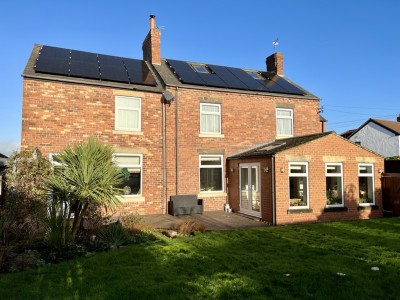

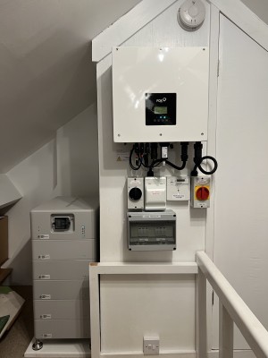

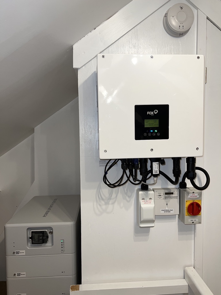

I've had my PV system installed, it's up and running, very happy with it.
H1-6.0-E Hybrid inverter
7.1kWp panels (18, with Tivo optimisers)
17.4kW Energy Cube battery (1x ECM2900 + 5x ECS2900)
It's wired for whole house EPS in the event of a grid outage with a manual changeover switch.
very nice, looks like a neat install.

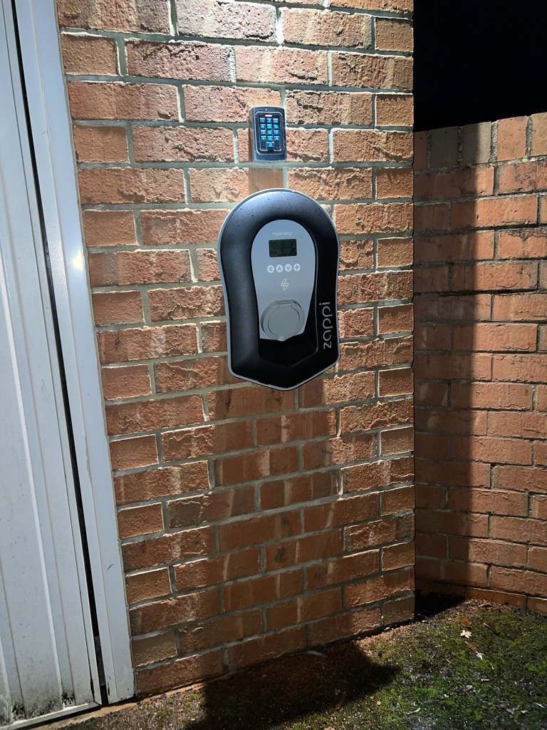

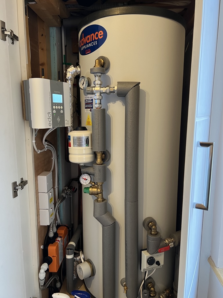

I forgot to add I have a MyEnergi Eddi and a Zappi too.
Added an external DC isolator for the PV panels as I wasn’t happy the DC cables go directly to the inverter, and whilst doing that I added DC surge protectors too.
