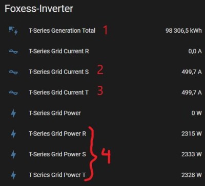

Hi. I`ve connected to the T3 inverter according to manual "Foxess-T-series-ESPHome-Home-Assistant" by assembly12. I receive the data but it is somehow mixed up.
Some examples like on picture:
No 1 - this is way too high and by day it is decreasing
No 2 and 3 - those values are frequence but placed at current
No 4 - this is voltage for each line but I see it as W
What can the problem ?

I have noticed some improvment when I deleted few sensors from esphome yaml, which was`nt relevant for my T3 inverter, described as "#only relevant for models T8dual-T12dual and T15-T25)". Stilll I have error with total production which is now as T-Series PV4 Power in Watts.
