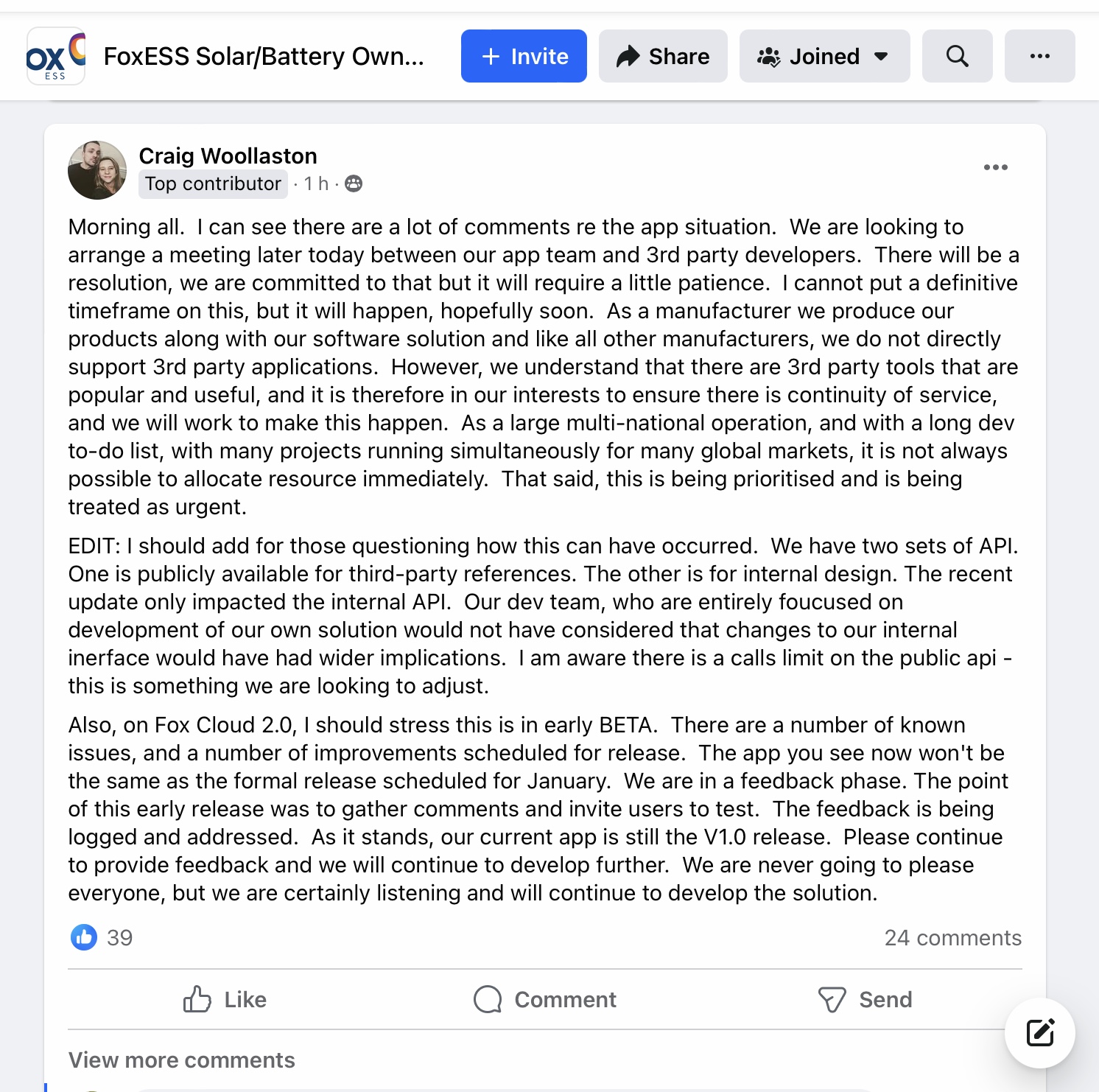

Please see below which has been posted by Al, not good news for the users of the Energy Stats app or those who access the Foxcloud directly.
For existing users of the actual Foxess app (Ios or Android) there is a new application recently released called Foxcloud2 which improves on the original application - it is only available to existing foxesscloud users whilst it is under-going trials.
Both the new & old applications will run side by side until the full release of V2 is approved after which new users will be able to register and use it.
This is the announcement from Foxess support
For users that wish to post comments on the applications functionality the link is here - https://docs.google.com/forms/d/e/1FAIp ... Hmmi1-h_6c
****** UPDATED ********
Please see latest update from Foxess, it’s moving on - hopefully not too long to wait 👍
************ 2nd UPDATE *********************
This is the latest update from Foxess as at 21st December 2023
************ LATEST UPDATE *********************
Foxess have reversed the changes that stopped the Energy Stats and Fox cloud access from working, it is all back to normal again and the applications are working :)

UPDATE
Following on from this, Foxess UK support have responded to say this was not as intended and are asking the developers to discuss options to get this working - see latest update… please watch this space for further updates 👍

Posts: 952
I have updated the first post with the latest status update from Foxess
Posts: 952
Foxess have reversed the changes to their API and the Energy Stats app and Fox cloud are now working again :)

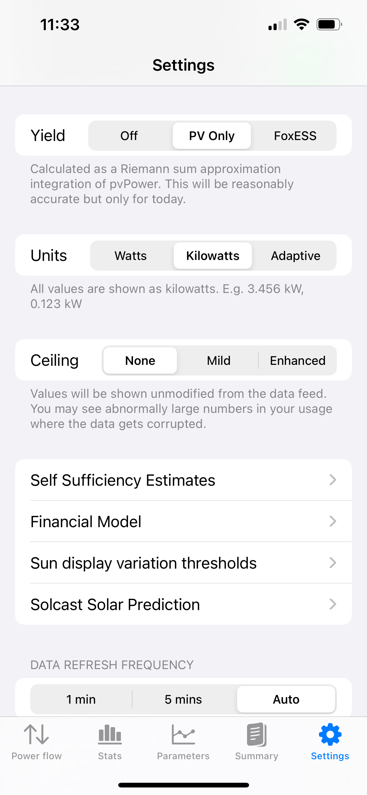

Dave, have a look at this description of the “yield today” value in settings (screenshot below).
It explains it is using a formula and my toggle is on PV Only (not Fox).

Posts: 952
Lol, you're quite correct - I didn't have the latest and Al updated it 2 days ago to provide this feature.
So yes it's integrating the measurements over time to work out your approximate PV generation today.... very nice :)
