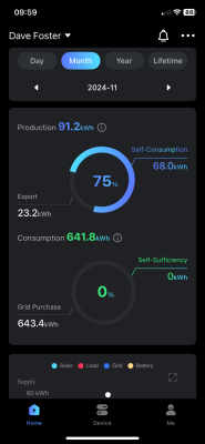

How did you work out the amount drawn from inverter please? My electricity consumption has increased from 5-8kwh to over 10kwh once the Fox inverter was installed. It defeats the purpose of saving energy. Any help is much appreciated. Thank you.
Posts: 1887
Do you have the V2 app as you should be able to work it out from there - naturally the winter months are the worst as you have very little solar and the overheads of maintaining the system, 1-2kW is probably not unexpected but any higher needs thinking through.
If you open the V2 app and swipe right, you will get to this page - choose month and pick a full month That is mine for November (I am quite a heavy power user), if you lift the main statistics out you get to these calculations -
Your solar Production was 91.2 kWh (A)
You Exported 23.2 kWh (B)
So your Self-Consumption is (A-B) = 68.0 kWh (C)
Your Self-Consumption ration is (C / A) = 75%
Your consumption was 641.8 kWh (D)
You Purchased 643.4 kWh from grid (E)
Your Self-sufficiency is (D-E)=-1.6 kWh (F)
Your % self-sufficiency is the ration between (F / D) =0%
Your system efficiency (Input/Output) is:
Input = Production (A) + Purchase (E) i.e. 91.2 + 643.4 = 734.6kWh
Output = Export (B) + Consumption (D) i.e. 23.2 + 641.8 = 665.0kWh
Your system losses is the difference between Input and Output (69.6kWh ) which is 9.5% of the Input ~ 90.5% efficient.
If you post a few pictures of your stats (pick as many full months as you have), I have a spreadsheet I can drop the numbers in and it will do the calcs for you - or just post the main numbers from there i.e. Production, Export, Consumption and Grid Purchase for each month.

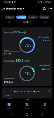

Posts: 12
Joined: Tue Oct 08, 2024 9:14 am
Hello Dave,
Thank you so much. You took your valuable time to answer me in so much details.
Here's my December production, tiny compared to you. I would like to find how much energy the inverter use per day if possible.
Thank you
Thank you
Posts: 1887
That's a little unusual as when I run the figures your system is more than 100% efficient which is not possible unless something was measured wrong in the month - do you have any other sources of generation, another solar inverter ?
This is what I got -
Your solar Production was 11.5 kWh (A)
You Exported 3.1 kWh (B)
So your Self-Consumption is (A-B) = 8.4 kWh (C)
Your Self-Consumption ration is (C / A) = 73%
Your consumption was 333.3 kWh (D)
You Purchased 299.6 kWh from grid (E)
Your Self-sufficiency is (D-E)=33.7 kWh (F)
Your % self-sufficiency is the ration between (F / D) =10%
Input = Production (A) + Purchase (E) i.e. 11.5 + 299.6 = 311.1kWh
Output = Export (B) + Consumption (D) i.e. 3.1 + 333.3 = 336.4kWh
Your system losses is the difference between Input and Output (-25.3kWh ) which is -8.1% of the Input ~ 108.1% efficient.
Either you have more generation than is being shown here or there is something wrong in the grid purchase or consumption measurements - probably best to start with can you confirm how much electricity you have used on your December bill as we should be able to trust the smart meter.
