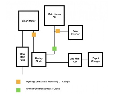

Darren, yes that’s a good way to sort the problem but the way it is wired has to allow the CT clamp to be moved - the best way to install the EV charger is in front of the Inverter and is usually done by fitting a splitter (Henley block) just after the feed from the smart meter, then you can install the CT clamp for the inverter on it’s own circuit and it won’t see the power taken by the charger.
Unfortunately if you can’t re-wire the solution, the only way to avoid battery charger is to set a charge period at the same time as the EV is charging.
I’ve attached a block schematic that shows the ‘ideal’ wiring approach, it was drawn for a Growatt inverter with a Zappi charger, just change the labels to read Foxess Hybrid and your EV charger type.

I'm in touch with the installer so will ask about the suggested changes when he comes.
