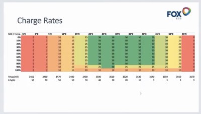

I’ve attached the Foxess chart which shows the max charge current for any given temperature - the power will depend on your battery stack and it’s voltage Power = I * V where I = battery charge current, V = battery volts.
