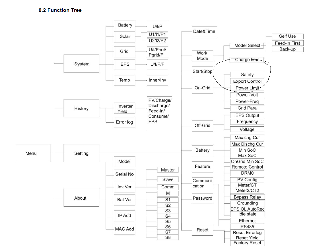

Have you set the Grid safety ?, if you are in the UK it should be G98/G99 depending on your approvals - it's one of the first things that has to be set before it will run correctly.
Posts: 1790
This is the menu structure for the H1 -

Thanks Dave, I have G99 so I'll set that. Rgds.
