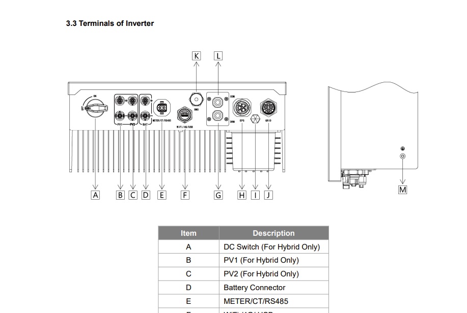

The CT clamp (or meter) would be wired into the meter connector (see diag below), if there is no cable going into this connector it is not fitted and won't work.

Thanks for your reply. There definitely is no CT clamp or meter installed, this must be the problem. Unbelievable the installer didn't do this originally and the previous owners didn't realise, the system is 2 years old now!
