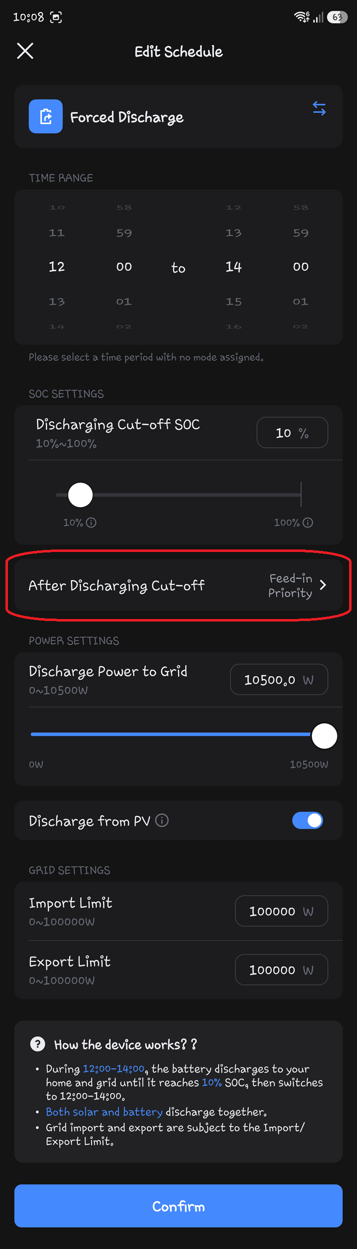

As Dave has said, you need to set your system into 'Feed-in' work mode to not charge up your battery.
Then you should set a 'Force Discharge' up, for 1-x hrs long before your free power. How long to setup discharge for depends on your export rate/amount of PV/battery capacity. You can have it stop when the battery SoC reaches 20% if you are unsure.
So if you selected 11:00am as your free session, you might have to create a discharge schedule at 9:00am to 10:59
If you see this marked red choice here, make sure that it is set to 'Feed-in' and not 'Self-use' as the latter would begin charging again.
