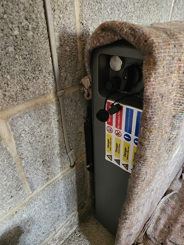

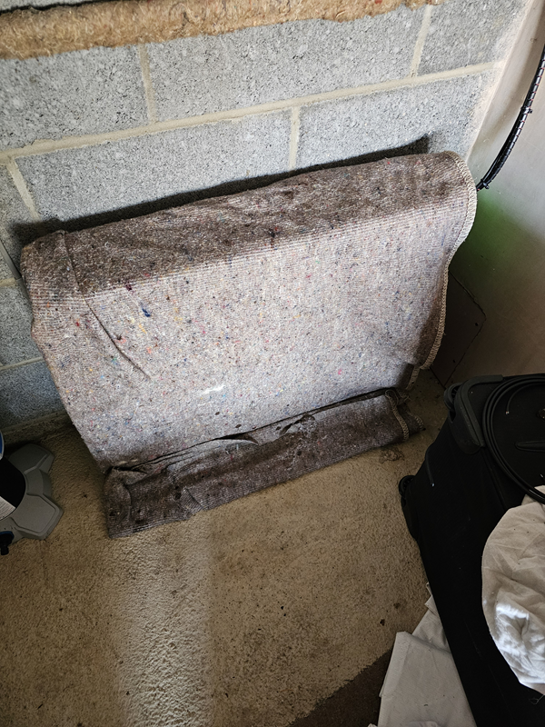

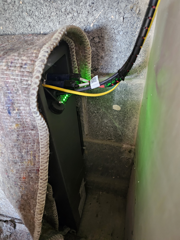

I chucked a blanket over mine for Winter periods, as the cooler nights might be helping the SoC drop a little under the 10%. As linked in the previous post, a few calibration cycles will be helpful in making the BMS a little more accurate.
Just make sure not to cover the wires if you chuck a blanket over, alternatively build a little box around it with some insulating board like kingspan.
