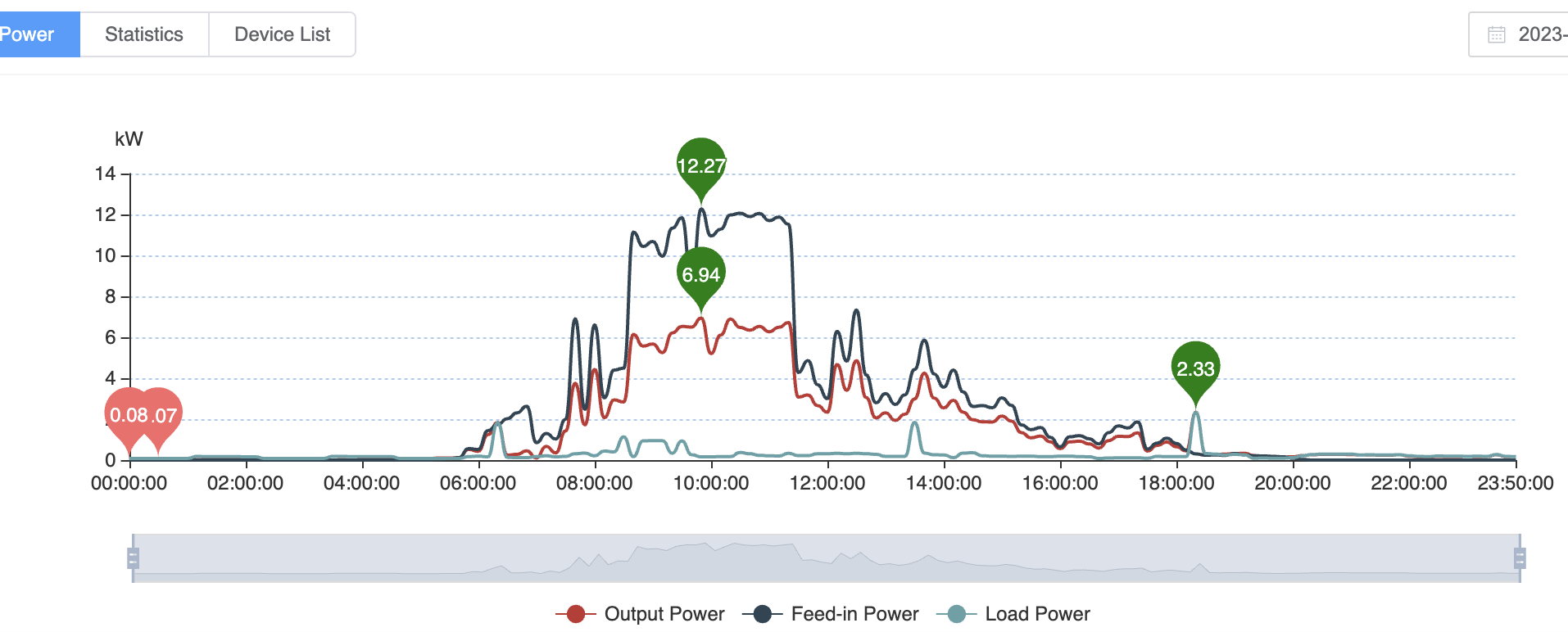

Initially the installer didn't connect datalogger for F6000 but instead connected it via CT2 on H1. This had enabled a basic monitoring from one device (H1) but F6000's power wasn't showing or accounted for when viewing the 'Site'. The F6000's datalogger was connected just over a week ago so it's slightly better now but I still have a few issues.
Firstly I noticed that when viewing the 'Power' tab on 'Site', the Feed In Power is always higher than the Output Power which seemed illogical to me:
I then noticed that the Energy Flow graph for F6000 is always showing that it's exporting to the grid and never to the load. I imagine that this would be the reason for the higher Feed In Power when viewing 'Site'. Despite Feed In Power always higher than Output Power on the 'Power' tab, the 'Statistics' tab graphs are showing less total Feed In than Total Yield so that seems to be calculating it more or less okay.

Sadly this is a limitation of the system. If you want better site reporting I would also install a ct clamp on the F series so it can monitor house loads.

Thank you Will. I'll speak to the installer re CT clamp on F. It seems there are also questions over F series RS485 port so for now I live off data from Fox Cloud and myenergi. Not ideal but at least I get more or less import and load data.
