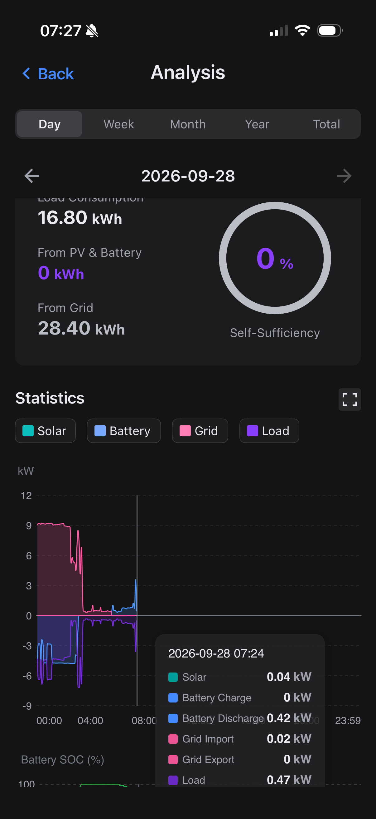

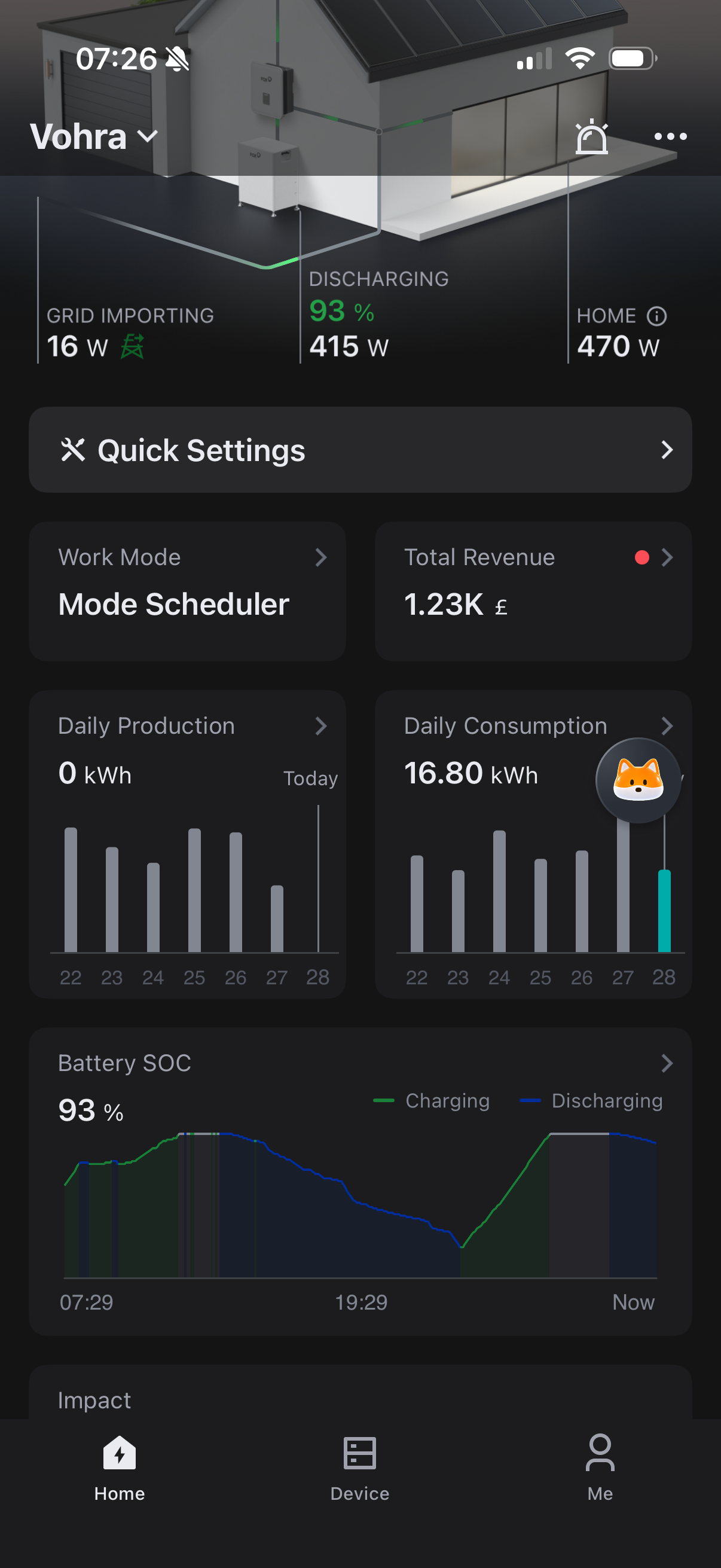

I force charge the battery every night to 100%. No problems until I attempted to tweak the time too keep it charging until 0700 . Now it starts a charge then stops and the battery appears to discharge . I did a test one this morning and it kicked in and charged. However it's just not working at the crucial times between 0000 and 0530.
What have I done wrong? I just dont get it?

I noticed that the charge power from grid was set at 6000w so I have put that up to 10000w as that is also my import export limit....not sure whether thats correct or not !
have attached some pictures of the changes

You might want to set your charge session to end at 05:30 in the morning.
Currently you will pull power from the grid from 05:30 to 06:30 for 1hr of peak price, even if you don't use much that early in the morning, you may as well stop the charge correctly.
Another reason to adjust is that your battery at the lowest seems to only drop to ~60%, so may as well use up that stored power.

Thanks so much . I have adjusted the time and will hope for the best tonight!
Re: I cant force change my battery during the night
An update
Hurrah ! It charged . Hopefully this will continue!
