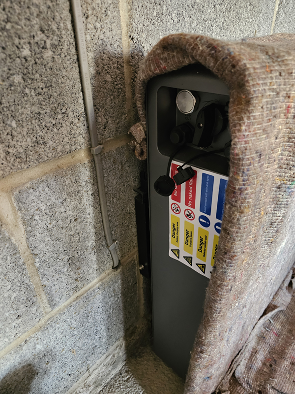

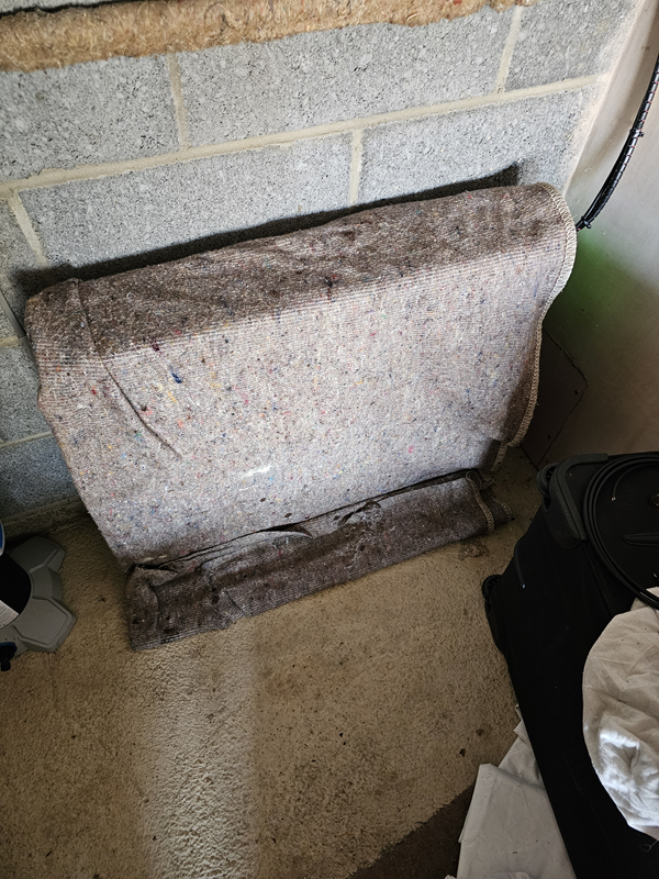

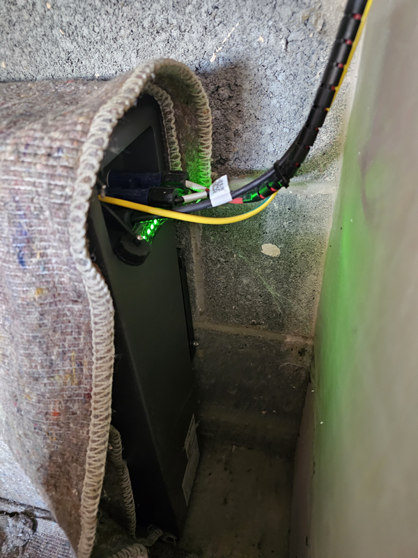

As Dave has said, there is a heating function available (firmware levels permitting) for your battery. Depending on where it is stored, inside or outside the house, you can insulate it and then you won't need as much heating.
Mine is in a garage, and I basically chucked a small blanket over it, taking care not to cover the wires up.

Insulation is going to be your best overall choice vs. heating, with the simple blanket, I no longer needed any battery heating in the garage, outside, it will help keep warmth in (or some posh kingspan!)
