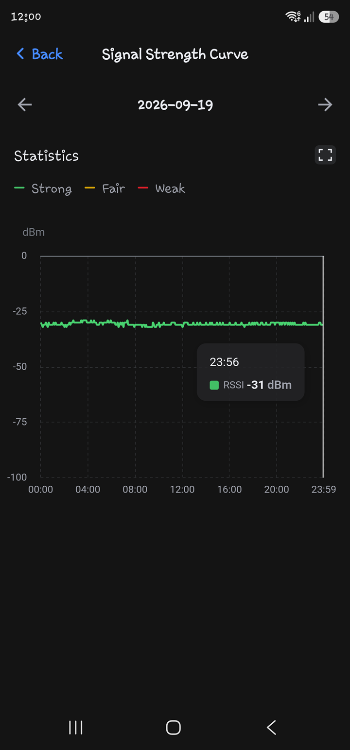

I have also included a wifi signal graph (App ->Device -> Data Logger -> Network Type) so you can check signal strength.

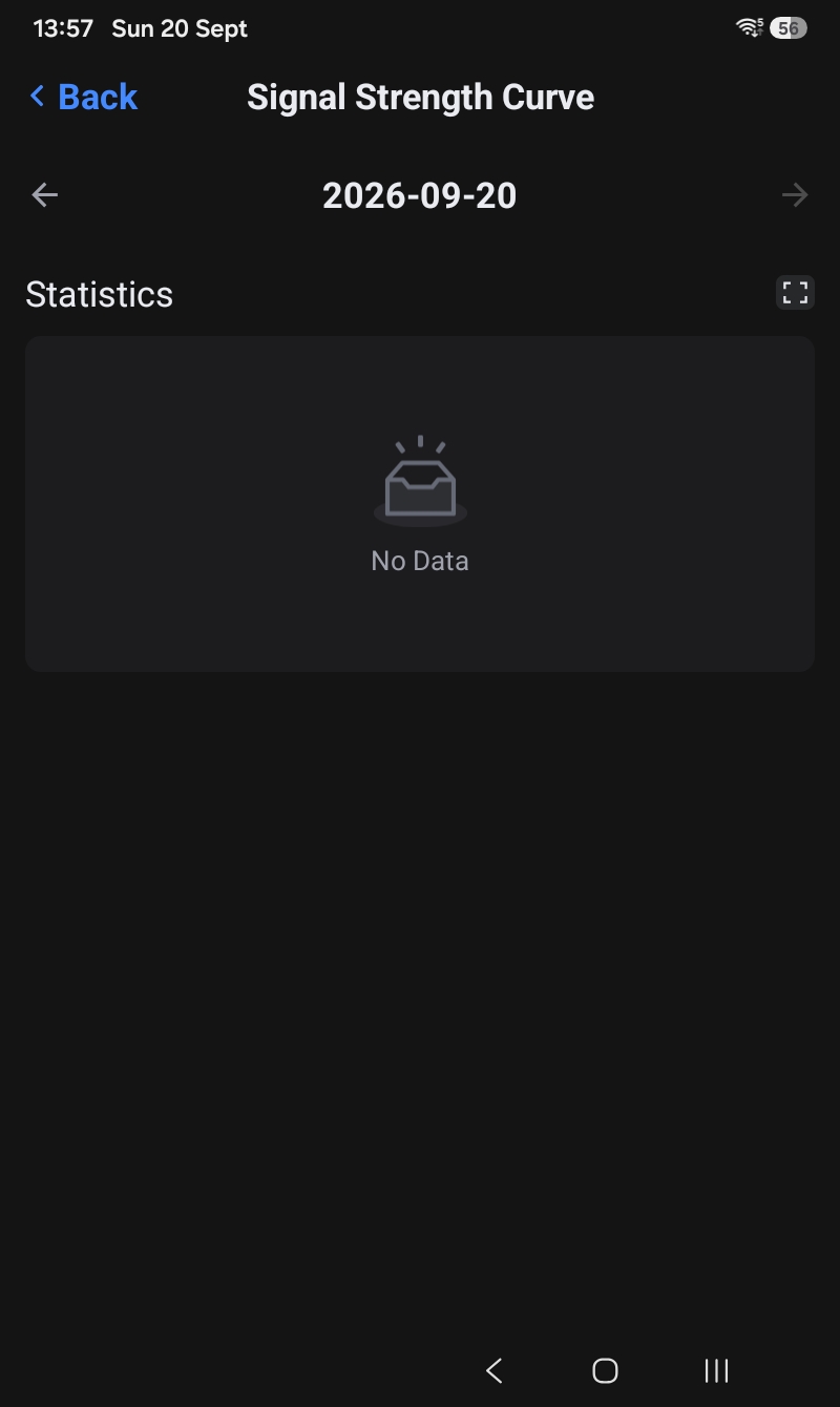

That's interesting, my 5 second update is a bit flaky some days, but I didn't know I could check signal strength seen by the datalogger.
Sadly I just see 'No data' on that page. Maybe down to different datalogger type? Mine is WW.

Hi. Thanks for the reply.
I don’t see a signal at all on that page. Maybe that’s the issue then. I have rebooted my inverter twice now and still no change

I also didn't know you could see that graph until today, there was a billy basic 4 bar strength indicator beforehand for me.
I have data for today, mine is W6.
Not sure why there is a difference, but I guess there are variants for reason know to Fox.
