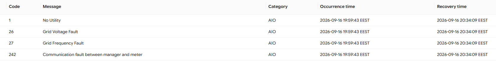

Errors I have for this issue:
Ok, will try to check this video

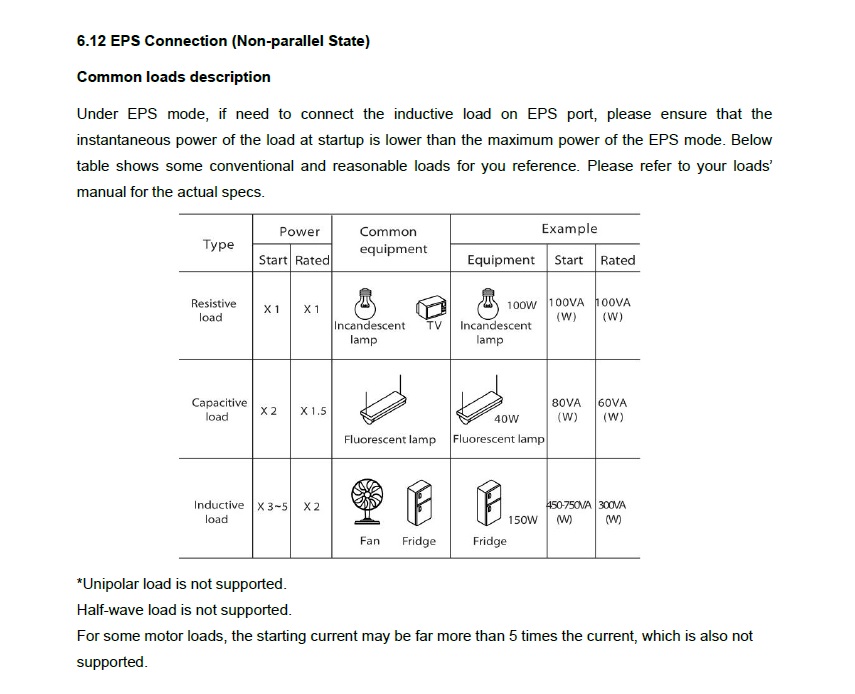

It's difficult to be sure without measuring the load using a high speed scanner to know for sure, a faulty or older pump would have a higher startup current than you see on its rating plate.
Fox publish a table as part of their manual that gives the typical expectations for different loads, for indictive loads such as that you could easily be 5 (or more) times over powered at startup.
An H3-10 would be 3.3kw per phase max and in EPS mode you don't have the grid to fall back to so you would be limited by the EPS maximum current per phase of 14.5A
