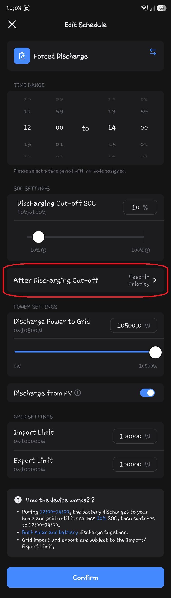

Here is a picture of where you are looking, if you don't have this, then you will need to upgrade firmware as Dave has said.
What it does is wait for your 35% SoC to be reached, then swaps work mode to whatever you specify.
Feed-in if you want the battery to discharge, but not charge up again from solar.
Self-use if you do want the battery to charge from PV/discharge as needed.
