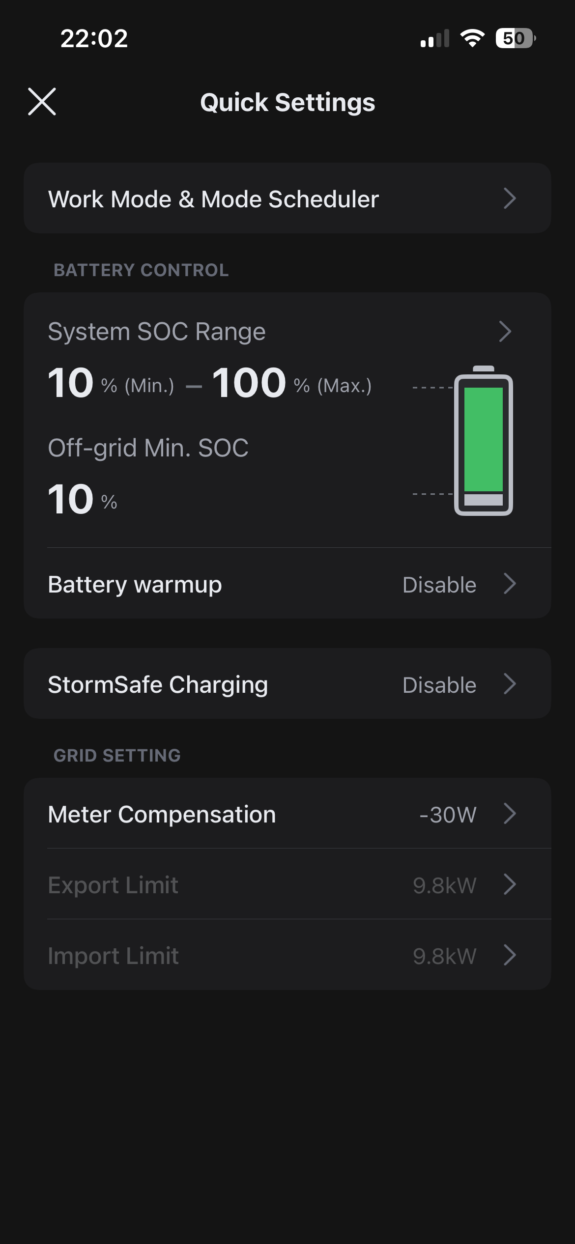

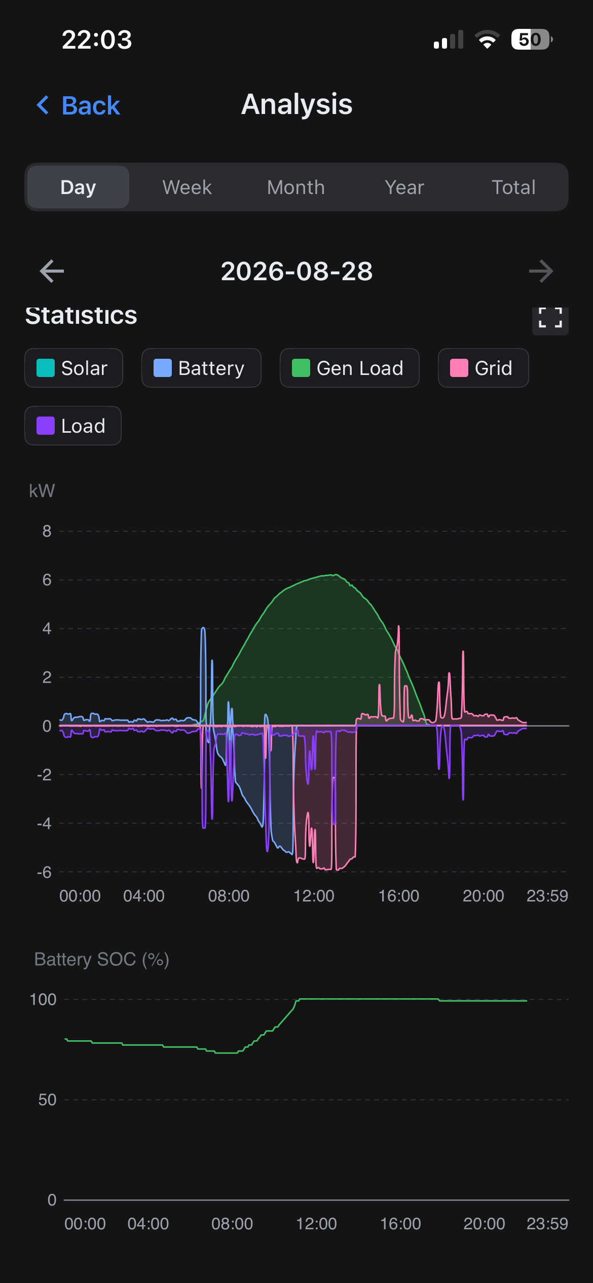

Today after battery is fully charged, error code 26 and 28 popped up. Did a bit research and upped the grid voltage and 10min avg voltage from 230V to 260V.
Hard reboot system and faults cleared, however the inverter is now stuck on “waiting” forever.

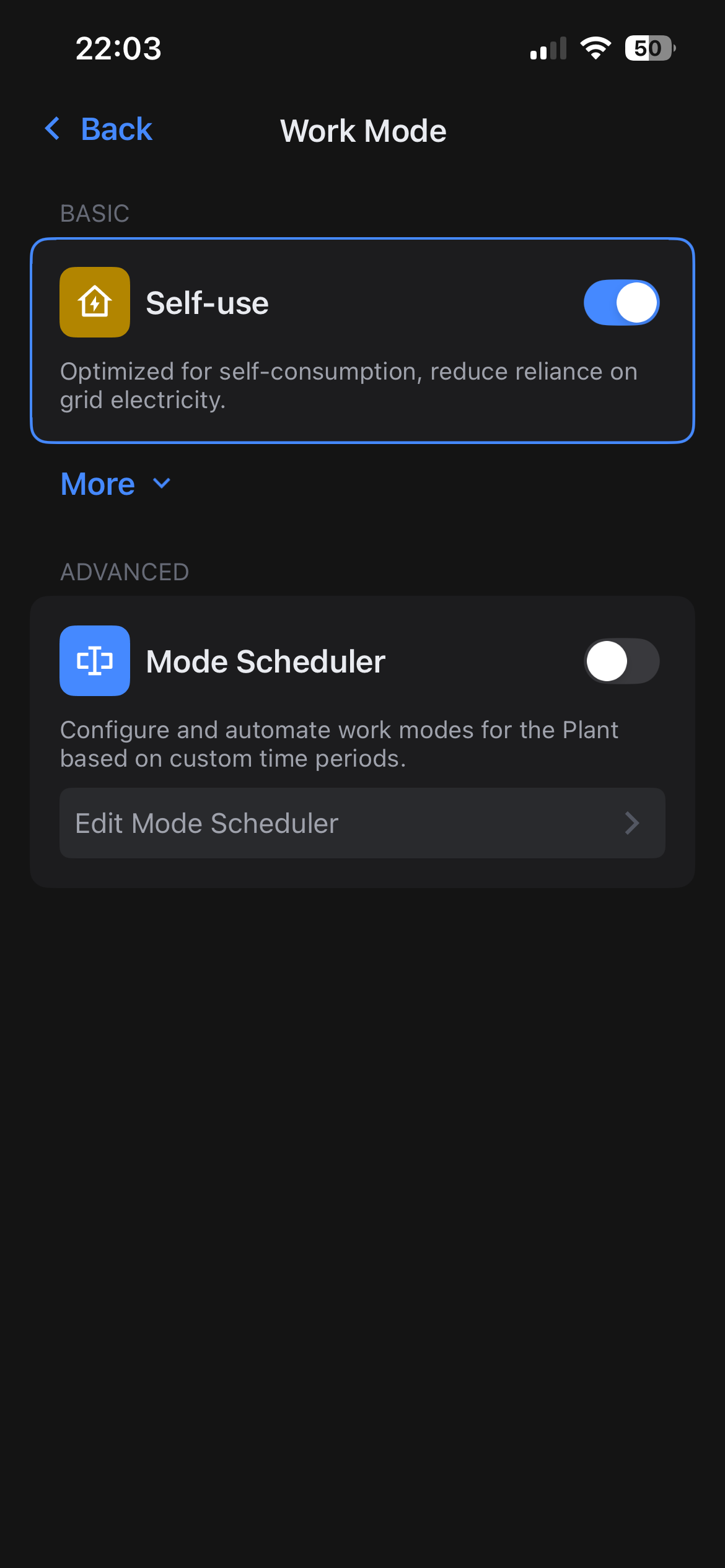

Have checked my settings: self-use no mod schedule. Min SOC 10% Max 100%. Rebooted multiple times.

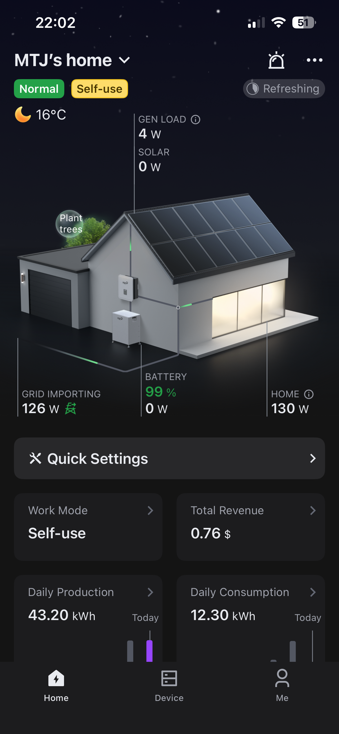

Despite battery being 97%, the inverter is pulling all from grid…. I’m at my wits end.

Thanks for your comments! I waited this morning to check again and it is back to normal now. While I was at panel I heard the inverter made a few noise as the sun come up and it reconfigured itself…does the inverter need solar input to boot up properly? I thought a full battery would have enough juice for that…
