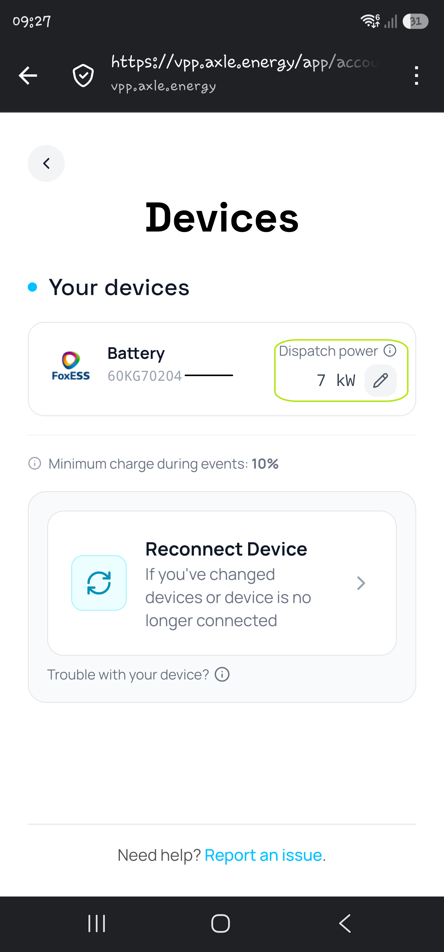

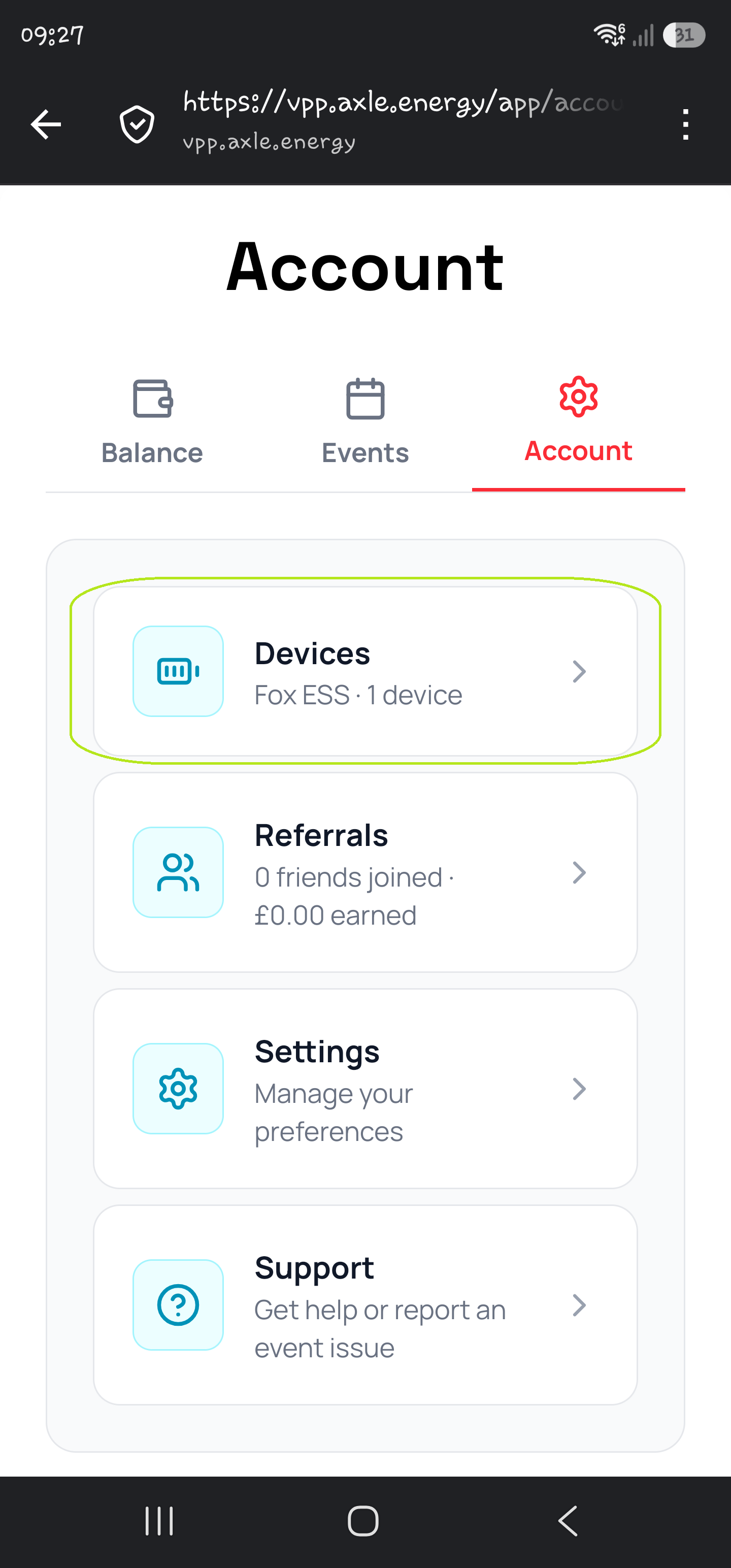

Just checking, is your device 'Dispatch power' set to 7 kW? (it does not matter if this is above your export limit)

Can't see a settings cog on the website but have a section called devices. Under this for battery all I see is Battery Soc, Charging power, min battery temp and charge/discharge energy.
There are many categories under "real time" but still nothing called "Dispatch power"
Edit: I've even tried google and after locating device it says click on battery/inverter system. On mine they are both separate so I've tried both (the battery is the one I tried first time). It then says click on settings or advanced settings. Neither section has that option that I can see.
In fact the only settings (apart from quick settings) I can locate anywhere are for my personal details.

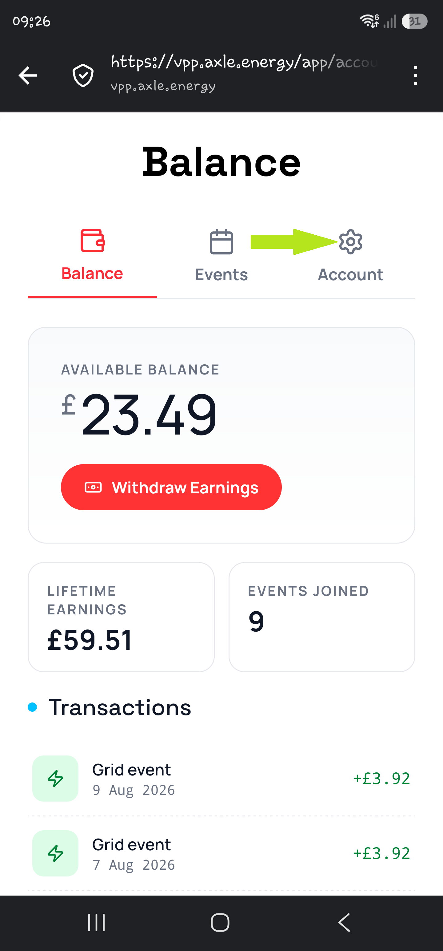

Ah, we were at cross purposes. I was looking at the fox website, not the axle one.
It is set to 7KW.
