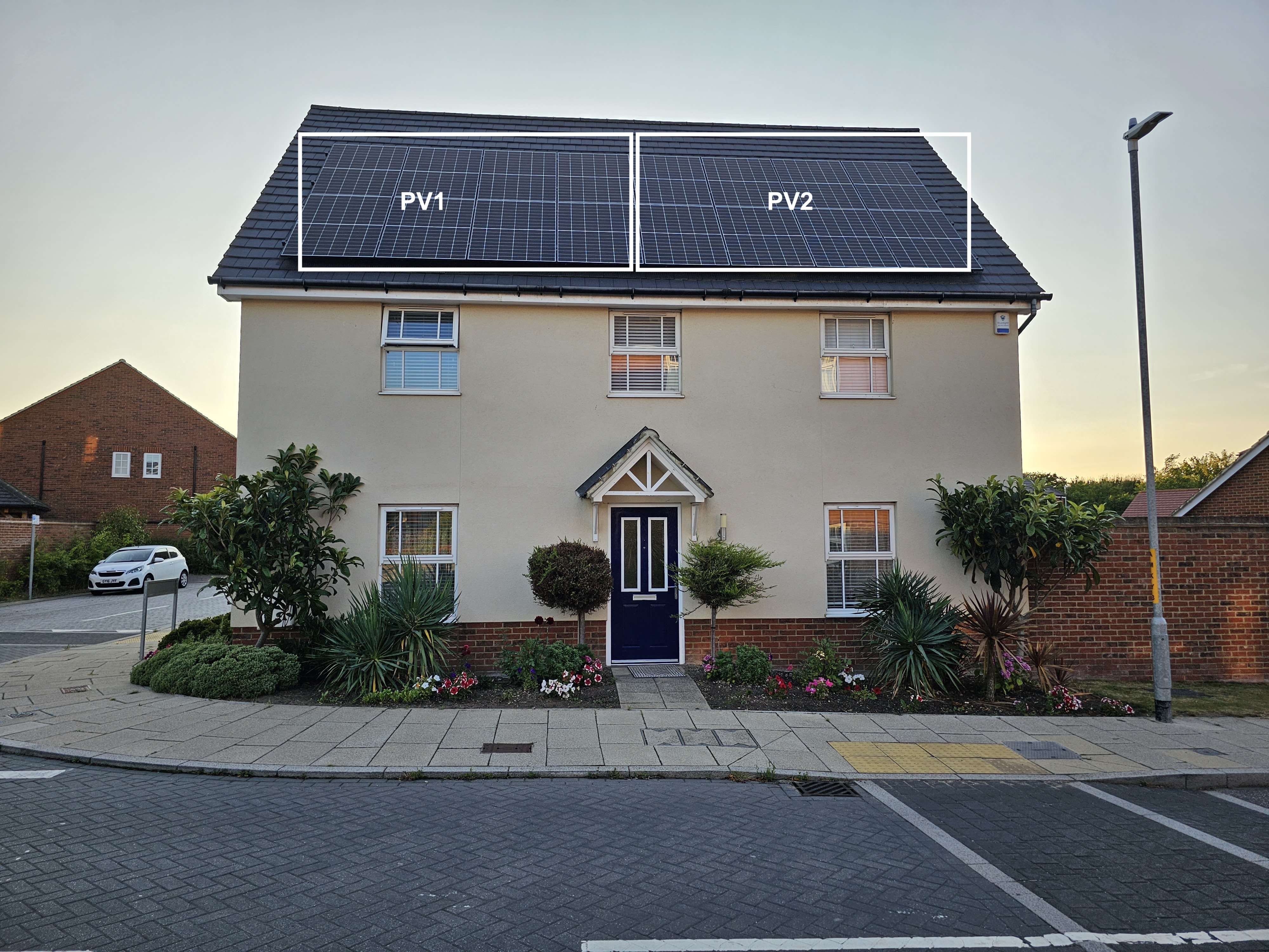

Thank you very much for your reply. This is where I'm not up too speed on a terminology yet. Do you mean PV1, PV2 etc? If so, this is how my installer said PV1 and PV2 are split and the same is on the other side of the house:

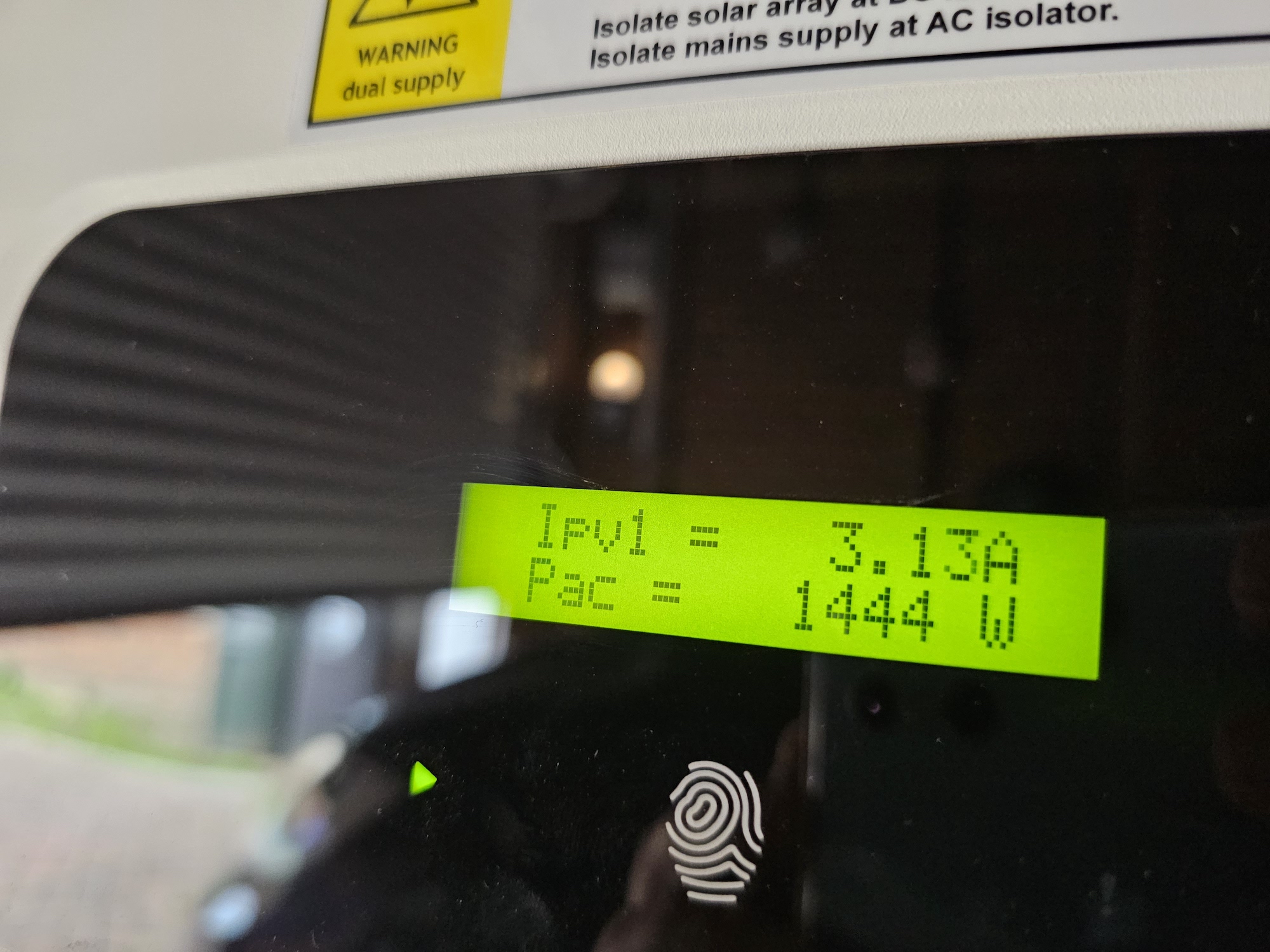

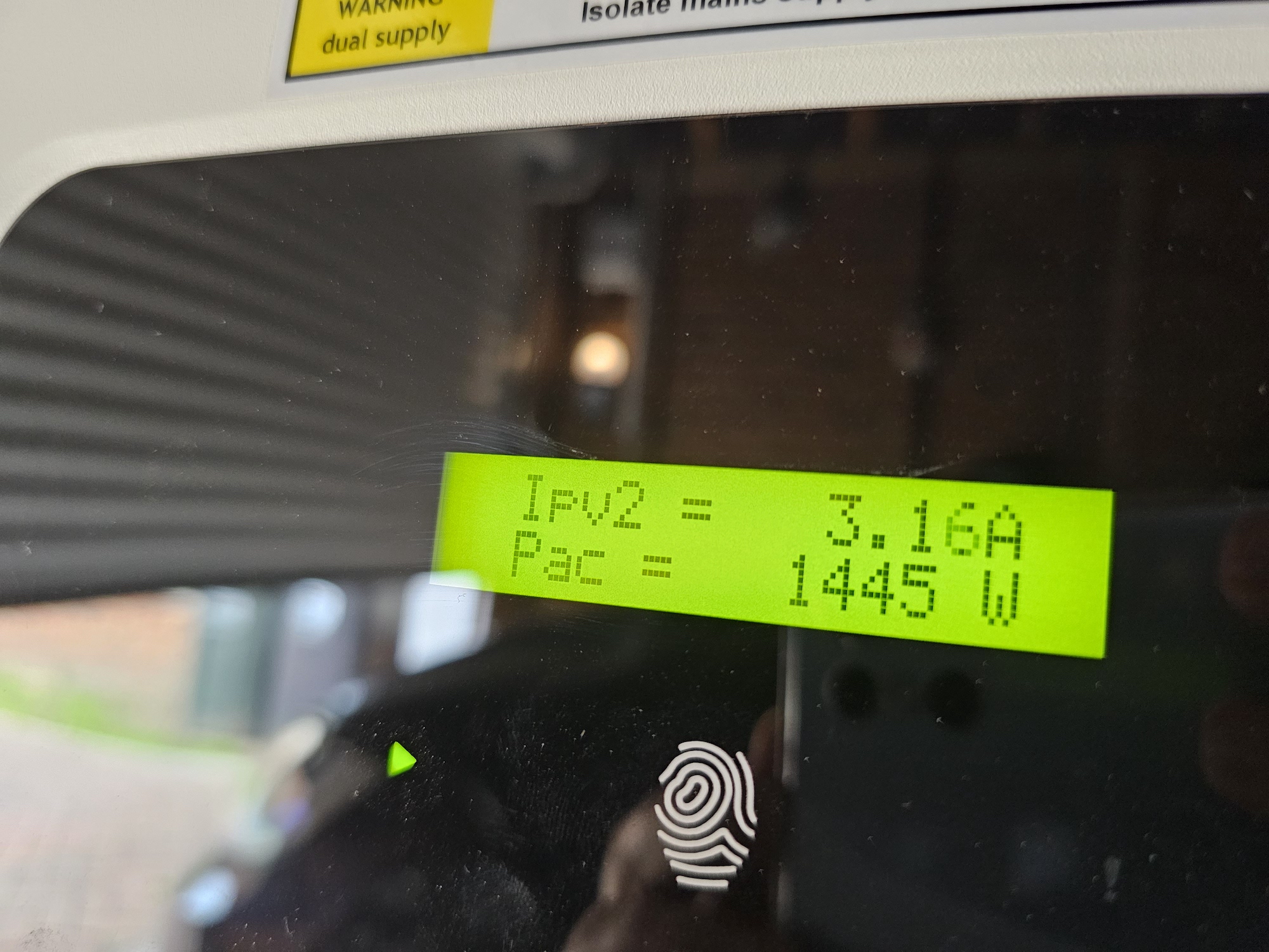

Both inverters have 4 cables going into them.
H1 (WNW array):
And its readings:
F6000 (ESE array):
And its readings:
Also my thinking that something is throttling the output got even stronger today. Yesterday when the sky was clear, F6000 (ESE) was already pulling 5kW+ by 9am. H1 (WNW) didn't reach 1kW until 11.50am. Today was mostly cloudy, especially in the morning so F6000 was fluctuating between 2kW and 4kW until about 10.30am while H1 was already pulling 1kW+ by 9.15am, fluctuating between 1kW and 1.30kW. After about 10.40am as the sky become a little clearer, F6000 started pulling above 5kW and H1 output went down to 0.5-0.8kW until almost midday (once F6000's output started declining).
