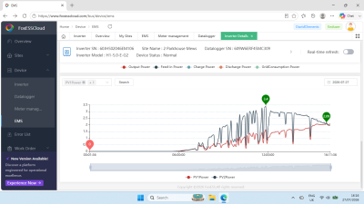

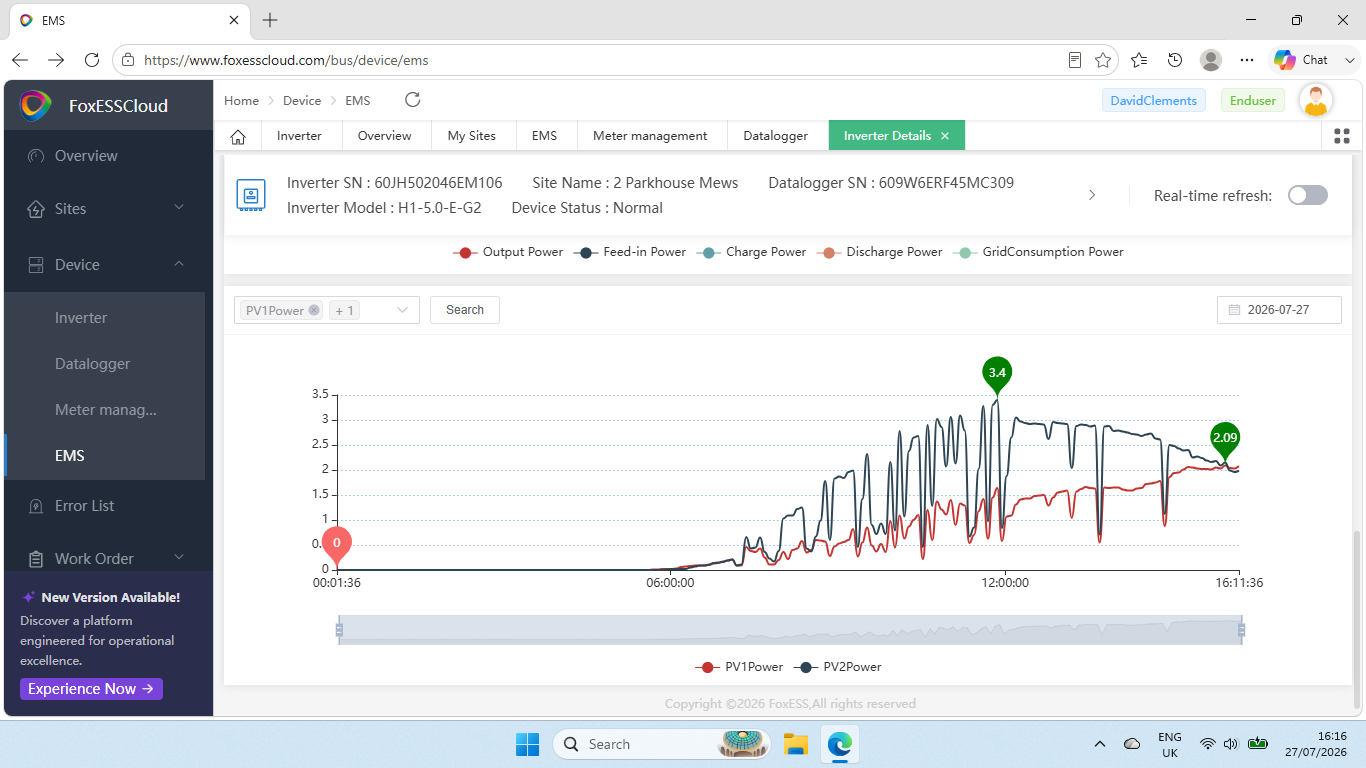

Please could someone look at my PV1 AND PV2
The question is should there be this much spiking.

It does look like standard clouds flying over to my eyes.
How does it compare to a few days/weeks back on a perfect sunny day?

ok I will look up data from a hot sunny day
