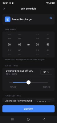

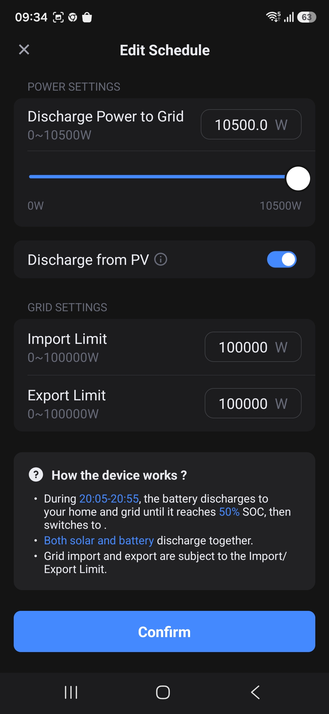

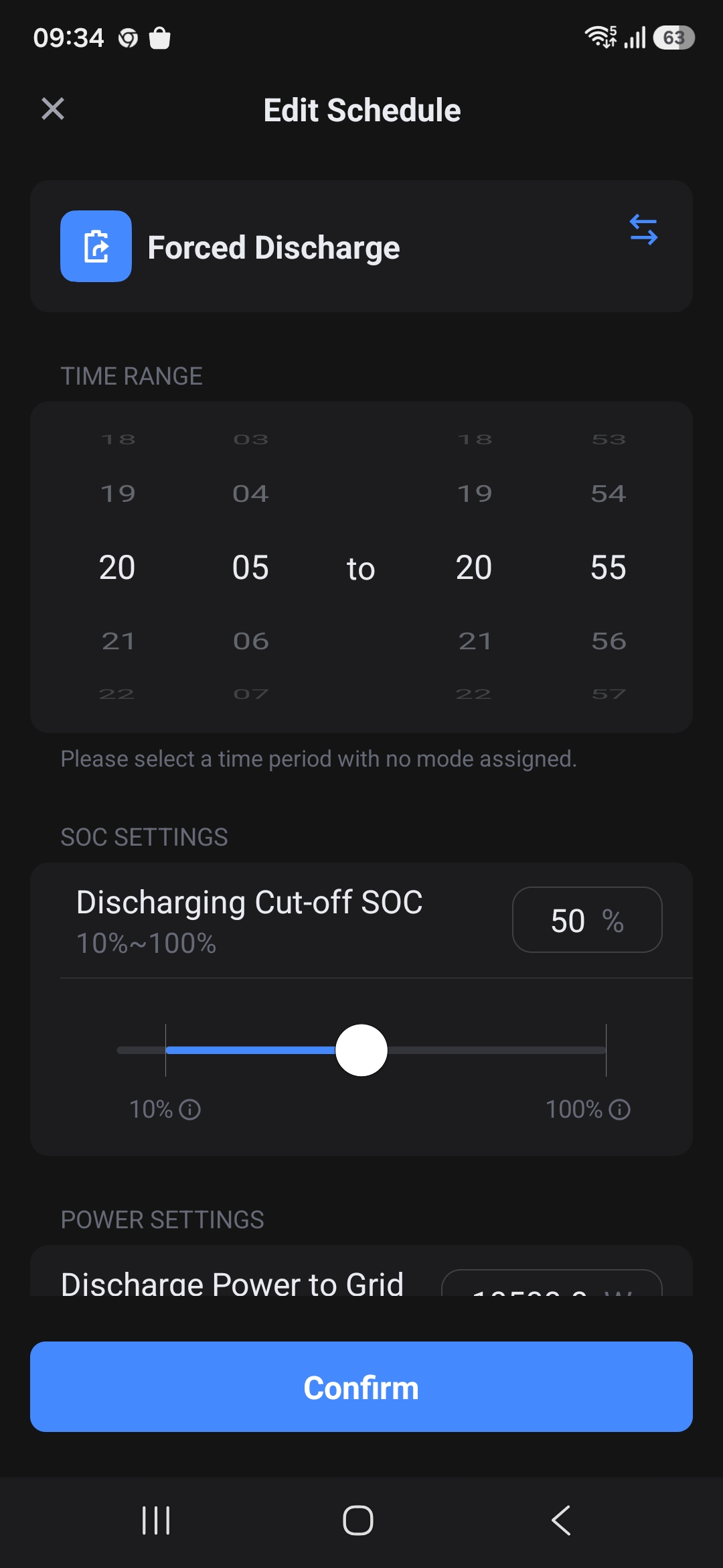

Do you have a picture of your export schedule?
Or can you make one and post it in full?
Re: No solar generation during export
MaterialBarracuda48 wrote: Sat Jul 18, 2026 9:31 am Do you have a picture of your export schedule?
Had to learn how to do this. A bit cack handed with the button press combination but here goes.
