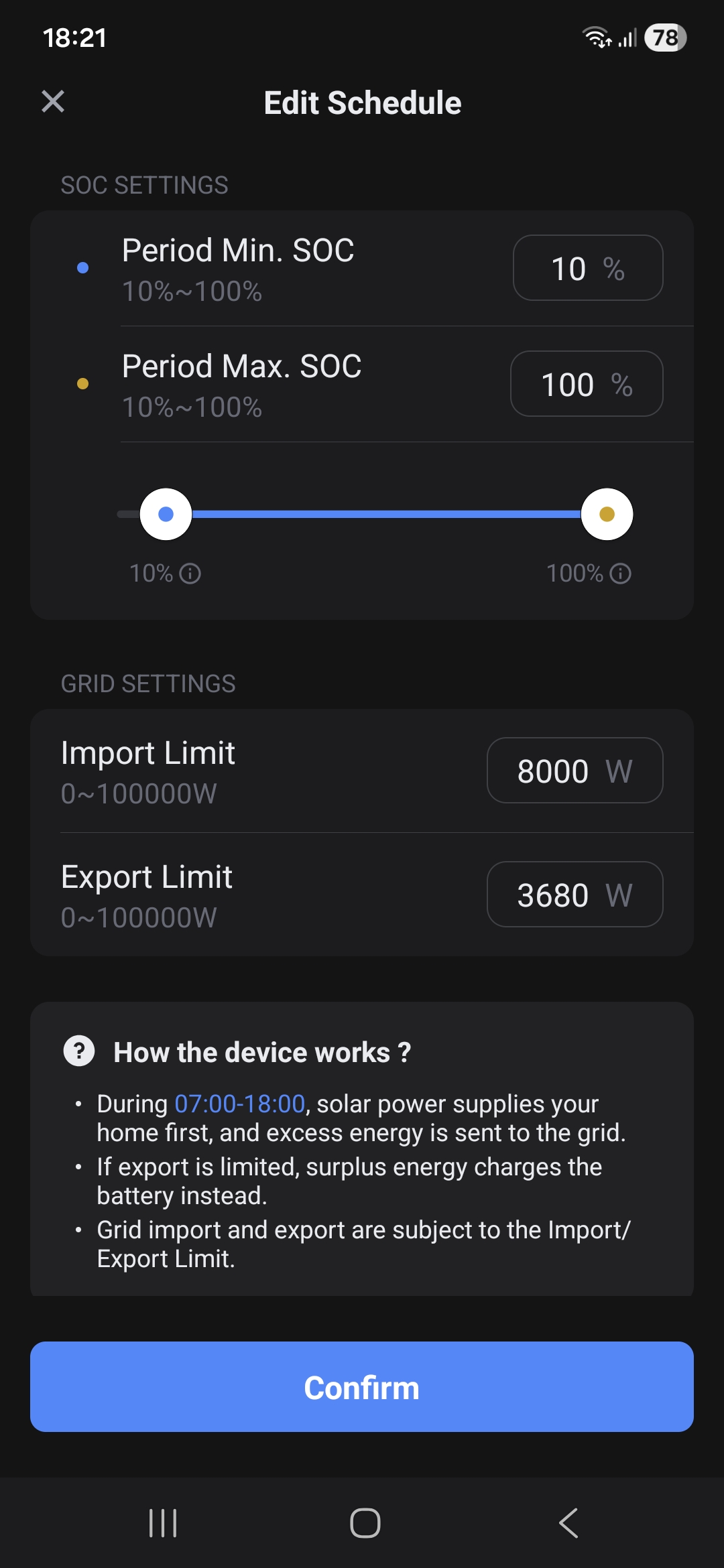

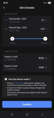

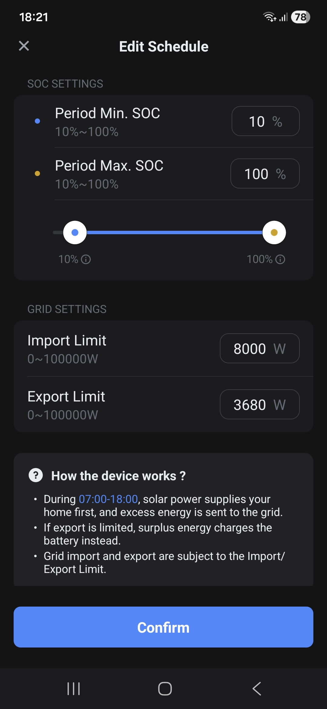

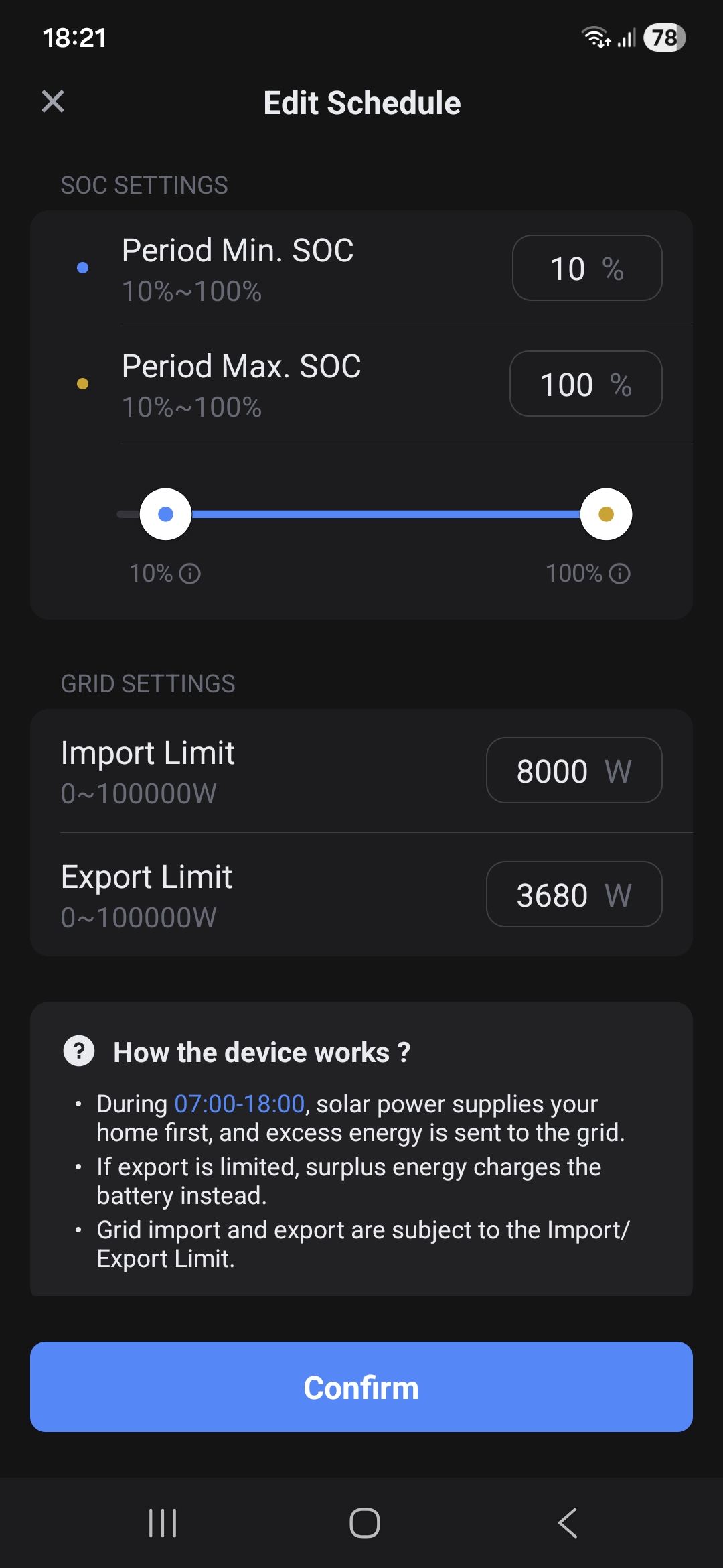

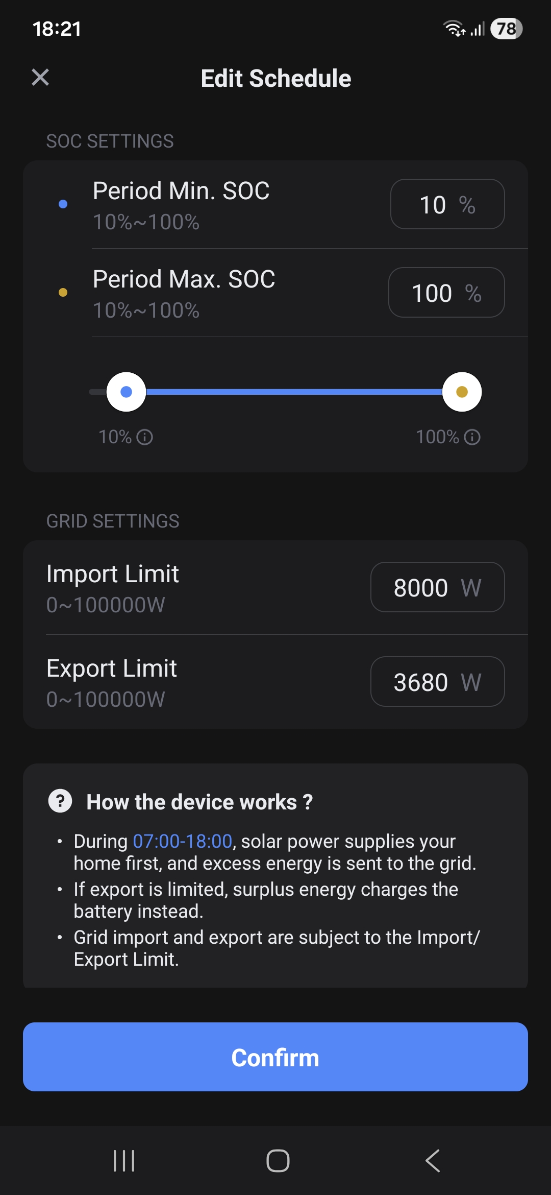

Just to let anyone interested know, I just checked the app and you can now adjust the export limit in Feed In Prioity mode!
Thanks Fox!!
Thanks Fox!!
Scroll down in the mode setup page, it's at the bottom....
I hope I've actually attached the image....!
I was just checking, as Feed-in work mode has no settings.
It does have settings in the advanced scheduler, and welcome addition.
