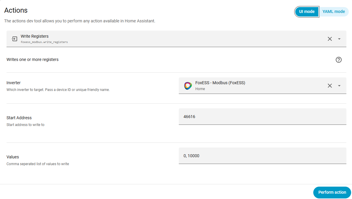

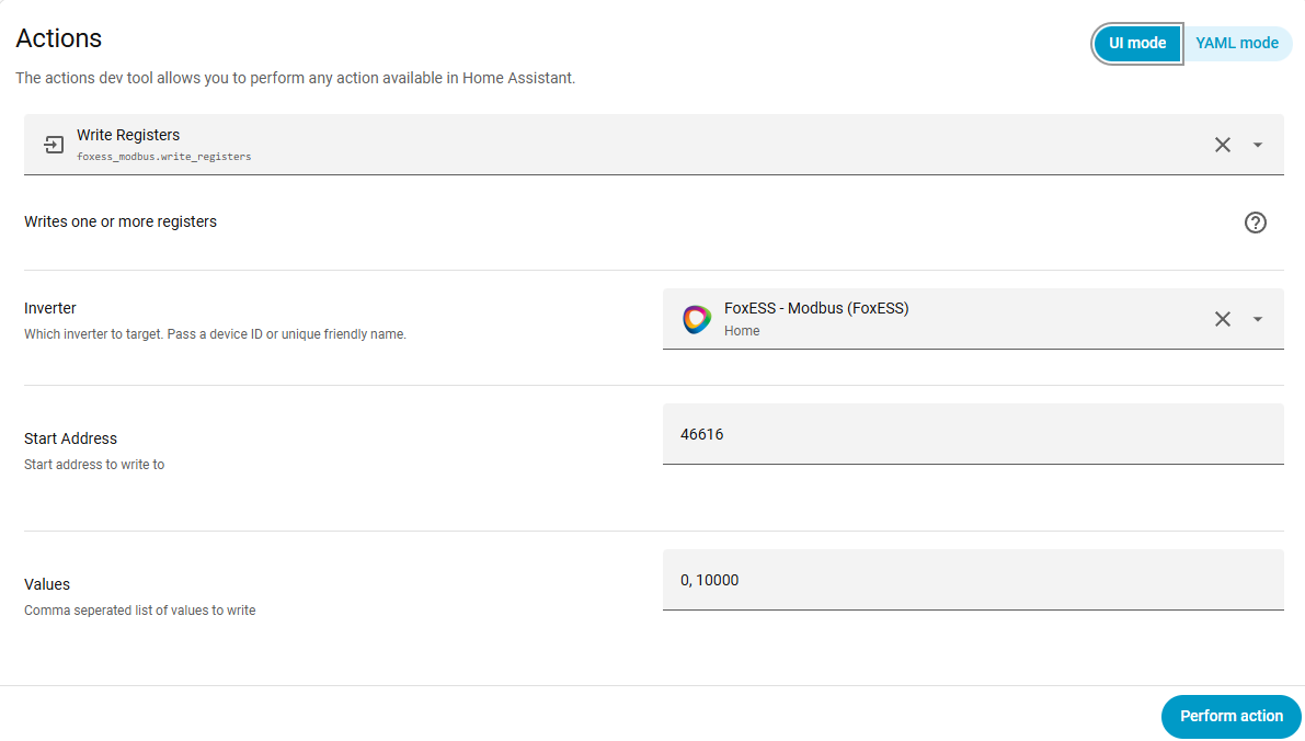

If anyone is coming back to this now, I'm not sure if its due to updates but I'm just using the "nathanmarlor" foxess modbus integration v1.15.0b1.
If I use write registers to 46616 with Values "0, 10000" it will write successfully.

Re: H3-15-Smart Modbus Export Control
joeloosth wrote: Thu Jul 09, 2026 8:36 am If anyone is coming back to this now, I'm not sure if its due to updates but I'm just using the "nathanmarlor" foxess modbus integration v1.15.0b1.
