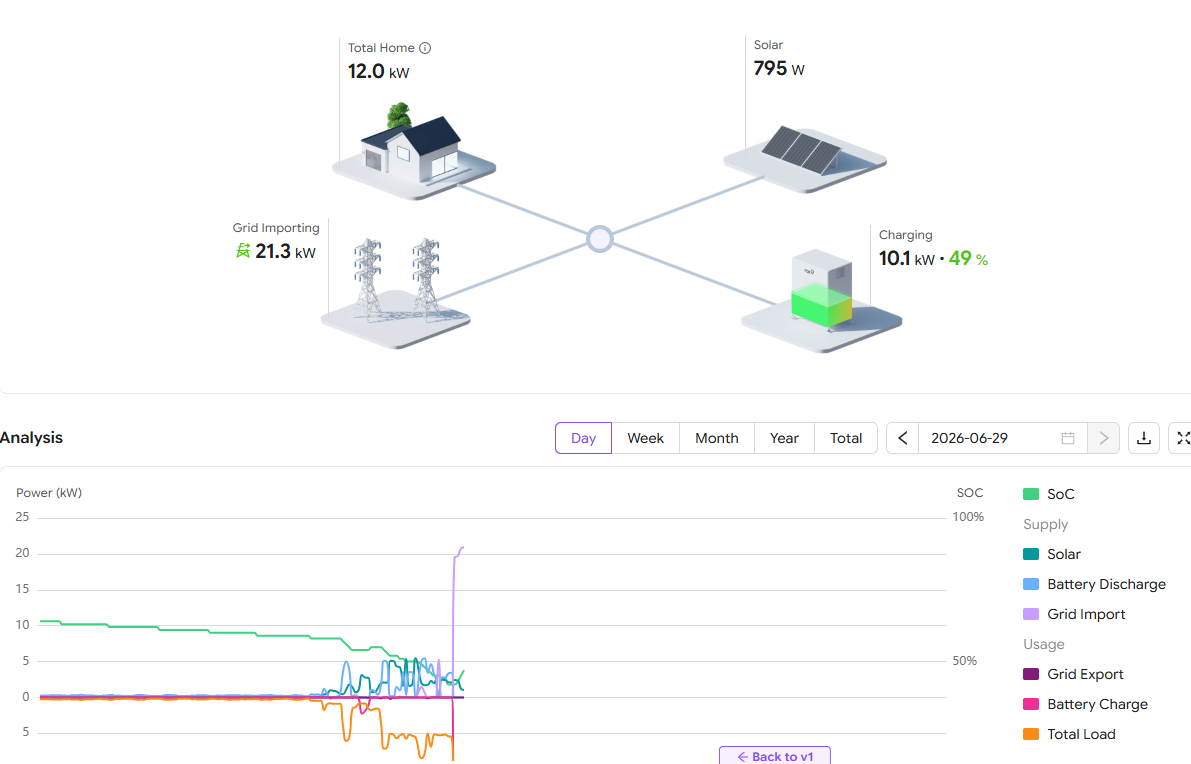

During a force charge, the battery won't pull its full rate whenever there is significant house/EV load. It behaves exactly as if total grid import is capped at around 11 kW, with the battery only taking whatever is left under that ceiling.
The relationship holds across every reading I've taken (battery charge = grid import + solar − house load):
High house load: Home 10.3 / Solar 2.87 / Battery 4.12 / Grid import 11.5
Medium house load: Home 8.12 / Solar 2.84 / Battery 5.48 / Grid import 10.8
Low house load: Home 1.44 / Solar 2.13 / Battery 10.1 / Grid import 9.4
That last line is the key one. When the house load dropped right off, the battery immediately jumped to its full ~10 kW and grid import was only 9.4 kW — i.e. the battery reached its own DC limit before the import ceiling even came into play. So the hardware can clearly do full rate. It's only throttled when house + EV load is high, in a way that holds total grid import at ~11 kW.

Re: H3-10.0-Smart force-charge throttled — total grid import seems capped at ~11 kW, can't find the setting
So before I got around to doing a support ticket... I waited one more day.
I'll put this down to one of two things.
1. There were settings that needed to be updated
2. You can't do it in the Work mode time, ie if its 11:30am and the work mode that you are changing starts at 11am, there will be no update to the inverter during that time.
So its now doing what I expected, according to the settings, it just didn't take for the day I sent this. And the following day I didn't plug the car in, so it wasn't until today that I replicated the situation.
Thanks again to those who responded. A simple lesson learnt.
