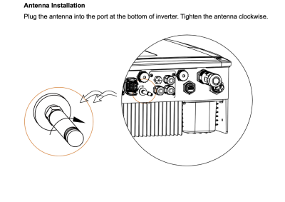

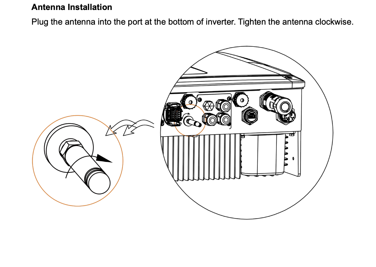

First check your installer has fitted the WiFi antenna on the underside of the inverter.
If it has been installed and the connector for it is a standard reverse-SMA connector then you could either try a different antenna or use an extension cable to re-locate it slightly away from the inverter. Just make sure the connections are weatherproofed if outdoors.
TBH the positioning of the antenna on the inverter is not ideal as there is bound to be some shielding of the signal due to all the other cables that area. Even with the external dongle on a G2 I'm seeing 20dB difference in signal level between the inverter and that from a Zappi EV charger three feet away.
