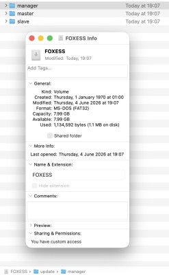

Any chance you could send me master v 1.60 for KH10.5 I can put on a usb stick and update myself tonight?
I just need to know the folder structure / names inverter is looking for and the file. My manager was not updated so still 1.58 and my slave is 1.02.

I was now offered 'slave' 1.03 in my app, so I did that to be all on the latest.
My battery versions are old though and Fox support said several attempts to update failed. I'd like to get these all on USB so I can have them as rollback sources for the future, and maybe I can get the battery versions newer also.
