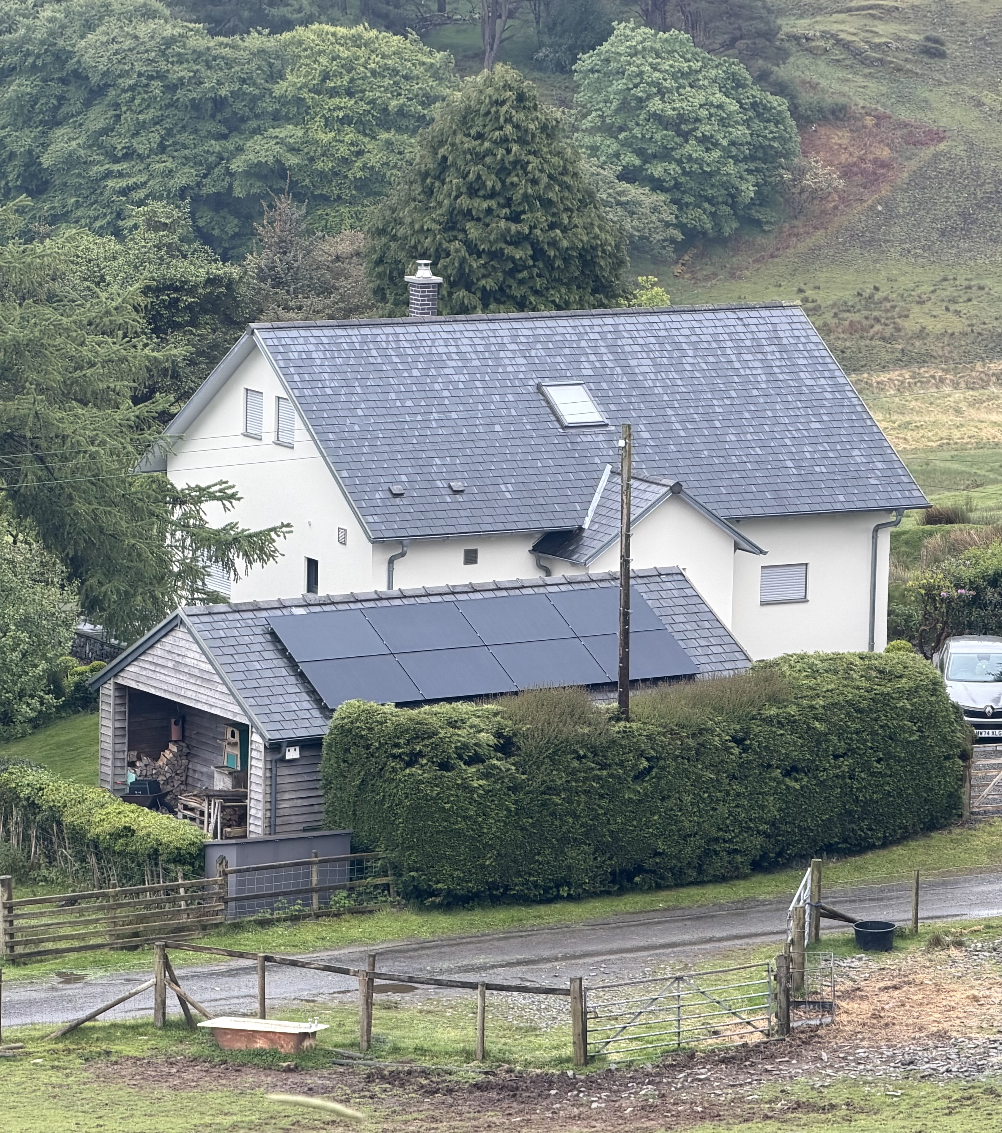

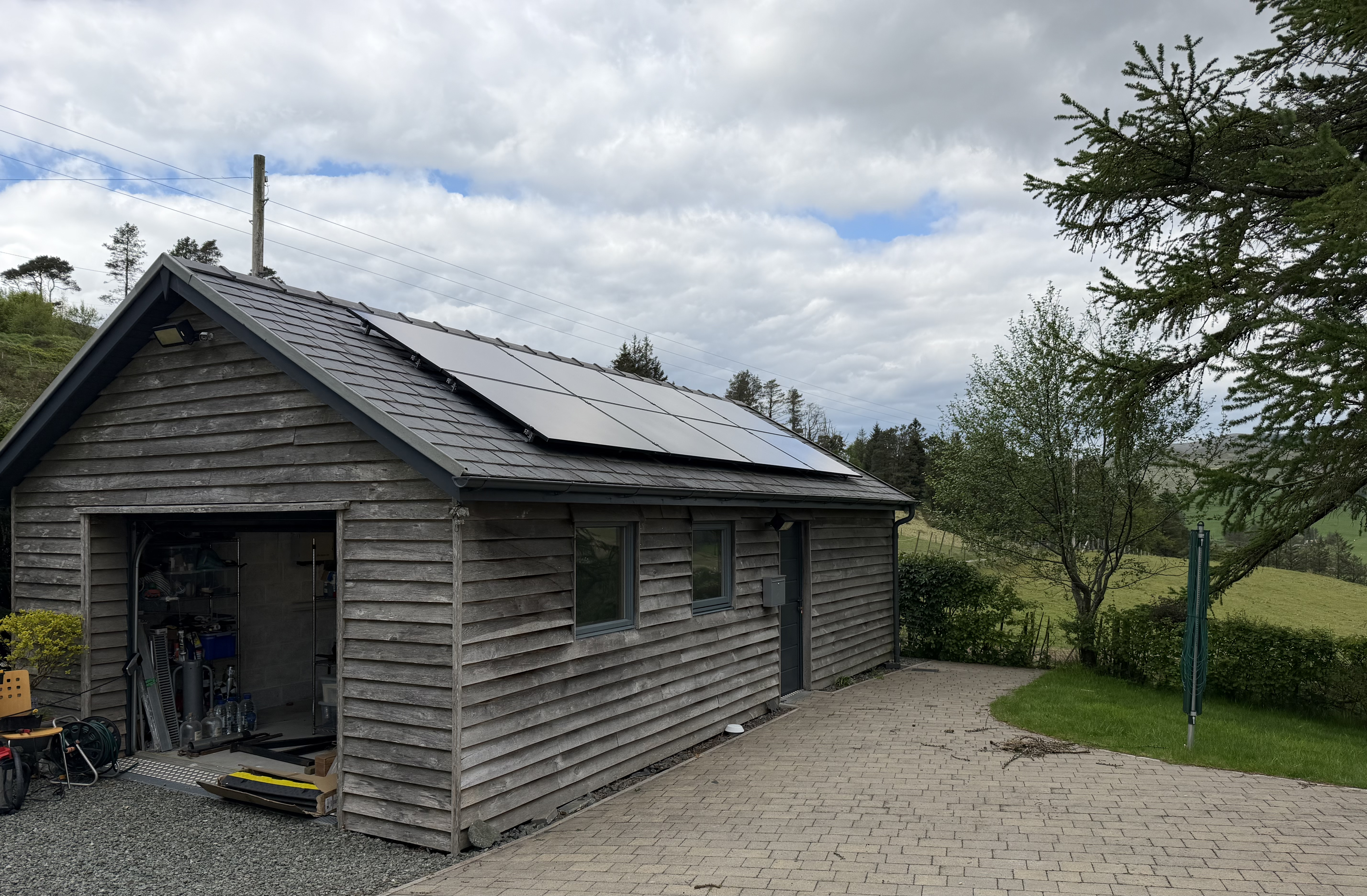

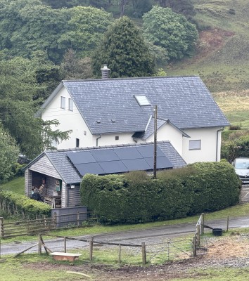

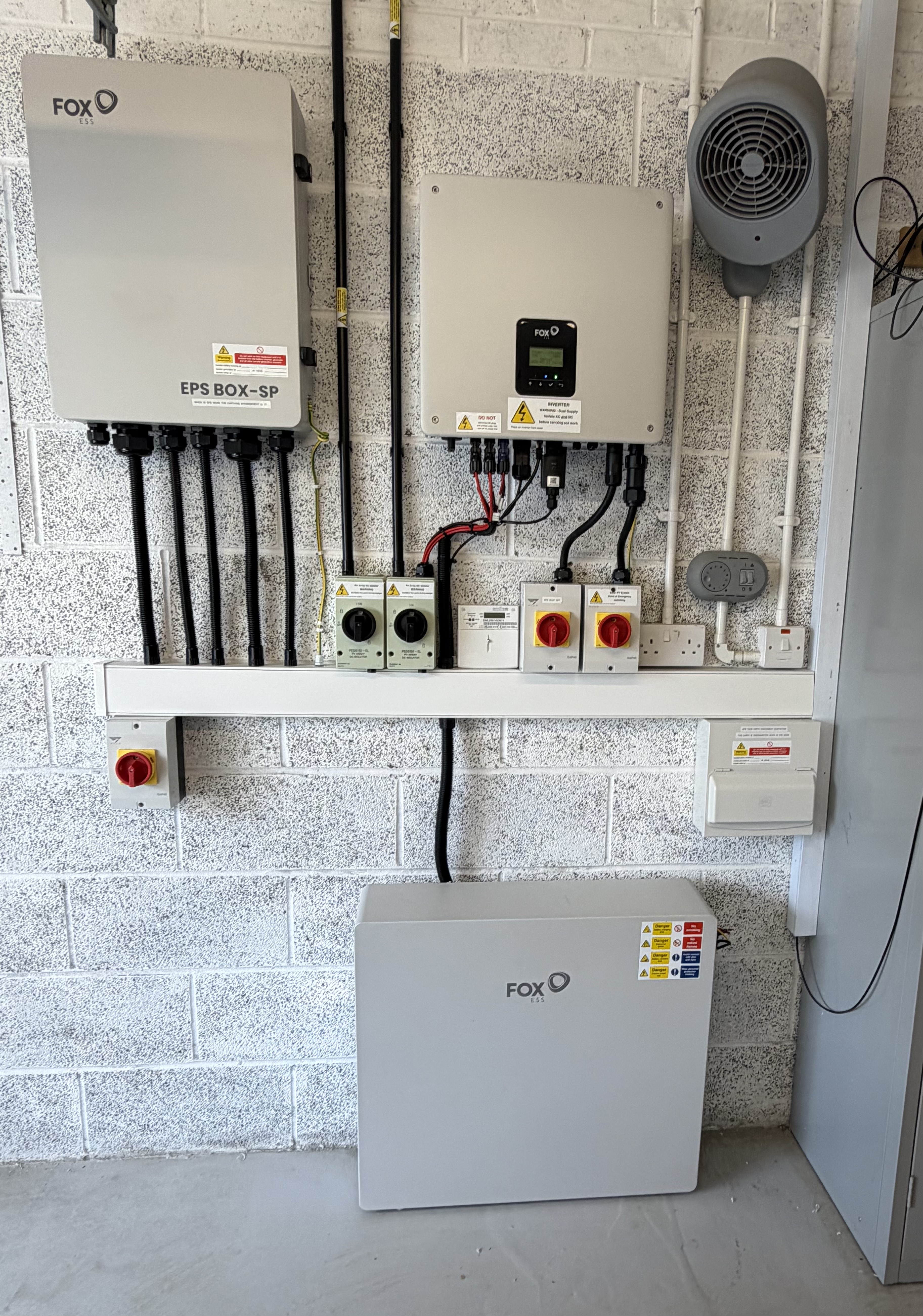

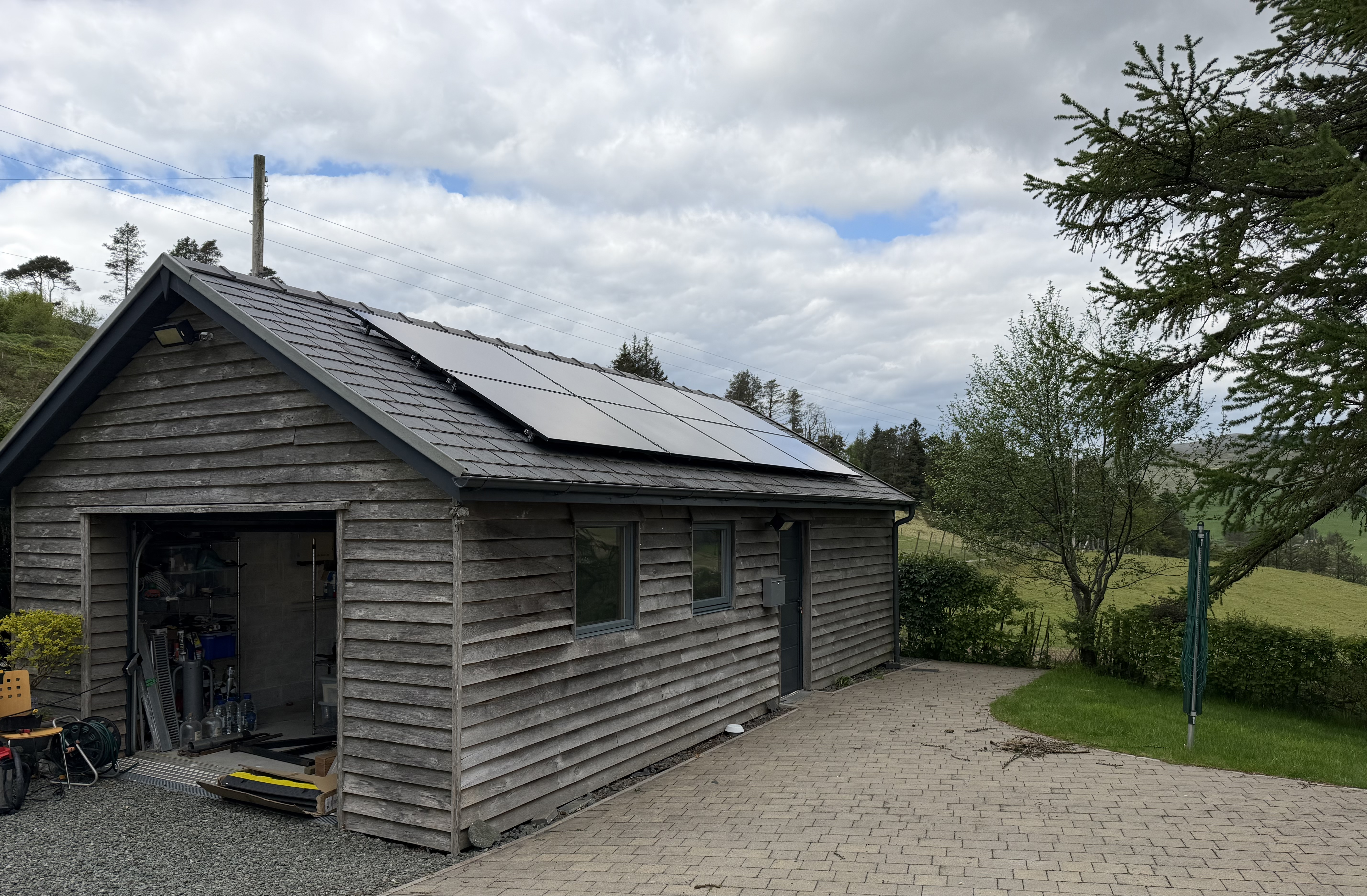

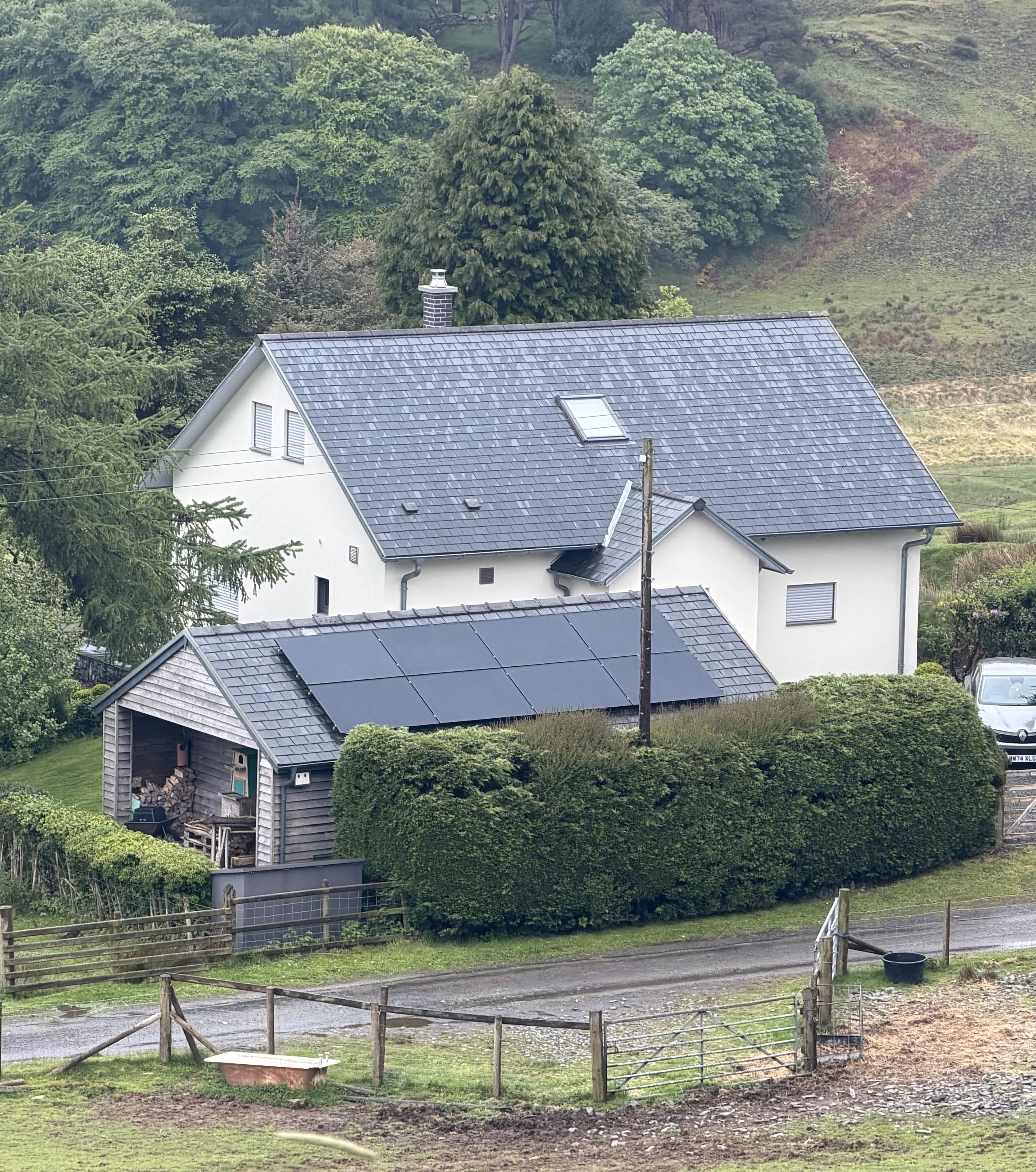

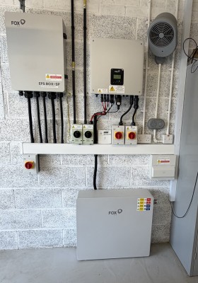

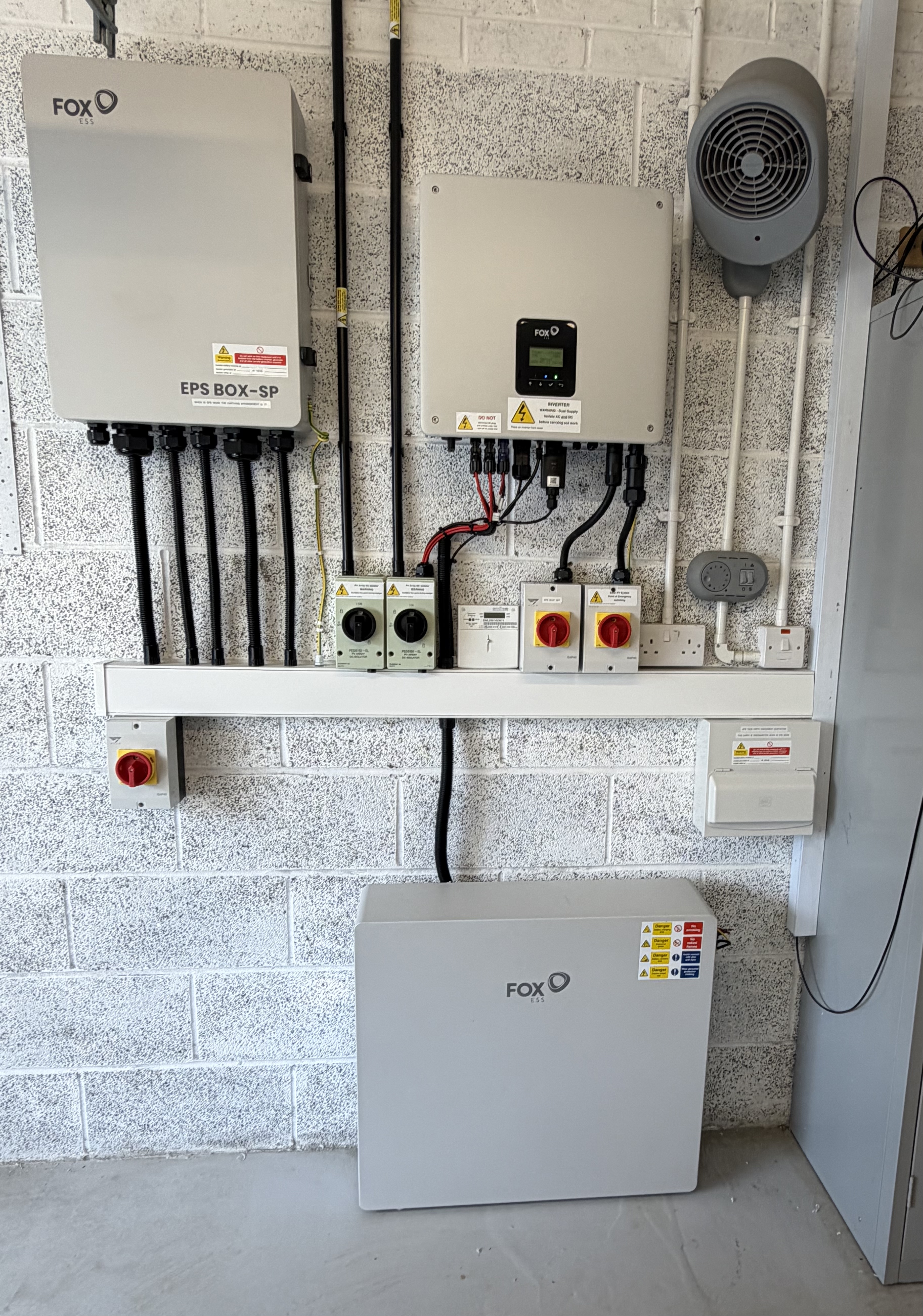

Install in West Wales, 16 x Aiko 465w, H1 6.0, EP12 & EPS Box
Recent completed installation.
We managed to get the whole 6kw export agreed with DNO.
A bit of headscratching with the earthing but have a good workaround to detach the grid TNCS earth when running in EPS mode.
