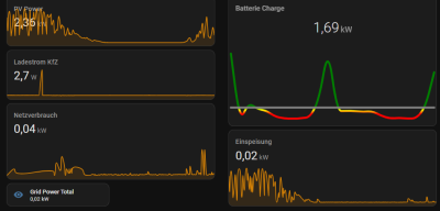

I can confirm the CT values are correct. After my changes it worked as asumed.
But also I see that the Inverter gets power from grid while exporting on the other hand.
With HASSIO and FOXESS integration you can monitor this behavior. The screenshot shows importing 40W from grid while exporting 20W.
These values are not high level but somtimes they are.
I expect 0W import if there is enough PV power.

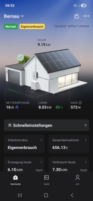

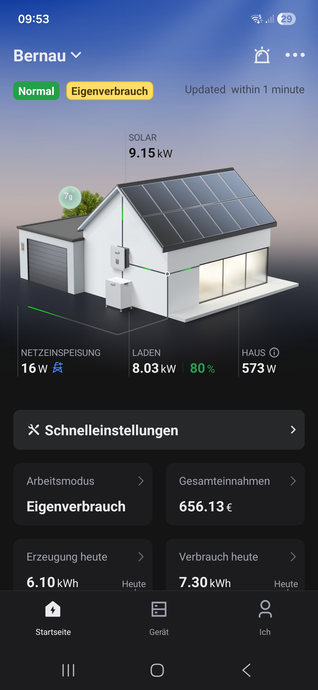

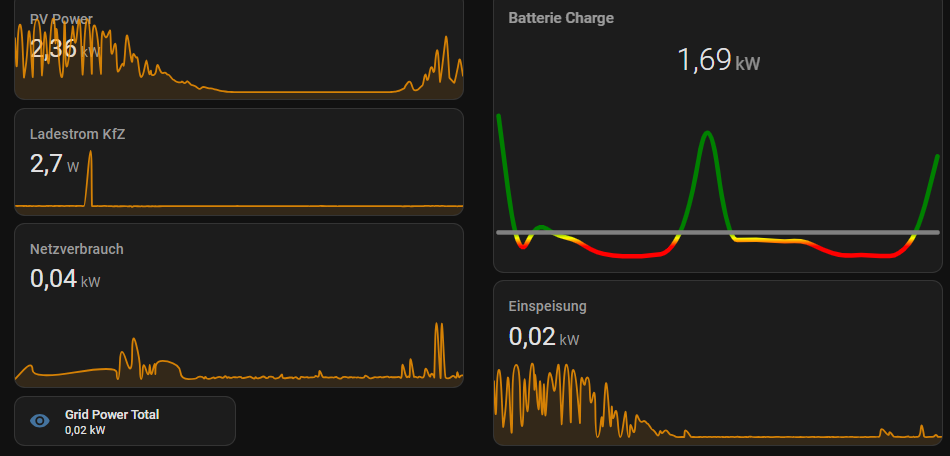

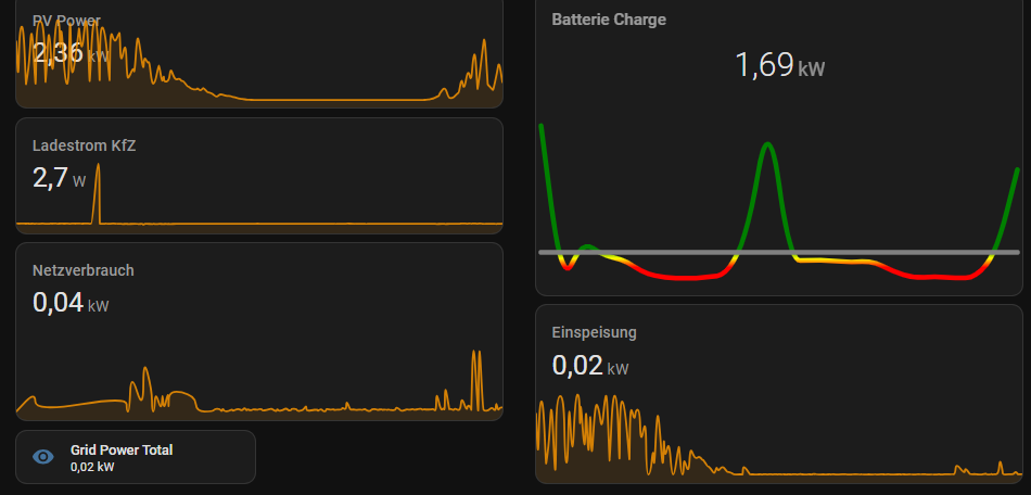

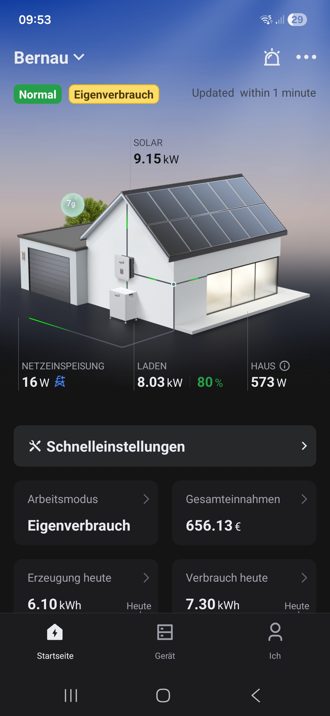

FoxCloud confirms this as well. In this case the inverter consumes 16W from grid while producing 9.15kW --- WHY?
