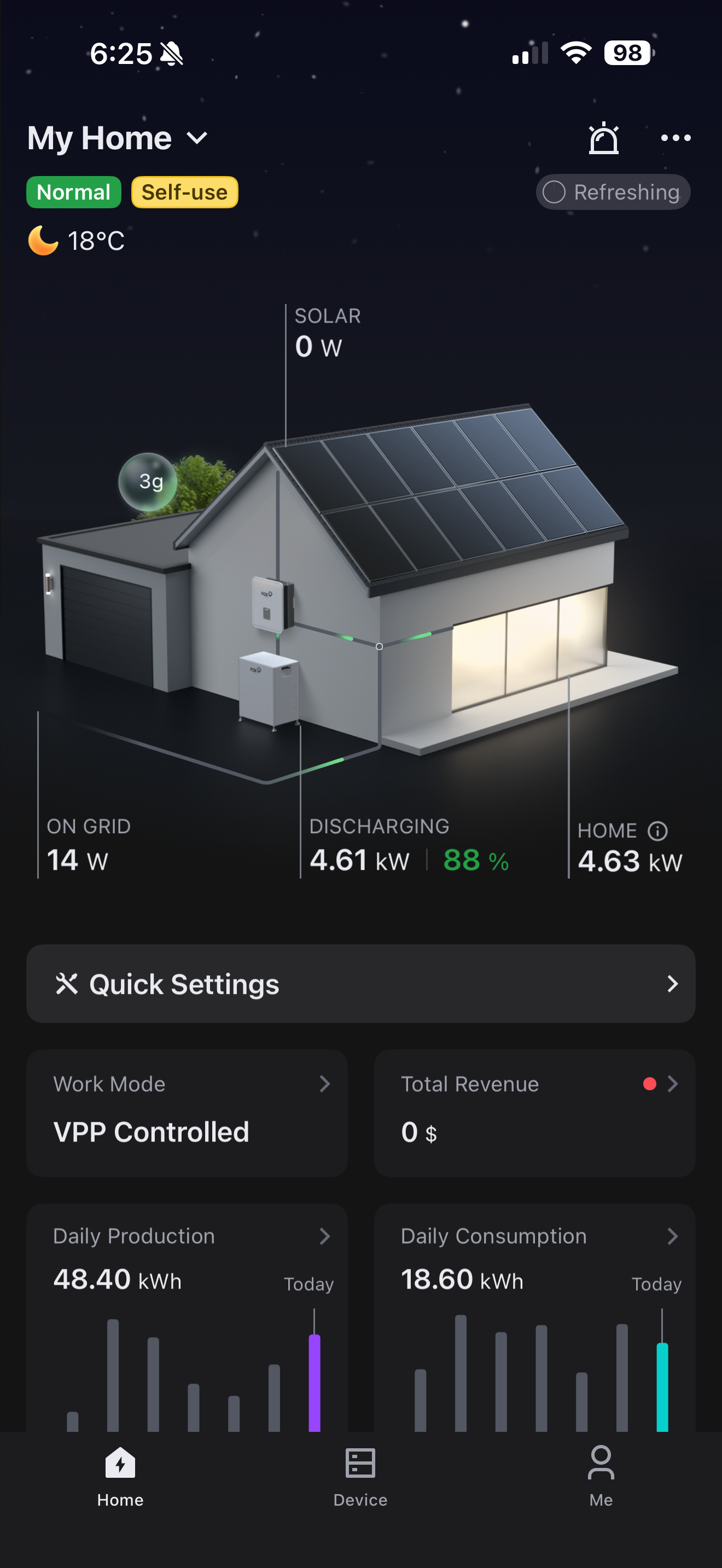

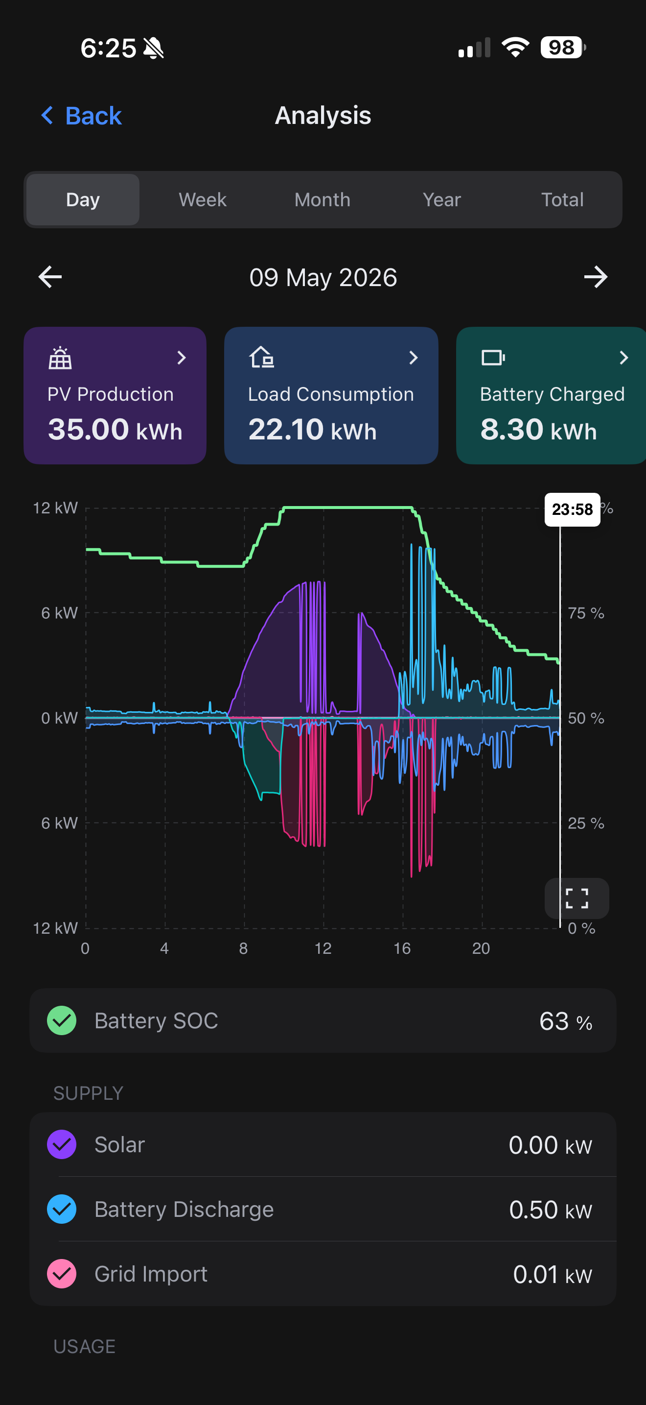

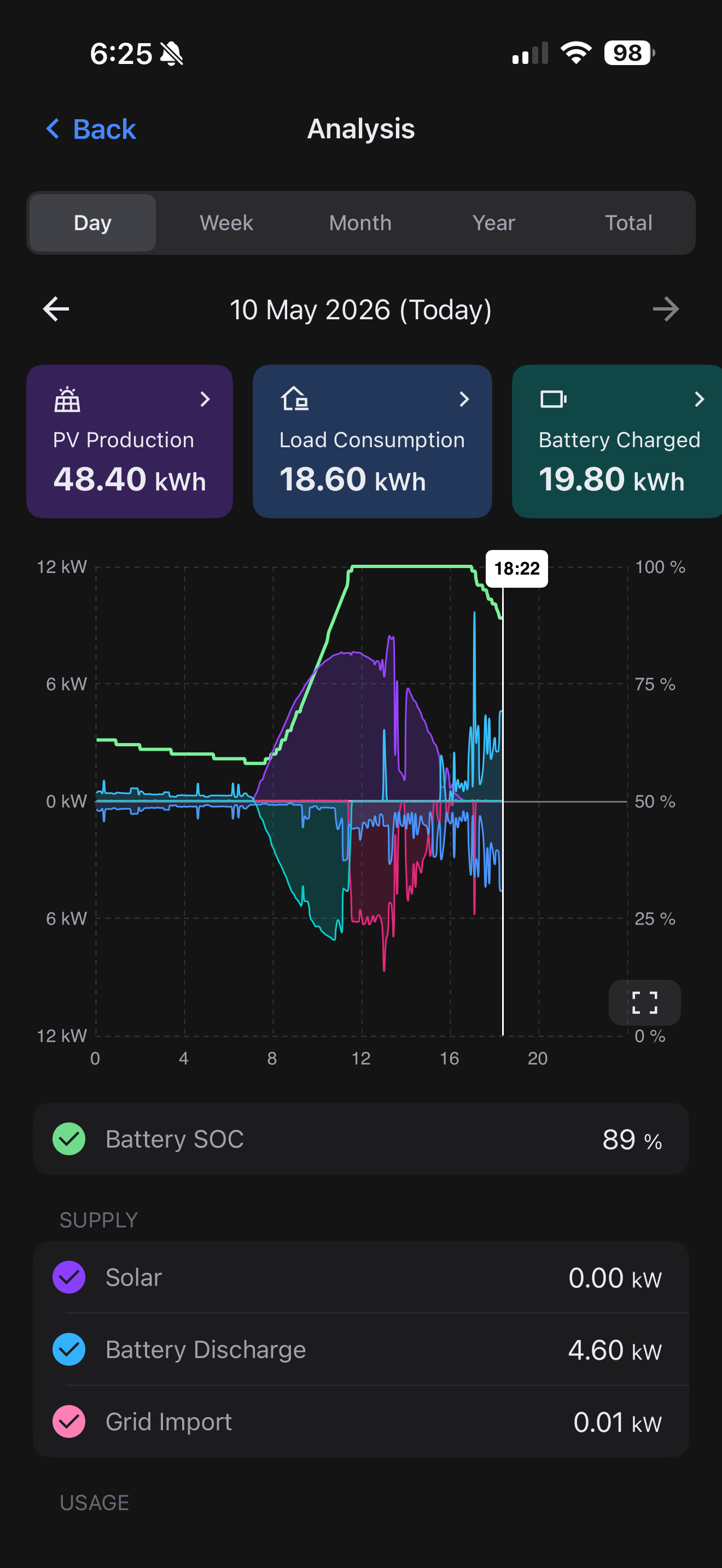

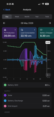

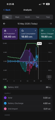

It's not normal, but can you post some images from the app to show the power flow (first screen in app), then click daily production and select the previous full day and screen shot that image as well - as much info as possible to help diagnose.

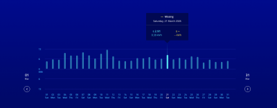

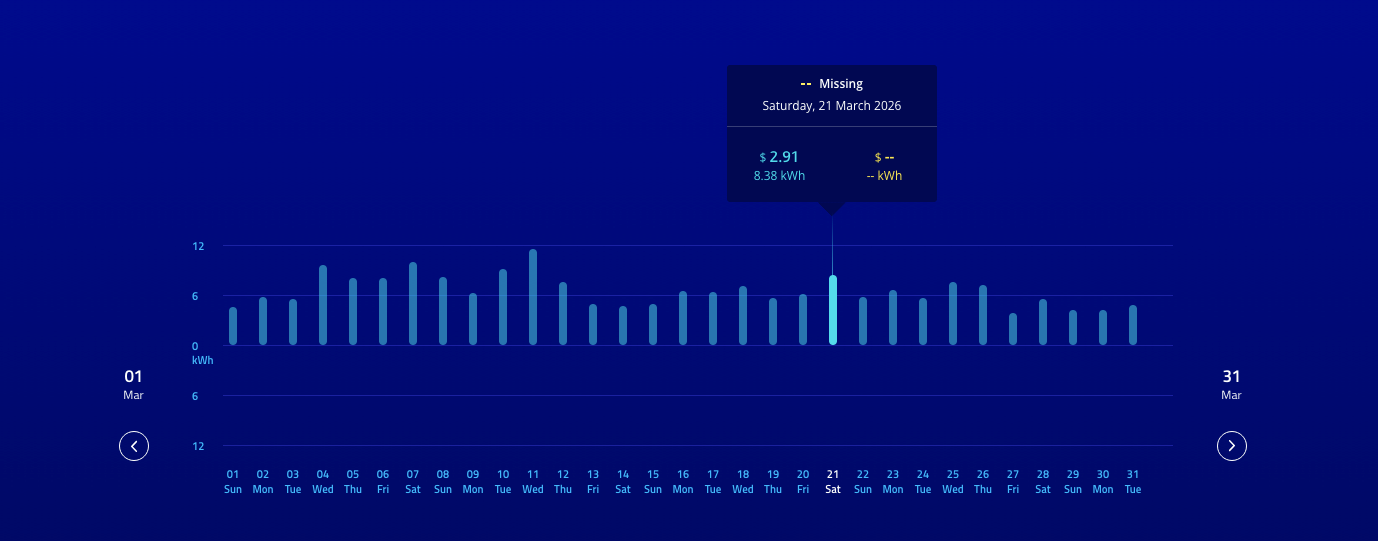

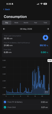

For reference, this is my usage on March 26 before I installed solar. My average daily usage has been less than 8 kWh.

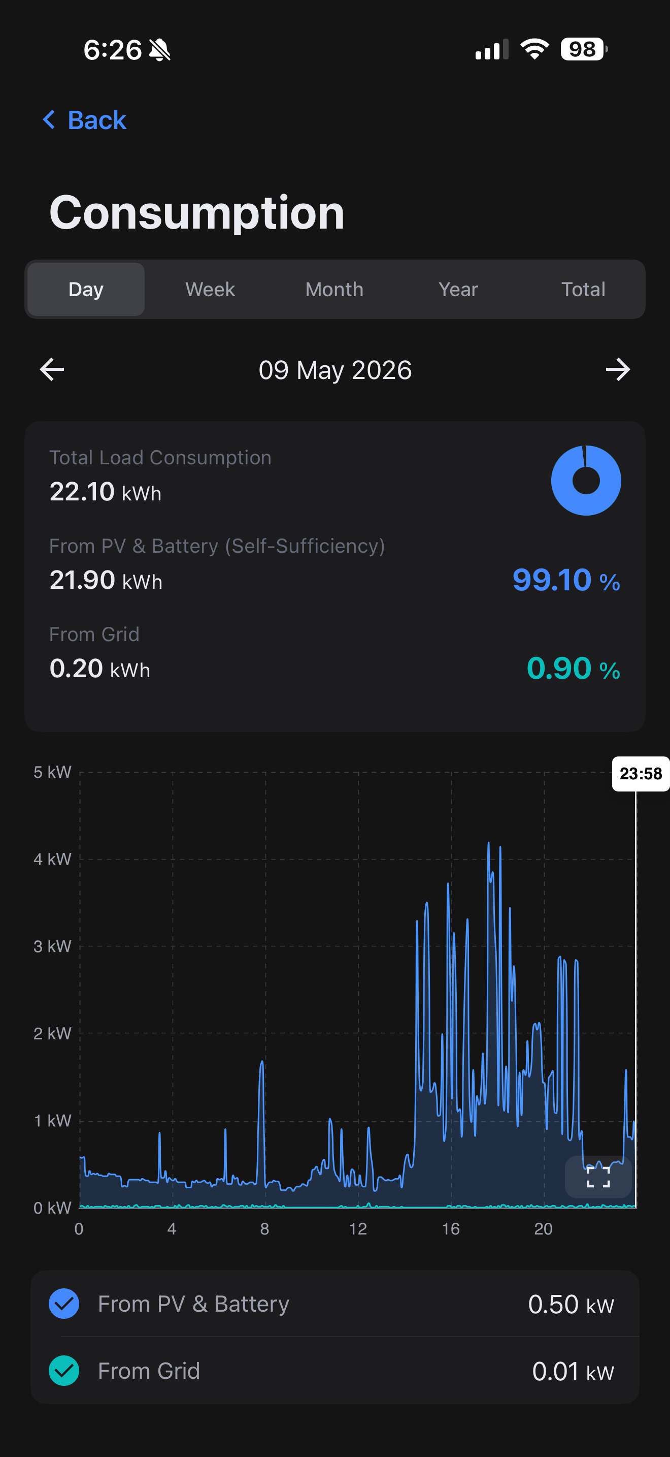

If you forget the magnitude of the load for the moment, the graphs appear to show the system running normally, obviously VPP controlled and looking like the battery is charging normally from PV and being used to export later in the evening.
You are exporting a lot of power to the grid and your import looks low.
So all of that said, there is nothing fundamentally wrong in the operation of the system, and power flow directions are correct - but the load consumption is high.
The graphs are showing high load consumption, typically low (average ~500 watts/h) until 2pm and then it goes high until about 10pm (average 1.5kw/h) with lots of peaks to 3 or 4 kwh.
Is there anything in the house that could be taking such large amounts of power, water heaters / AC etc..
It is possible that the CT clamp is not correct i.e. the CT clamp is the wrong ratio (it should say 100A/33.3mA on it) - or if a meter has been used the ratio has been set incorrectly (possibly it is clamped to the wrong cable or being influenced by another magnetic device in close proximity).
If you have ruled out any possibility of using that much load, I would suggest getting your installer back to check the metering configuration.
