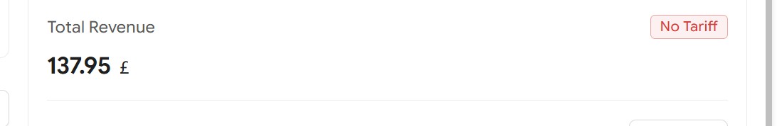

another question.... on the dashboard, although I see a total revenue generated amount it says no tariff.....

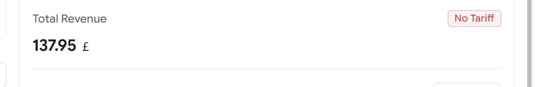

and I cant see anywhere to amend it apart from in here settings
Screenshot 2026-05-02 094947.jpg (10.61 KiB) Viewed 14843 times
is this correct?... I am on Octopus @12p / kWh

I have mine set at 0 :D so that it doesn't show to me some random value for Total Revenue that is bogus.

thanks...now sorted
@MaterialBarracuda48: ...... deleting the existing tariff did in fact clear out all the entries as desired :D
