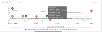

Just getting used to the system, AC1-5.0-E and two ECS4800 batteries. Current Klimt's at 35Amps default setting. When using a lot of power in the evening do cooking etc, the battery output gets clamped at 35A meaning we draw another 2kW from the grid for a period. Is this normal use or can the battery limit to up? Understand a trade between battery life and current consumption.

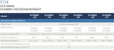

I don't think the AC-1 can go much higher, the datasheet says 40A as a maximum.
The battery datasheet recommends a maximum current output of 25A so you're already over that.

I just checked the sheet and it recommends 25A, but says max 50A.
Suspect durability done by fox is probably at the recommended, going higher reduces cycles/battery life.
Posts: 392
The more batteries you have, the higher the voltage and the less load on each pack. As you have "only" two modules, 50A would be very hard on them. If you can afford to thrown some money at the problem then adding more battery modules will enable you to increase the current without being too hard on the battery bank.
