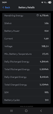

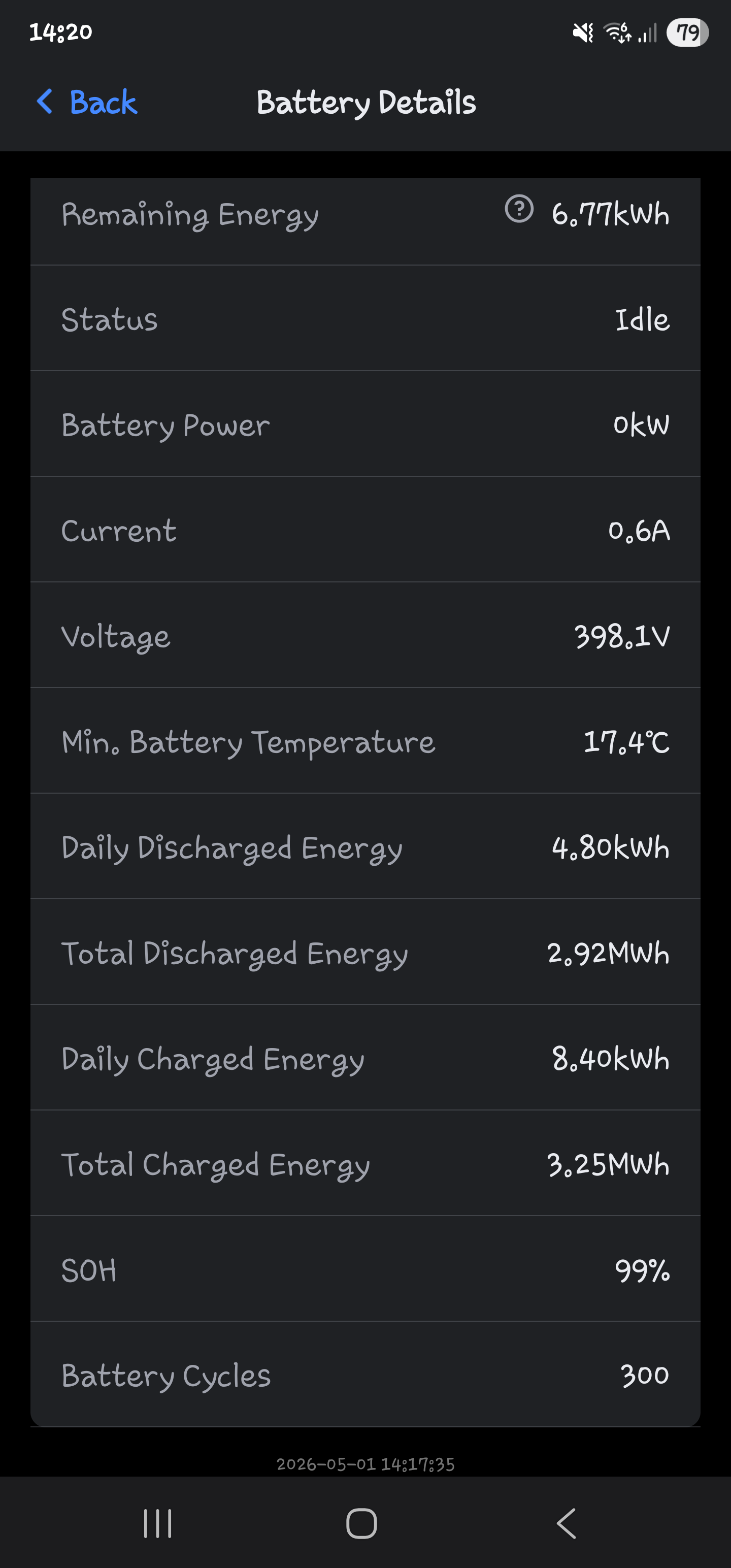

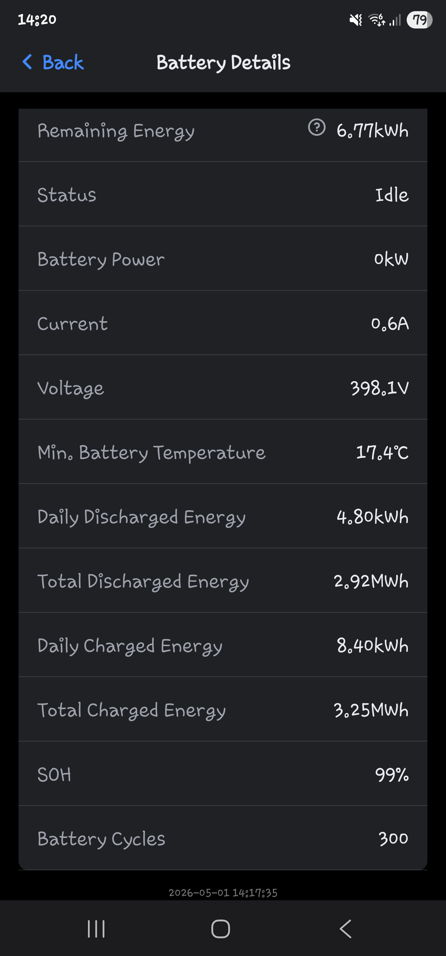

Information update:MaterialBarracuda48 wrote: ↑Tue Mar 03, 2026 12:55 pm I have had my EP11 for a year now, and still reports 100% SoH (State of Health)
My min SoC is 10% and max 100%, it will sit at 100% for a few hours each night, until discharge is allowed from 05:30.
All I do is allow it to discharge during the daytime to feed my house usage, and it does not charge up until 23:30 (though I get a few random charges from IOG slots, but they aren't often)
Once a month, I will discharge it all the way down to 10% so that the BMS can keep calibrated and know the end points of the cell Voltages.
That works for me, others will chime in give their opinions shortly.
I have finally reached SoH of 99% after 300 cycles and approx 14 months.
