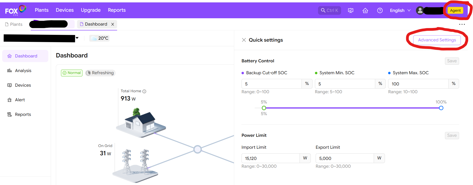

From the Dashboard, go to Quick Settings on the top right. Then go to Advanced Settings again on the top right.
The basic schedule settings are in ChargingTime option.

Not seeing what you are here?brunofabre wrote: ↑Thu Apr 23, 2026 11:03 pm You can still use the basic scheduler from the v2 website.
Can you take a screenshot/video of what you are seeing?
I don't use the website, so may have missed something
Just realized it is because I have registered as an Agent which gives me installer level access.

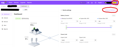

Here is the screenshot from the Dashboard after click on Quick Settings. When I login as an End User I don't see the Advanced Settings button.
Aha!brunofabre wrote: ↑Fri Apr 24, 2026 10:19 am Just realized it is because I have registered as an Agent which gives me installer level access.
Well thanks for confirming, I thought I needed new glasses
At least we know the options exist, for Agent level accounts, so cheers for posting back.
That was for the v2 website. The v1 website can set the basic scheduler as an end user.
